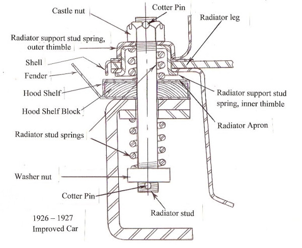

Here is a drawing I in made in 2012 in answer to the order of assembly. John is correct. The wood block under your shelf is way too thick! If you were to install it that way, the louvered hood sides would not fit at all properly and could not be secured by the hood latches. The wood blocks should be exactly the same thickness as the inside height of the metal shelf. The shelf should sit on top of the wood blocks without the wood being visible, while still providing support to the metal shelf without the shelf making contact with the underlying steel fender. If the old wood blocks were that thick, they were wrong too. Even with the correct block thickness, I had to hammer a temporary 1” thick wooden wedge under the threaded stud to keep it as high as possible in order to expose enough thread above the assembly to install the small spring, lower and upper thimbles and top nut. The lower “washer nut” should be threaded as close as possible to the to the lower cotter key to provide as much thread above the assembly, as possible. Of course, the wood wedge must be removed after the assembly has been completed. Jim Patrick

And you KNOW that the old wood was original? The diagram Jim provided doesnt show a bunch of wood block gap.
Ill look @ my T tonight to confirm.

The wood block does look too thick. They need to be just a bee's bum thicker than the edge of the shelf, so the shelf doesn't contact the fender and grind the paint off. It may help your installation if you make a wooden pad to sit on top of the hood shelf so you can use a G clamp to put pressure on the fender lip. It needs to lie flat on the frame/wood block. A clamp will drag everything down to the frame.

Good on ya Allan. The wood block should be just thick enough to prevent the metal shelf from coming in contact with the underlying fender. If done right, the wood block will not be visible from above, but may be visible if closely looked at from the side. Jim Patrick

I think your main problem is the repo radiator apron. You may be able to improve the fit by elongating the holes for the radiator studs which may allow it to move forward enough to get the front face to lay flat. The hood block height will not affect the fit of the radiator apron front, only the height of the apron. If the apron bolt hole lines up with the hole in the engine mount you are fine. Although I agree with the others regarding the height of your hood shelf blocks.
Getting the radiator stud, springs, thimbles, radiator, radiator shell, nuts and cotter pins to all go together is easier than it looks. You need to drive a wedge between the bottom of the stud and the frame to raise the stud up, to overcome the force of the lower stud spring. A cold chisel works great. Once it all goes together and the nuts tightened, the lower spring will be compressed and the chisel will fall out.
