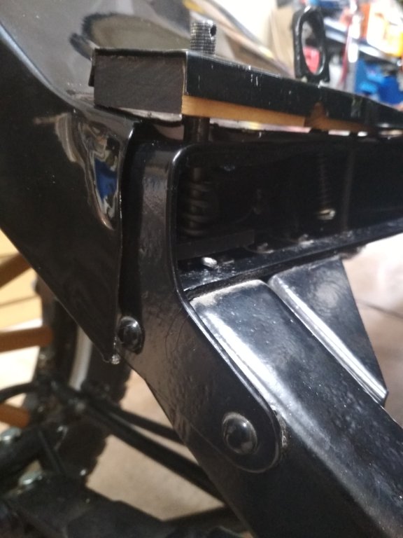

I have installed the repaired and repainted front fenders, new hood shelf wood and trying to fit the repo radiator apron but no cigar yet. The front of the fenders where they bend over the front of the frame extend behind the apron and won't let it come back to meet the front engine mount. The original apron was welded to the radiator shell and doesn't provide much of an example of what things should look like. I've looked at dozens of pictures but there is not enough detail to really see how this should fit together. I assume it is correct that the front fenders extend behind the radiator apron - that's what is really pushing the apron forward.
The front fenders are not flat along the frame and do not allow the hood shelves to come down flat onto the frame (I can see light underneath). Maybe this is causing all the problems. I think they sat flat before painting but I am not sure. I hope the attached pictures might identify where the problem lies. I would really appreciate any help with this matter.
Another issue is the repo radiator mounting stud (3.5" long) free length. They only protrude 11/16" above the hood shelf, not much to thread the castellated nuts onto. The 4 springs measure about 0.9" in length and are extremely stiff.The front fenders are not flat along the frame and do not allow the hood shelves to come down flat onto the frame (I can see light underneath). Maybe this is causing all the problems. I think they sat flat before painting but I am not sure. I hope the attached pictures might identify where the problem lies. I would really appreciate any help with this matter.

One problem(of several?) might be the hood shelf blocks look way too thick.

The hood shelf wood is the same thickness as the old pieces BUT the old wood was bent a bit and conformed better to the frame.

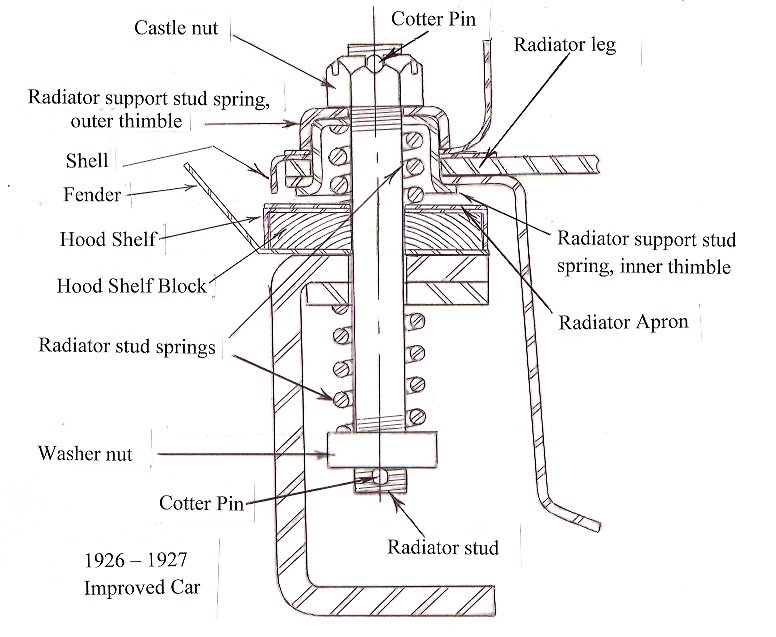

Here is a drawing I in made in 2012 in answer to the order of assembly. John is correct. The wood block under your shelf is way too thick! If you were to install it that way, the louvered hood sides would not fit at all properly and could not be secured by the hood latches. The wood blocks should be exactly the same thickness as the inside height of the metal shelf. The shelf should sit on top of the wood blocks without the wood being visible, while still providing support to the metal shelf without the shelf making contact with the underlying steel fender. If the old wood blocks were that thick, they were wrong too. Even with the correct block thickness, I had to hammer a temporary 1” thick wooden wedge under the threaded stud to keep it as high as possible in order to expose enough thread above the assembly to install the small spring, lower and upper thimbles and top nut. The lower “washer nut” should be threaded as close as possible to the to the lower cotter key to provide as much thread above the assembly, as possible. Of course, the wood wedge must be removed after the assembly has been completed. Jim Patrick

And you KNOW that the old wood was original? The diagram Jim provided doesnt show a bunch of wood block gap.

The wood block does look too thick. They need to be just a bee's bum thicker than the edge of the shelf, so the shelf doesn't contact the fender and grind the paint off. It may help your installation if you make a wooden pad to sit on top of the hood shelf so you can use a G clamp to put pressure on the fender lip. It needs to lie flat on the frame/wood block. A clamp will drag everything down to the frame.

Good on ya Allan. The wood block should be just thick enough to prevent the metal shelf from coming in contact with the underlying fender. If done right, the wood block will not be visible from above, but may be visible if closely looked at from the side. Jim Patrick

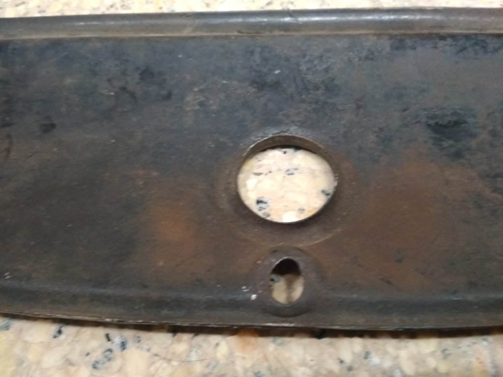

Your radiator apron is missing the round sheet metal sleeve that is spot welded to all the originals I've seen. I agree on the thickness of the wood too.

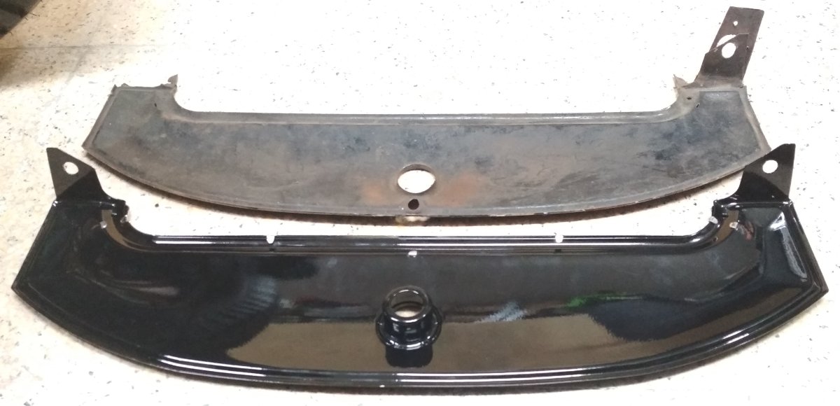

Thanks for everyone's input. After pulling a car apart and doing a ground up restoration there are so many things to deal with that I never saw years ago when I just got in and drove it!
I doubt that the old hood riser wood was factory (it's plywood), but the hood fit just fine with those pieces and they're as thick as the new ones. They conform to the frame though, kind of like steam bent wood effect. I think that by having all the screws tight on the hood riser it is making the front angle upwards, so I'm going to loosen the whole thing and see if the front will come down some for mounting the radiator, then with time the new wood will end up conforming to the frame like the old pieces did.
Here's the old piece laying on the fender: Raising the radiator mounting stud against the spring pressure with a cold chisel is very useful information indeed. I will definitely do that!
The radiator apron does have the thimble welded to it, but it's not very visible in the picture I posted. The original had it's screw hole but didn't have a thimble: Pat McNallen, when you say "...the apron fits in between the turned-down leading edge on the lower front of the fender, but rubs slightly.", do you mean that the turned down leading edge does not extend behind the radiator apron and only comes up next to it? My fenders extend under the apron about a 1/4". They don't look to be modified but if they stopped just short of reaching the radiator apron, the apron would fit perfectly.
You can see the mark the old apron left on the fender: Thanks very much for all your comments. They're very helpful!

Oh, and to Jim Patrick. I printed your drawing years ago and have referred to it more times than you can imagen. Kudos for that rendering. It's a real life saver!

I’m glad it helped, Eric. Believe it or not, it helped me too when my memory grew fuzzy. LOL! Jim Patrick

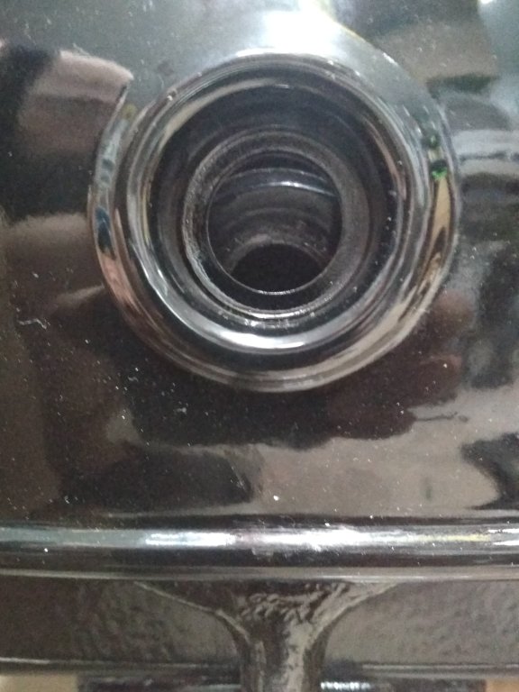

Ok, here's what I have found. The hood riser height looks to be fine with the radiator mounted in place.
The only problem seems to be the radiator apron which sits too high in relation to the crank hole in the front motor mount. With the old apron in place, the hand crank is low in the hole and incidentally, I remember it always being this way. This apron has the slots for the bright trim piece but does not have any thimble, so it doesn't cause any problems for the hand crank. So the only thing that occurs to me is that the front cross member must be too low, thus lowering the front engine support and crank handle. The crank sits a bit too low with the old apron but with the repo apron the crank hole is 5mm higher than the old one and that makes it impossible to fit the crank through.
I have measured the distance from the top of the front cross member to the top of the frame using a rudimentary string and tape measure and came up with 131mm ((5.157 inches). Does someone have a good 27 frame they could take a measurement from and confirm if mine is off?

Thanks very much for the measurements John! I think I can safely say (famous last words) that my frame is within spec or at least not horribly off.
As far as the repo apron goes, it's just too high for the crank to go through the hole, so I made my own adjustment based on some of the suggestions I have received here. First I opened the mounting holes to make a forked mount. Then I straightened the mounting tabs and rebent them to lower the apron. I came down 10mm but could have used closer to 13mm or so, but at least the crank goes through the hole now.
I'll post pics tomorrow.

The bend in the tabs of your repo apron are not in the correct location, thus keeping your repo apron to high. From your last post it sounds like you were able to re-bend the tabs and lower the apron to fit the crank hole better. Congratulations on getting things to fit including the questionable fitting repo radiator apron.

Ok, here's how it turned out:
The best quality radiator apron is too high to put the crank through... so I opened the mounting tab holes... I straightened the mounting tabs in a bench vise then rebent them 10mm further up, so the tips of the mounting tabs just reach the radiator springs. I also put a thin washer under the springs to make sure it contacts the mounting tabs and holds them in place. And here is the current position, still a little high but the crank goes through so that's what matters. I will have to ad the hole for the screw now. Thanks for everone's tips and suggestions!
