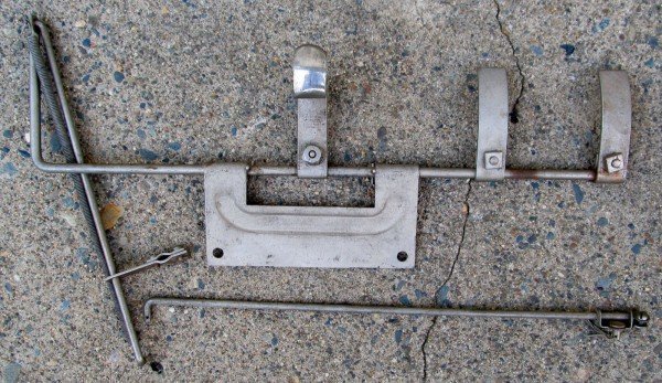

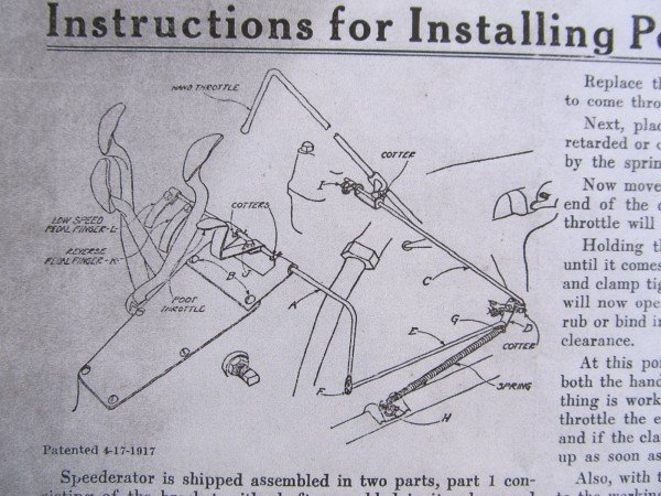

There were accessory kits available from the suppliers years back, besides back when.
Gas Pedal.jpg (88.81 KiB) Viewed 1215 times
Gas Pedal instructions 2.jpg (78.57 KiB) Viewed 1215 times
More ideas
this uses the Vaporizer to Holley carb linkage as part of the design
Using the Vaporizer Throtlle Linkage requires that you also need to have the Conversion linkage for the Vaporizer to Holley NH kit
https://www.mtfca.com/discus/messages/1 ... 1276459118
https://www.mtfca.com/discus/messages/8 ... 1245269322
Link to this option https://www.mtfca.com/discus/messages/1 ... 1299819284
the peddle part is still sold by some suppliers https://www.macsautoparts.com/1928-31-f ... 939-1.html
https://www.mtfca.com/discus/messages/2 ... 29461.html
The Model A (1928-29) design can also work - put not there parts.
