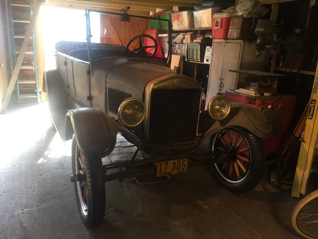

Here she is with her newly restored wheels. The rear wheels' spokes were so loose, that I replaced them with a pair of front wheels I bought from Denny Behning out of Indiana. I pressed out the old front hubs and replaced them with my rear hubs. I also stripped and applied spar urethane to all spokes, and painted the hubs and felloes black. I repainted the split rims silver, and put new tires and tubes on the front. I also cleaned and repacked all bearings, and replaced the leaky oil seals in the rear. This week, I replaced the rear shackles, and I've been replacing what seems to be dozens of missing cotter pins. I've also replaced missing oilers.
