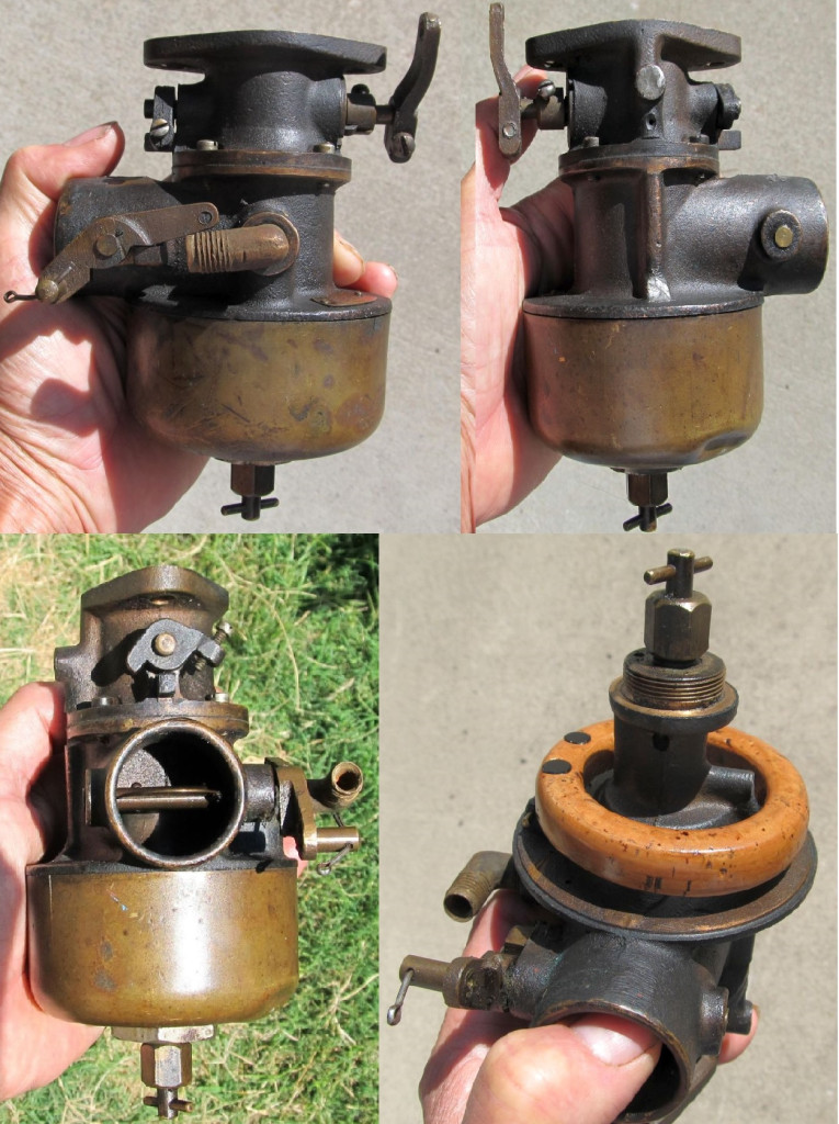

Carburetor: "U&J"
Carburetor: "U&J"
"Those are great carbs and not too hard to rebuild with a different bowl. Instead of trying to make a bowl fit the slightly larger flange on the U & J I machine the U & J to fit a slightly smaller bowl. Also have to machine the lower fitting a bit to make it work. The manifolds are hard to find but not impossible. You can also use one of the other similar manifolds but most of the ones I find have the flange the other way. Have to make an adapter." " they run fine." (Stan Howe)
Photo by Jay Buscio, Sacramento. From Jays' post in the old forum: ACCESSORY OF THE DAY - 07/14/13
