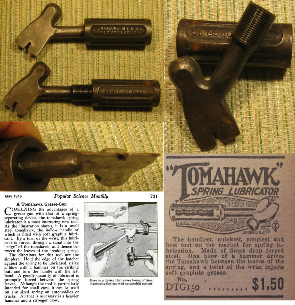

Here's an accessory tool for greasing your leaf springs. You need to lift the cars weight off the springs then tap the tool between the spring leafs and twist the handle to push the graphite grease through the wedge to coat the leafs.
Photo by Jay Buscio, Sacramento. From Jays' post in the old forum: ACCESSORY OF THE DAY - 01/23/10
