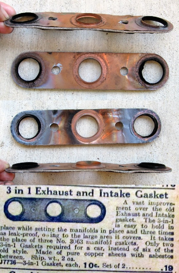

I picked these up years ago with an old collection I purchased and decided to try them out. They leaked like a sieve so I nixed them and went back to the stock rings and gland setup. The glands in these do NOTHING to hold the manifolds in position as the original glands do. These things will allow your exhaust manifold to flex and warp.......not a good thing! Ole Henry would call these "Spurious"
Photo by Jay Buscio, Sacramento. From Jays' post in the old forum: ACCESSORY OF THE DAY - 07/05/13
