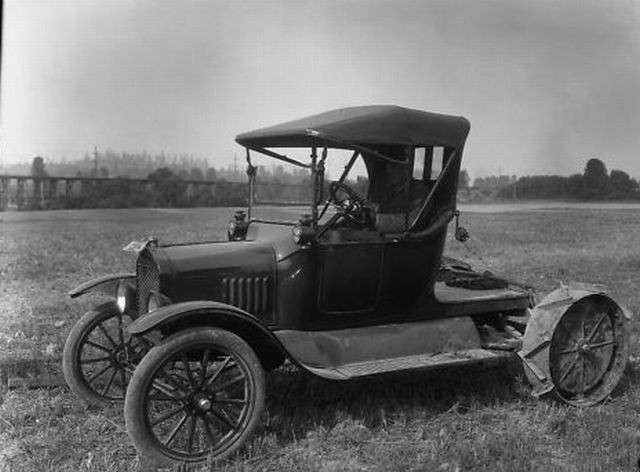

Still another "Pullford" type tractor kit on a late '17 to '22 runabout. The different style wheels suggest this one may be from one of the other conversion kit manufacturers. However, that I do not know. I hope one of the hobbyists with more knowledge about the various kits will chime in here.

This is an "American Ford-A-Tractor", later the name was shortened to just "Ford-A-Tractor", manufactured in Minneapolis by the American Farm Machinery Company. This tractor attachment had a pinion and bull gear which was common with tractor attachments but in this case the bull gear was cast into the wheel center with a cover on the inside to keep dirt out.
