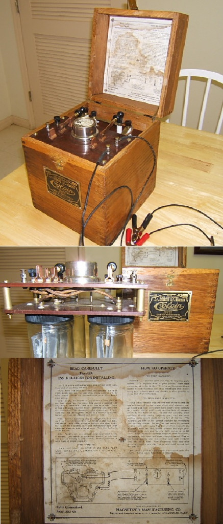

Colpin Model 26, Type GX Magneto Recharger for "Ford and Forson". It has 4 glass jars underneath with electrodes in each. The directions on the inside of the lid call for:
1. Lift entire unit out of case and remove chemicals, fuse and all packing material.
2. Hold Unit with left hand and unscrew jars. Set unit to one side, being careful not to bend plates. Under no circumstances must they touch each other.
3. Empty 1/4 of the chemical in top each of the four glass jars (to make this device a success, use only Colpin Chemicals). Fill glass jars to within one inch of top with pure distilled water (battery acid will ruin the electrodes). Stir thoroughly with a clean stick...etc.
4. Connect attaching plug to light Socket (D.C.). Now connect the test clips together (-) negative and (+) positive wires. Now close the charge switch...etc. (Jim Patrick)
