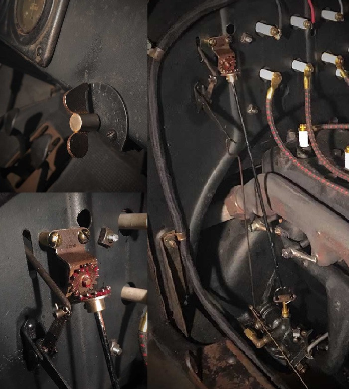

So, I got a nice accessory Imperial Carburetor Control. The adjusting knob with indicator clamps to the dashboard [no drilling] and has a rod that goes through the firewall into a geared fitting on the other side. The regular adjusting rod is cut down a little and is attached to the bottom gear. I did have to drill two small holes in the fire wall to install the gear assembly. It came with a small block of wood as a spacer, but I used two brass coil box spacers as they used less room. Works great .. would be a great accessory to offer today. (Mark Osterman)
