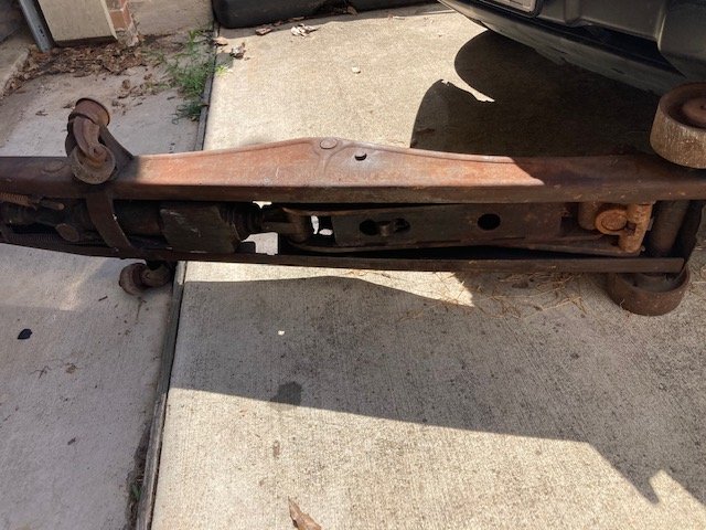

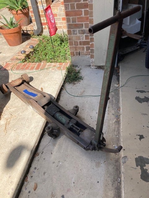

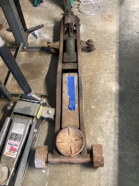

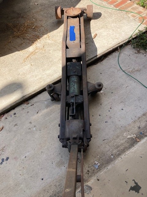

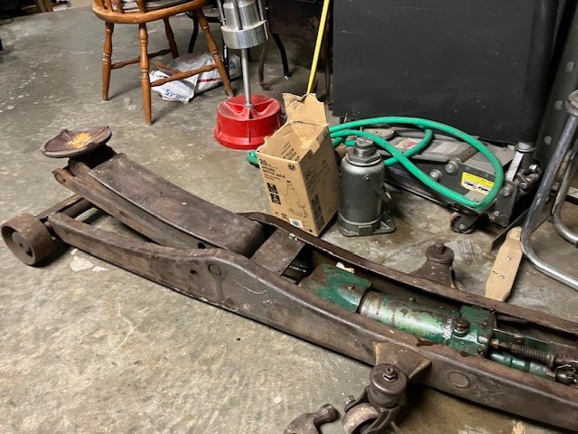

I bought this long antique I think floor jack at an estate sale. I can't seem to make it work. I don't know how to make it work. It does not have any brand or markings on it that I can see. What is it? How can I make it work?

It looks like most others I've seen and I have three myself. It operates by hydraulic cylinder that needs to be opened to let it drop and closed to make it rise. As long as it has fluid in the cylinder you should close a small valve and by pumping the handle it should engage the hydraulic cylinder and operate. When you want to let it down you open the valve and it releases the pressure. Yours may pump up using the peddle by the handle or that may open and close the valve.

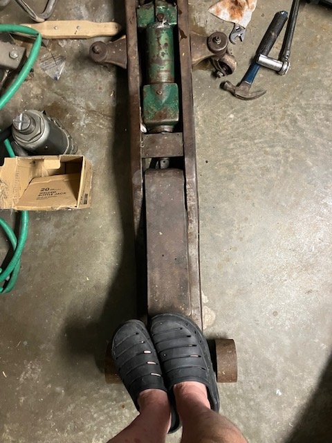

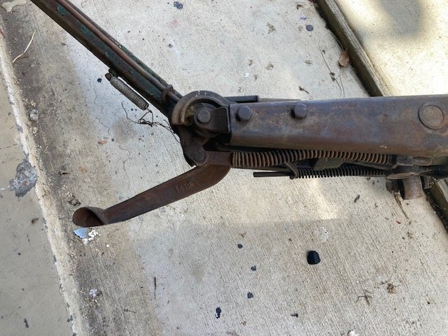

Thanks, the pedal makes the lift go up a little but then it sinks back down. The large handle seems to only be for moving it around. There is a lever on the side of the handle in picture 3 that actuates something near the pedal. The lift sinks back down no matter what position the lever on the side of the handle is in.

It seems to strongly resemble a 1930's Weaver Lo-Hi, however, so far I cannot find any marking or identifier on it.

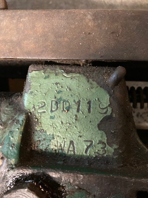

Positive ID under the greasy crud it is a Weaver WA-73 four ton and it looks like rebuild kits are available.

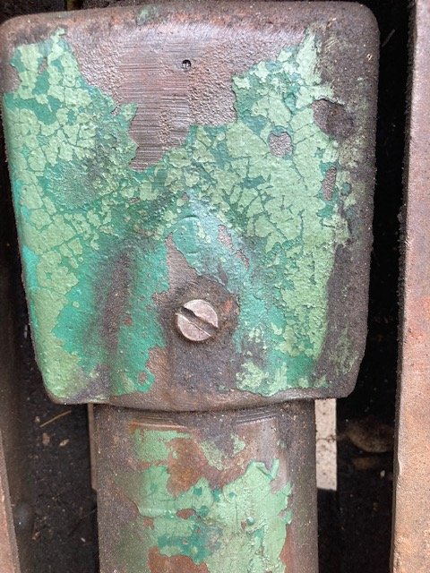

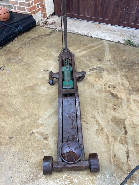

It looks like it has 2 layers of green paint where there is paint. The original paint color code is still unknown. I kerosened it and pressured washed it clean.

I bought the Lazzars rebuild set. I've started disassembly. The ram comes out as a unit. I took it to the auto paint store to get the paint color matched.

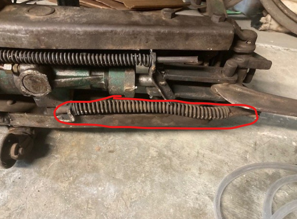

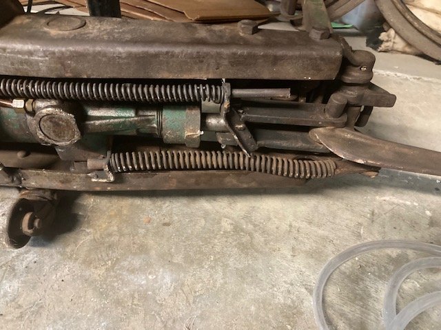

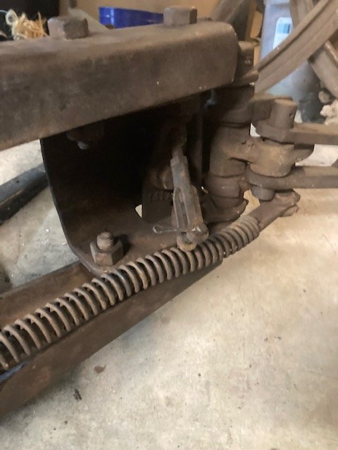

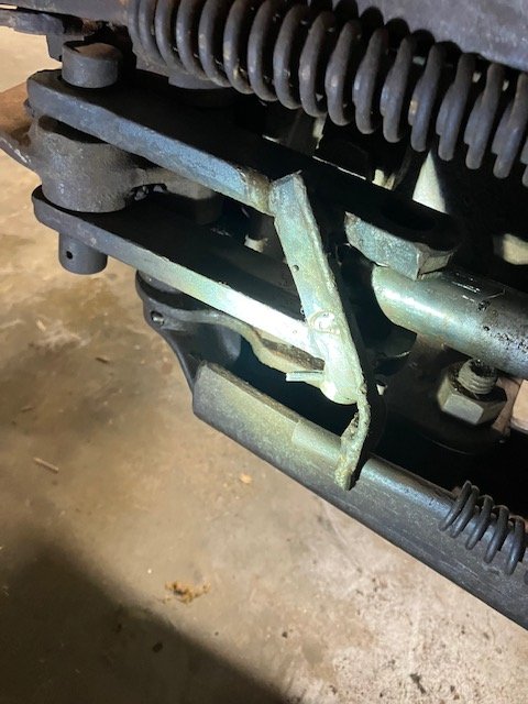

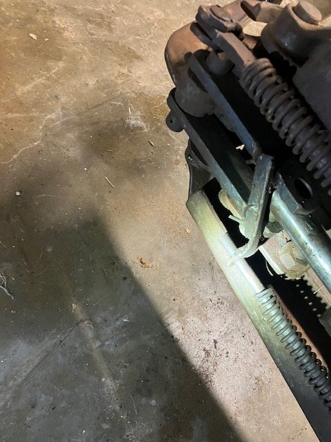

Does anyone know by what mechanism of how the pumping pedal of this is supposed to recoil back up after pumping with your foot? I've reviewed many pictures and diagrams but do not see how it goes. A previous owner rigged a lousy spring with wire but that does not seem to be how these are. I don't see any springs currently as to how the pedal is supposed to recoil. Any advice is welcome.
Posts: 4515
Location: Michigan
Re: Weaver Antique Floor Jack what is it, repair it?
Post by Jerry VanOoteghem » Thu Mar 07, 2024 8:35 am
ivaldes1 wrote:
Thu Mar 07, 2024 12:40 am
I'd be willing to bet that this is your pedal return spring...
The spring shown above this one seems to be supported by an angle iron bracket, sitting at an odd angle and looking as if it's been broken? modified?
ivaldes1
Posts: 960
First Name: Ignacio
Last Name: Valdes
Location: Houston, Tx
Post by ivaldes1 » Thu Mar 07, 2024 8:42 pm
Thanks you put me on to what it might be. It is actually the other rod and spring on the other side in the picture. Attached is a parts diagram pdf. My AS-9784 rod does not seem to be original. It lacks the spring retainer near the hook end so the spring isn't long enough to recoil it. A quick shopping check for a replacement Weaver part number AS-9784 rod doesn't seem to be readily available. Perhaps I could weld a washer on at about the right location.

Post by ivaldes1 » Thu Mar 07, 2024 10:18 pm
Stainless steel hose clamp worked to retain the spring! Now on to the leaks!
