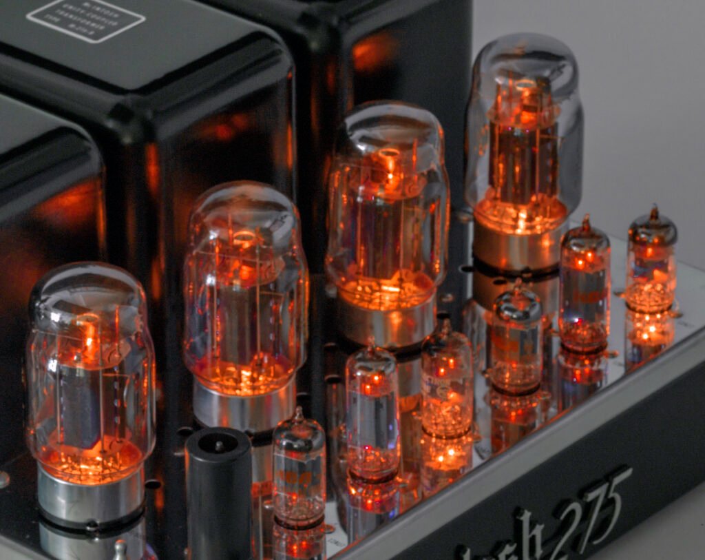

You transistor guys...
If it don't glow, it don't go! 8-)
Oh wow,foot warmers! :lol:
