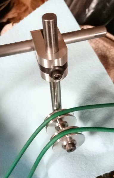

Post by Scott_Conger » Sun Jun 04, 2023 10:27 pm

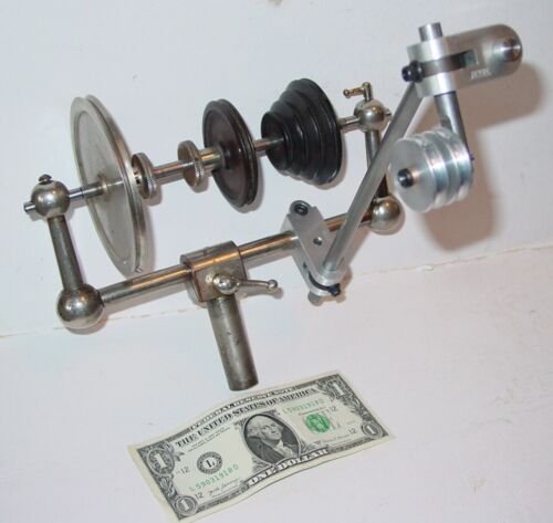

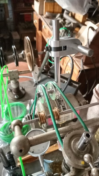

I needed another pulley arrangement for a special carb part setup and I fortuitously found these pix of a Levin setup on eBay...it was even attached to an identical jackshaft that I have. Given that, how could I not copy it??...being that they make pretty much the best equipment in the world of its type, and I cannot spare the gelt for it, I decided to make my own...I think it turned out really well after I figured out how the original was built and worked. The dollar bill the fellow included in his 2 photos provided the scale I needed. I decided on miniature ball bearings for the idler wheels instead of bronze plain bearings. Just the barest of "tweeks" on the screws socks things down very solidly...it is very cleverly designed as I'd expect from a Levin product:
s-l500 (1).jpg (28.54 KiB) Viewed 26767 times
Here's my version:

Post by speedytinc » Thu Jun 08, 2023 8:24 am
Quality work. Looks professional.

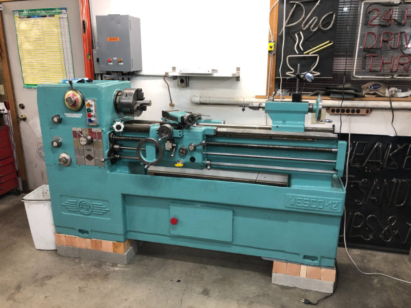

It's Italian !! :lol:
PBR - Perico Baroni & Raimondi 12" x 40" Lathe.
Made in Italy in 1966.

very nice, Bob
what I wouldn't give for a larger heavier lathe... :?

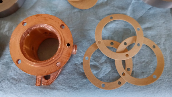

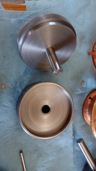

Dies making carburetor gaskets:

Beautiful work.
A friend of mine knows a guy who has made some very nice and fairly intricate gaskets using his wife's Cricket machine. My wife has one, but I'm probably not smart enough to program it to make gaskets, or much of anything else.

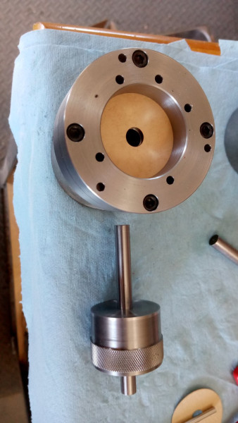

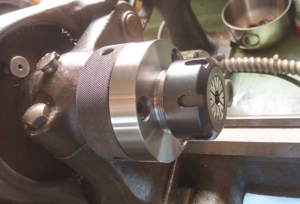

Post by Scott_Conger » Wed Jul 03, 2024 2:35 pm
Best addition to a 9" lathe, ever
I have a full compliment of collets in 1/64" increments for my lathes but due to spindle size, you're limited to 1/2". I purchased this gawky looking thing which holds ER-32 collets and I can now go up to 3/4", or the size through my spindle. It will hold stock to .0005 TIR with no adjustment or confirmation or .0002" TIR with a gentle tap on the part. I could not be more pleased.
It requires fitting, so requires you to know lathe work and is not a drop-in tool. Mine had several quirky deficiencies which I was able to work past, considering that remediation of those deficiencies was easy, and the low price of the tool made fixable shortcomings as received, all but a certainty. There was nothing that could not be remedied and when done, the thing is highly accurate and repeatable from installation to installation. While nicely ground and capable of great precision, finding the precision in the tool is up to the purchaser and his/her ability to fit it correctly to the lathe. Purchase and shipping from UK came in (as I recall) under $100 which is an absolute bargain. I highly recommend it for small lathes with threaded spindles, for anyone who is capable of very close work.

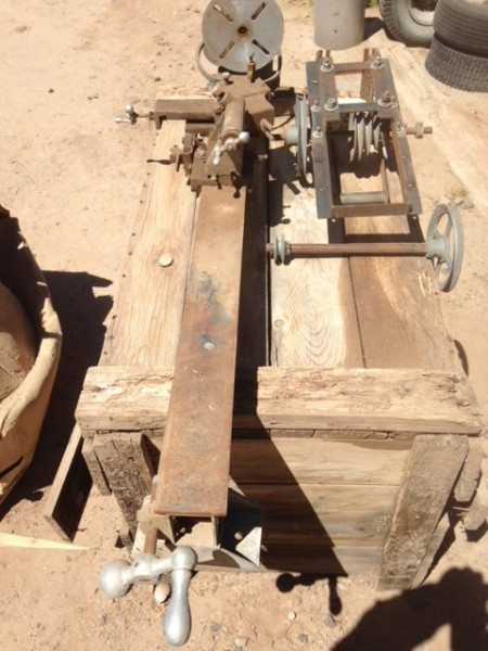

Post by Craig Leach » Wed Jul 31, 2024 11:41 pm
I noticed that homemade tools where mentioned @ one point. Anyone seen one of these it's a homemade Gingery lathe. David J. Gingery
published a series of books on homemade tools starting with a primitive forge & casting machine parts. Then making a lathe, shaper, mill
& other tools. I picked this up with the castings already done & mostly finished. Just because it's cool & I've only seen one completed. now
I have more lathes than I have room for so if anyone is interested??? I would part with it pretty cheap?
Craig.

Post by Ed Fuller » Fri Aug 02, 2024 7:56 pm
Scott,
Those carburetor tools are really neat. Are the period originals or something you made?
Craig,
I’ve read some of David Gingery’s books about making all of your own shop tools starting with casting parts and building the lathe. Then, using the lathe to create all of the other machines. That’s really neat to actually see one of the completed lathes! If I were closer I’d be seriously interested !

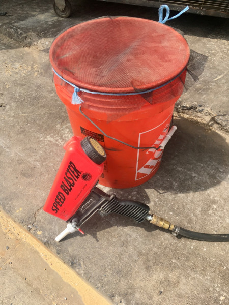

This hand held sand blaster is magical. I just finished up all my wheel felloes and I love it. About $56 new on T bay. I just screen some play sand thru some window screen into a bucket and blast away. Makes pretty good cheap media that Iam not worried about recovering.

Please be sure to wear a good respirator when sandblasting using any media, but especially silica sand. When sand is used, it will fracture into glass like shards of dust that when inhaled do permanent lung damage and can kill you. The glass particles will cut your lungs, and cannot be coughed up or removed, and continue to do damage! A dust mask isn’t enough, use a good fitting painters type mask. I wear one always when blasting regardless of the media. I usually use the black slag type but it is very aggressive.

Good advice. I use all necessary PPE. I also have two 4’ shop fans at my back to blow everything away from me. When blasting it’s also good practice to angle the media stream so it deflects away from you and not back at you.

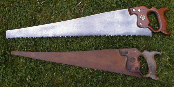

Post by A Whiteman » Mon Aug 19, 2024 4:52 pm
Well, sometimes refinishing can look good:

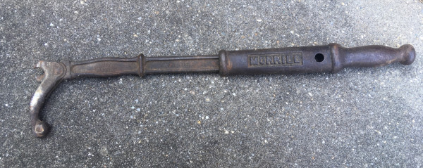

Post by Bryant » Fri Jul 11, 2025 11:14 pm
What is it?
Works like a slide hammer
My guess is for prying and pulling nails
Bryant
Craig Leach
Posts: 1906
First Name: craig
Last Name: leach
Location: Laveen Az
Re: Tool Time
Post by Craig Leach » Sat Jul 12, 2025 1:46 am
That would be correct & still made today as I understand.
Craig.
Posts: 4082
Re: Tool Time
Post by Jerry VanOoteghem » Mon Jul 14, 2025 12:15 pm
Yes, a nail puller.
If you use it, be CERTAIN that when you grip the lower portion, just above the "foot", that none of your hand laps over the small ridge above the handhold. It's one of those mistakes that nobody makes twice!
