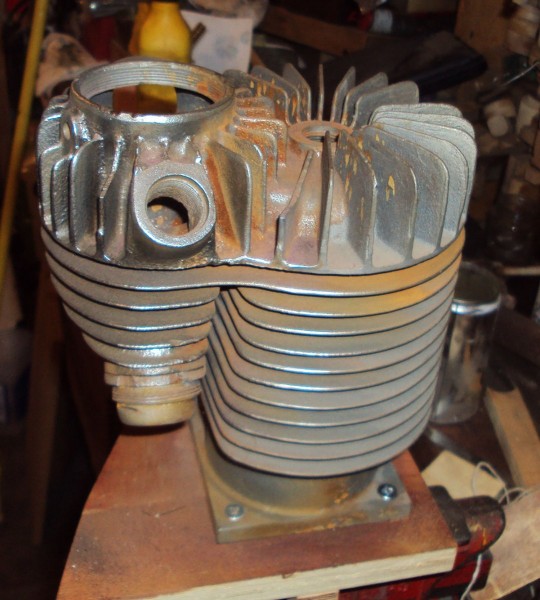

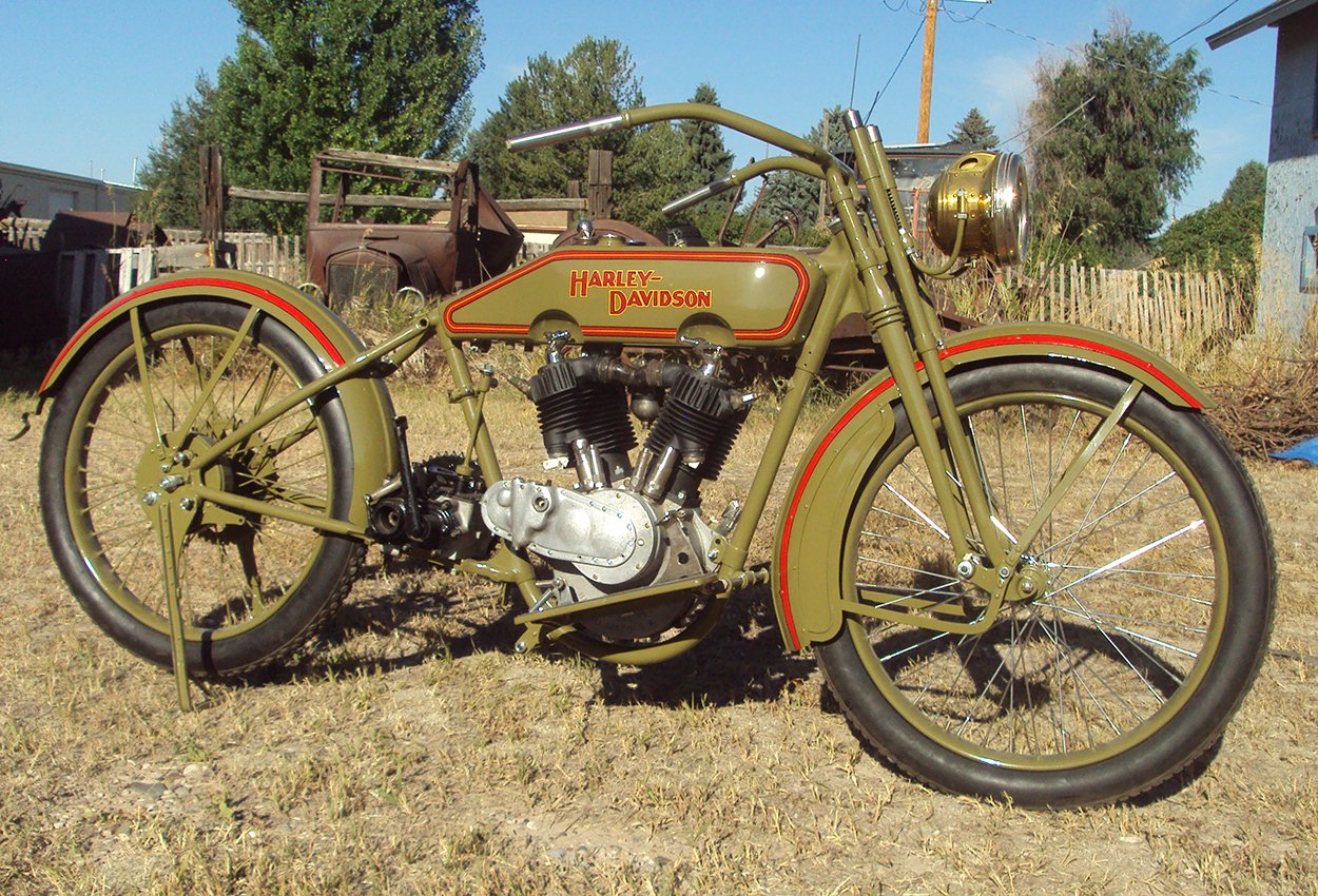

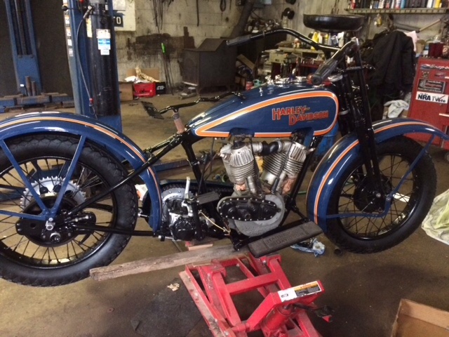

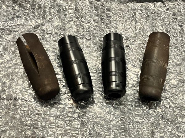

It became important for me to do something with the 1919 Harley-Davidson engine. The bike has been gaining in value and parts since the acquisition of a basket case in 1973. A total rebuild isn't an option for me at this time but I believe I can reassemble it and at least get all the parts in one place and maybe fire it up. One of the crank pin bearings is missing a roller. My temporary solution was to make a roller from a broken drill bit. Clamping a Dremel tool in the tool post worked very well. As with many things I do what I need to get projects moving. I have lost a lot of time waiting to do things the proper way.
I hope to see some other interesting OT projects on this thread.

The shank of a drill bit isn't tempered the same as the cutting end, I am not sure that a drill shank would make a good bearing. Just my thoughts.

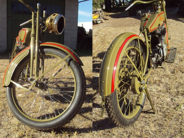

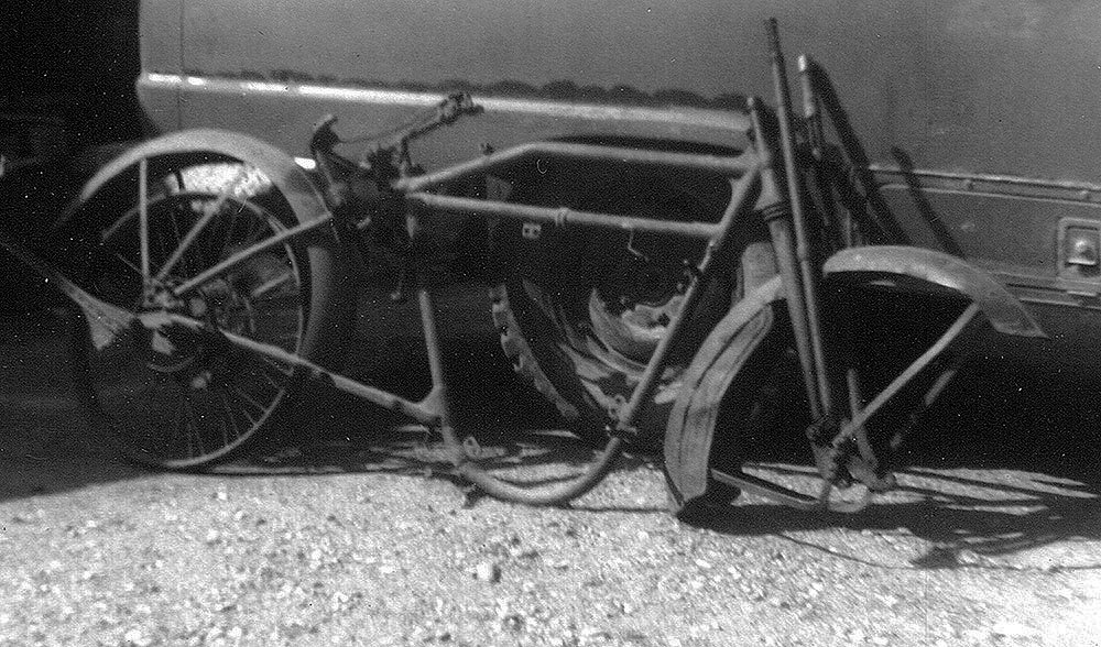

My cousin's 29 J-D 1200, hopefully this summer I will get to see it completed and ride it with the sidecar.
I got it to the state it's in shown. I disassembled everything and had powder coating done and he had the sheet metal painted somewheres else.
Engine was supposed to have been rebuilt and not started. We needed ignition parts to fire it up and he felt he could handle it from there.
Cousin Phil. Phil has a 15 touring he is thinking about putting a starter on, since his back is not great. He's getting back with me after I reminded him, "you probably don't have a ring gear" :(

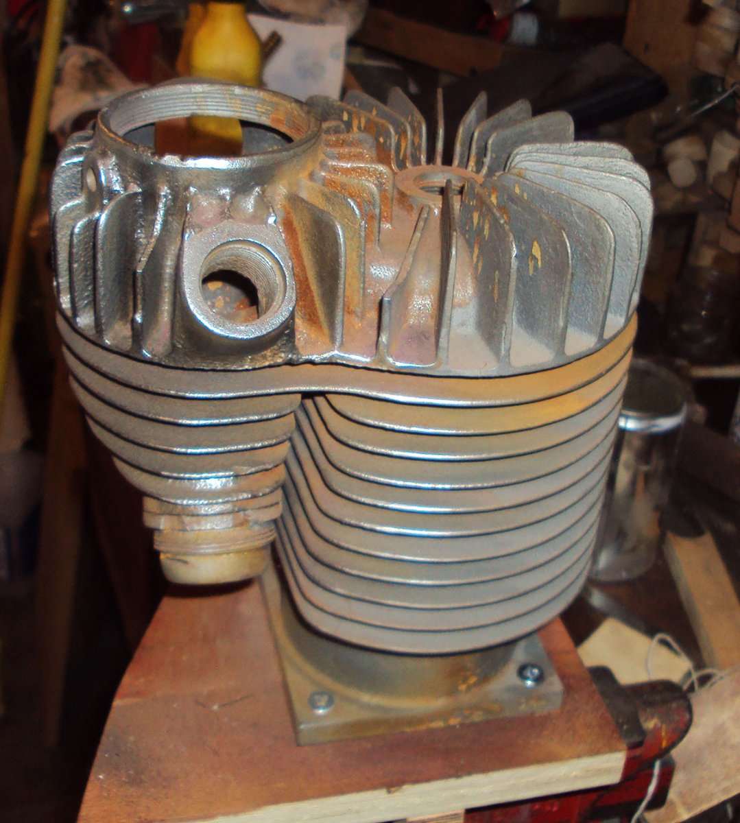

Today I am scuffing of rust from the cylinders. These were sand blasted thirty years ago. Then one winter the roof leaked. I could take them to a shop and wait. Meanwhile I would get wrapped up in another project and perhaps not get back to it. Some tedious work is good exerciser and will keep me on track. Many of my methods seem odd but that is me.

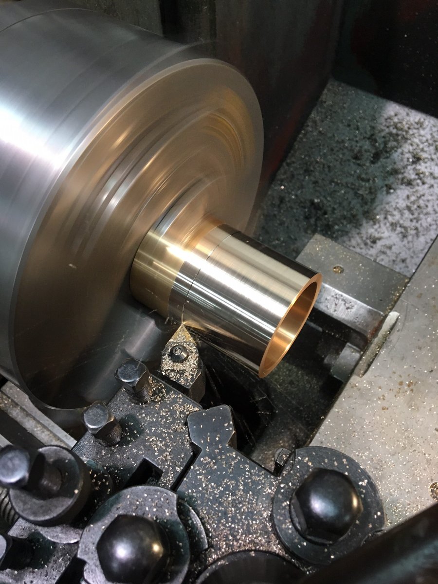

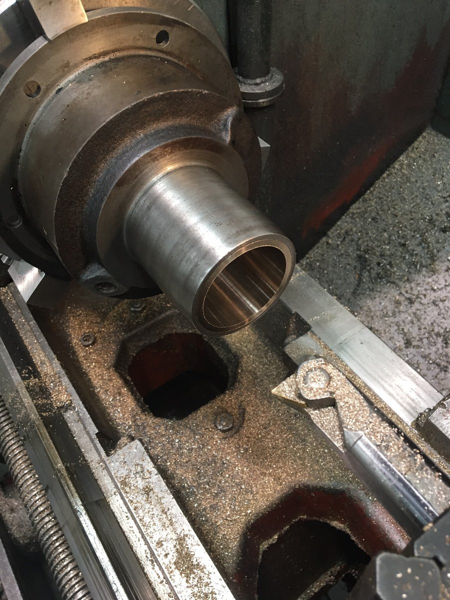

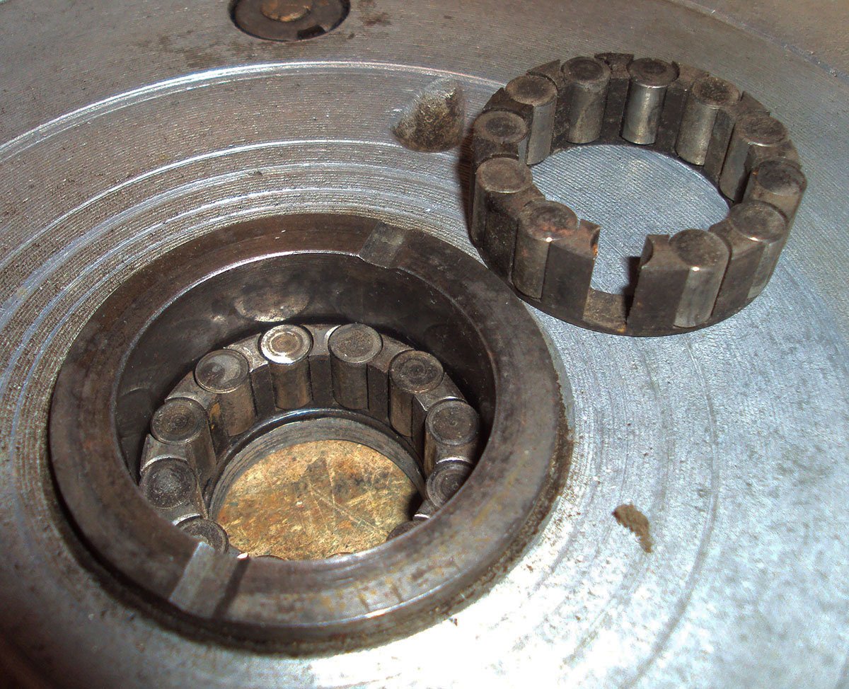

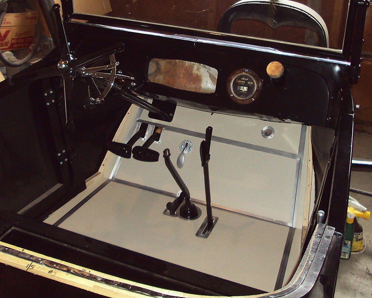

Re-bushing a Zebra clutch.
Posts: 4411
Re: What have you done on an old non-Model T vehicle.

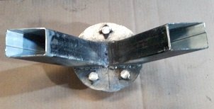

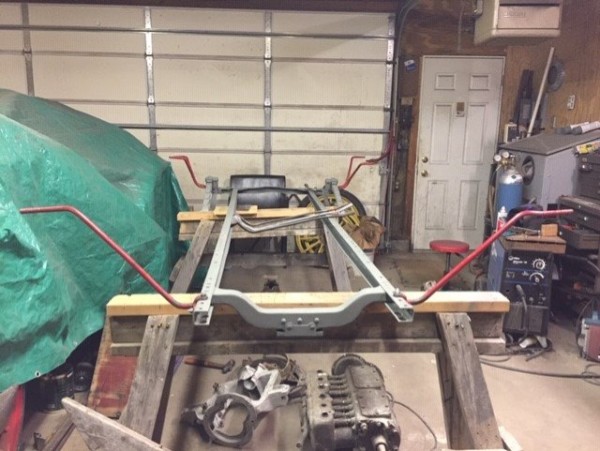

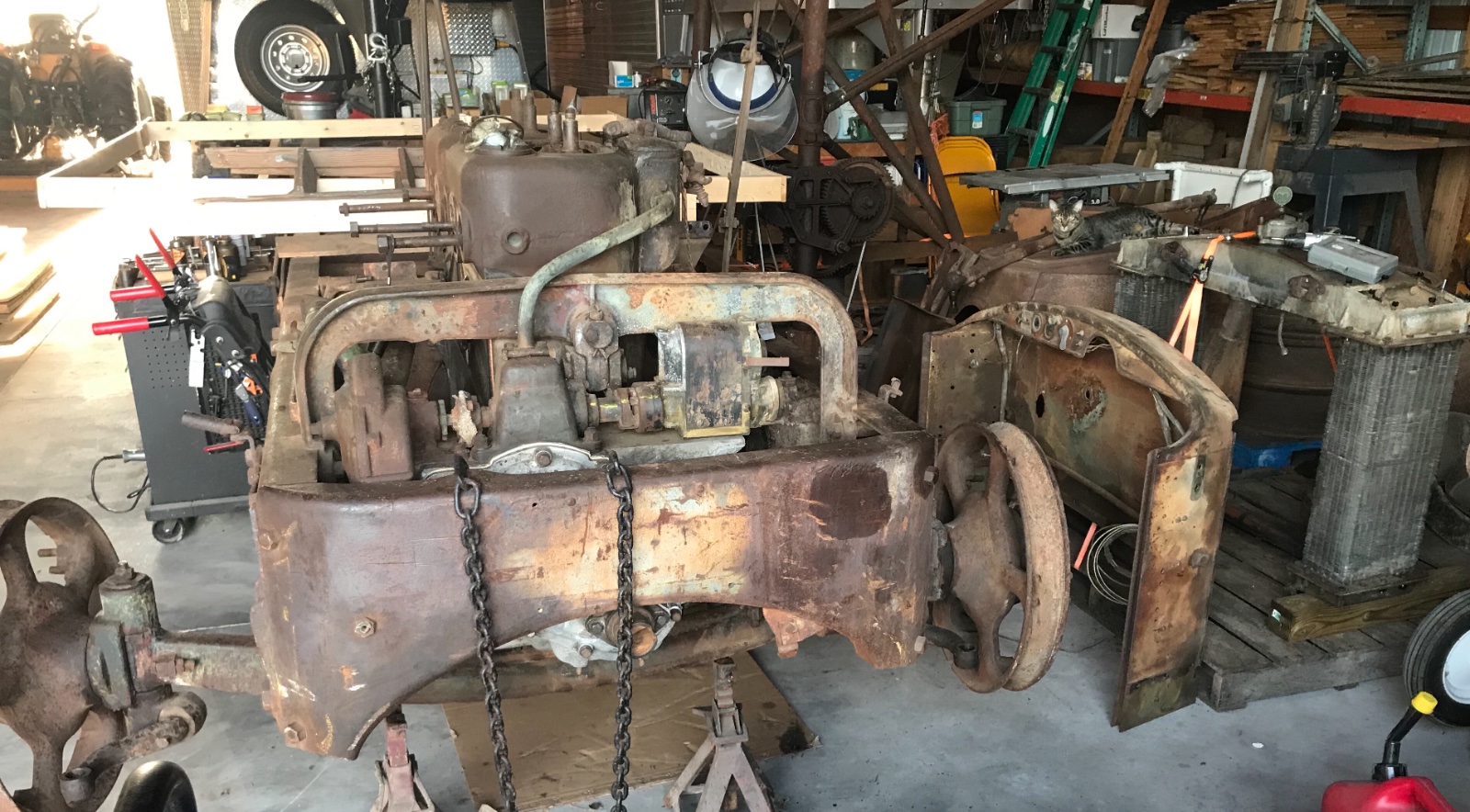

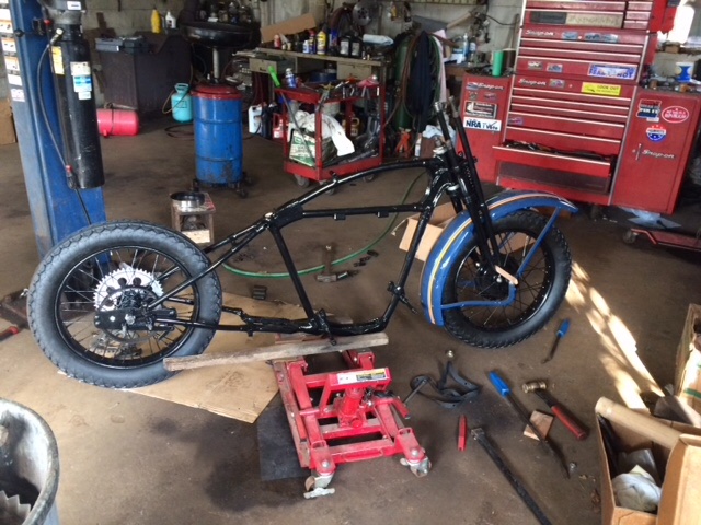

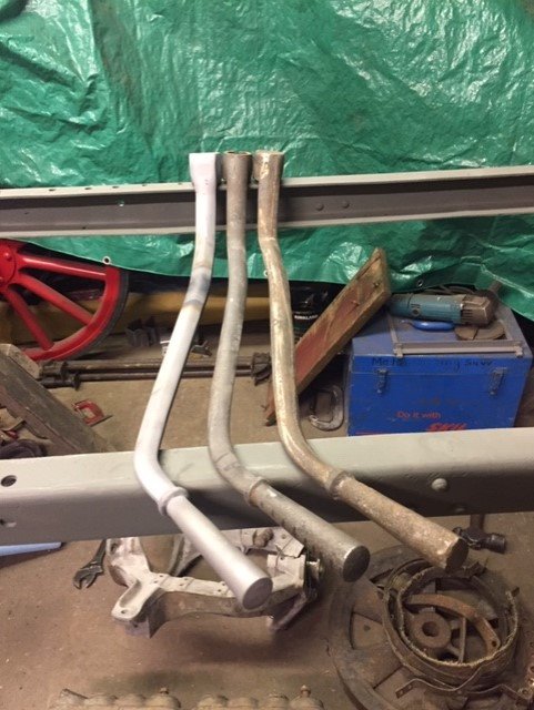

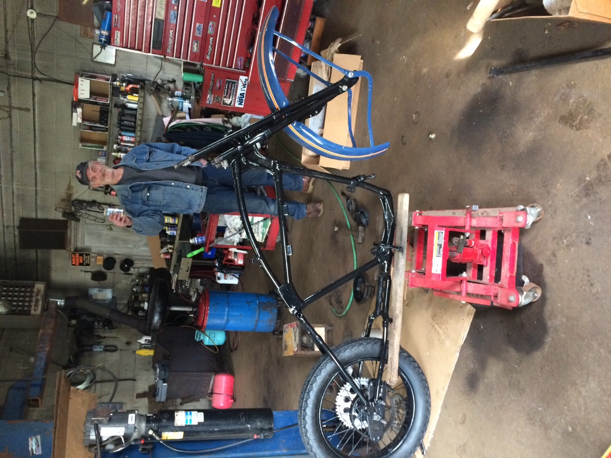

I've been working on this Model S project.
I couldn't find a frame so my friend Jim Kraut and I made one from scratch.
I borrowed one from a new friend and copied it.,

WOW! Thanks for showing us. What a great project.
I am envious.

Wow Herb! That IS great! I have made many parts of cars that I didn't have or couldn't find. Somewhere I have the correct firewall brackets for my '15, I know I do. After spending two hours looking for them (most of the parts I have for that car are separated out from the general hoards), I made a pair. Wish I was better with photography, I should have shared the project. They came out so good that installed, almost nobody would even consider that they were made by a bum like me! Of course it does help that they are pretty well hidden between the firewall and hood former.
I do hope you can get that N completed!

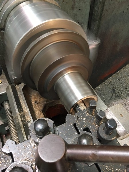

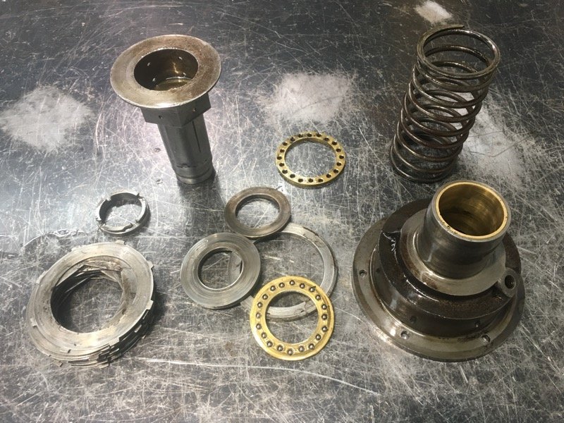

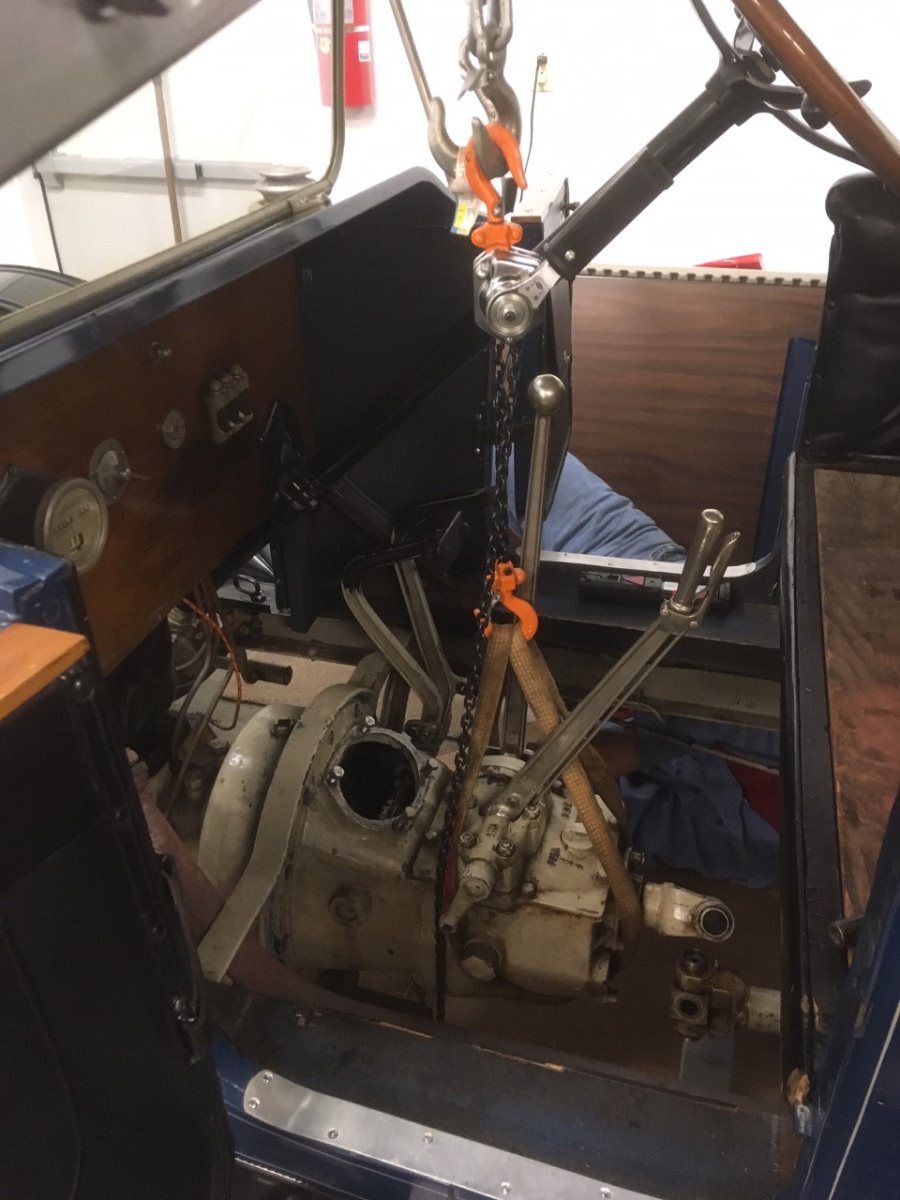

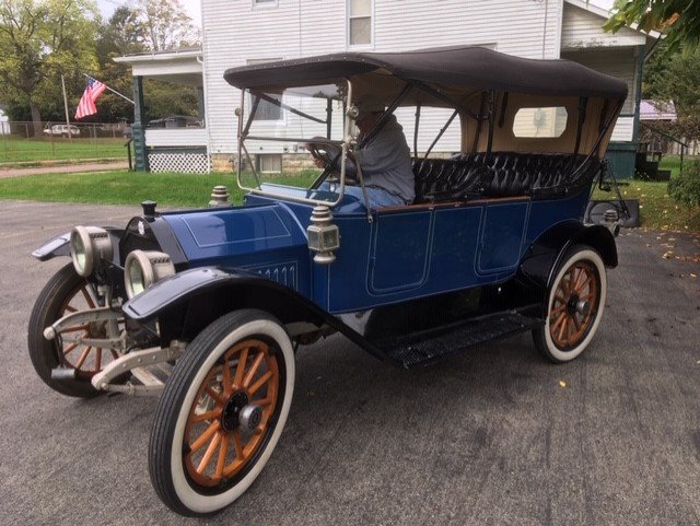

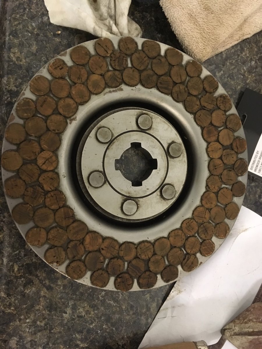

We recently changed the clutch in our museum's 1913 Empire.
It is a wet, cork clutch similar to the ones used by Hudson. Fortunately there are 2 knowledgeable Hudson owners available to give us advice.
This is one museum car that is kept in running condition and does get driven a little.
The old forums are a gold mine of information.
Post by Rich Eagle » Tue Mar 26, 2019 6:20 pm
Really cool! Fun to see the transmission and levers too.

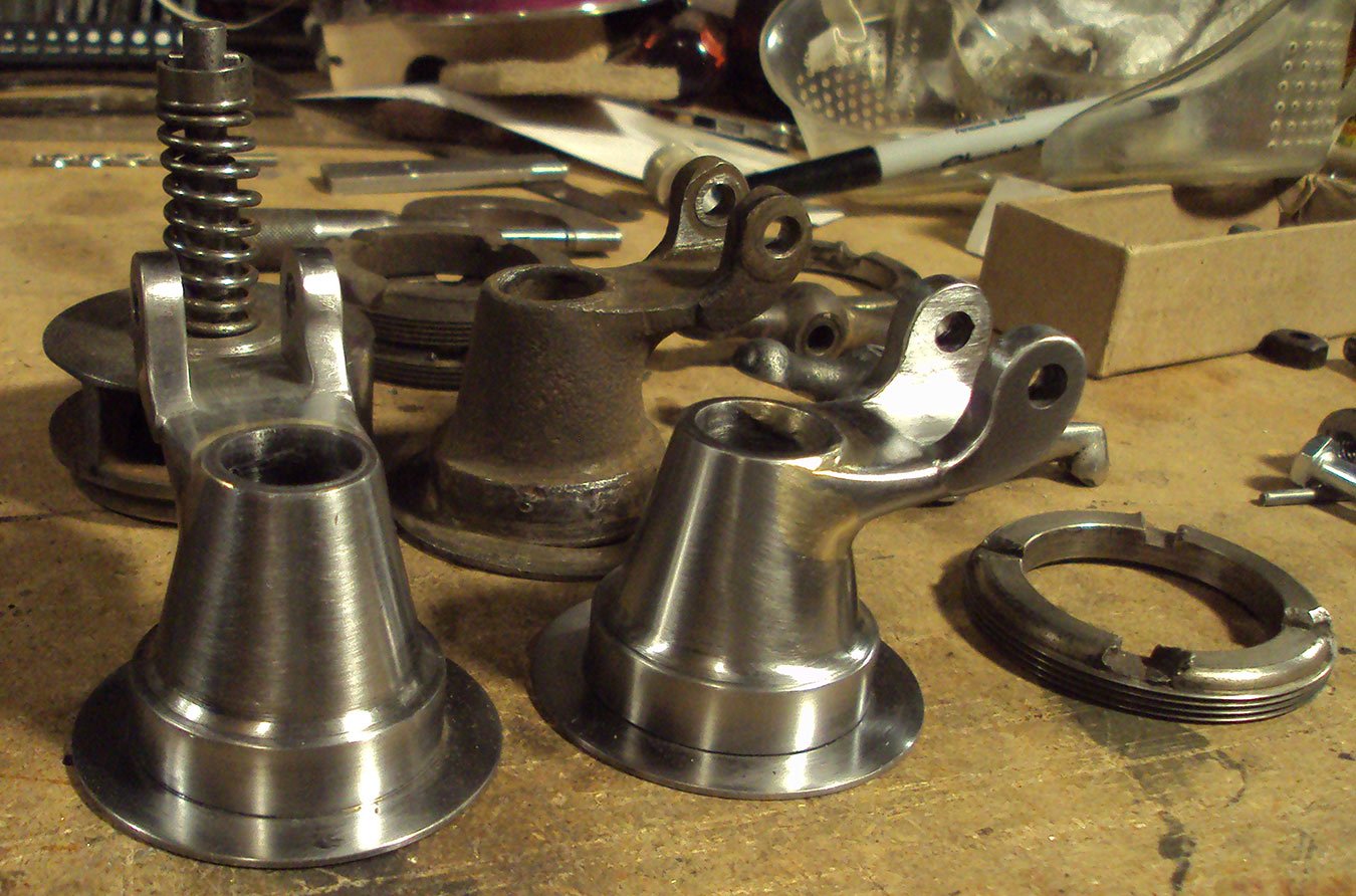

Post by Herb Iffrig » Tue Mar 26, 2019 7:40 pm

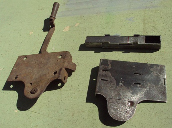

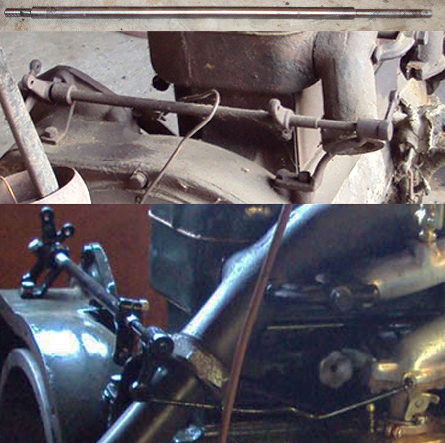

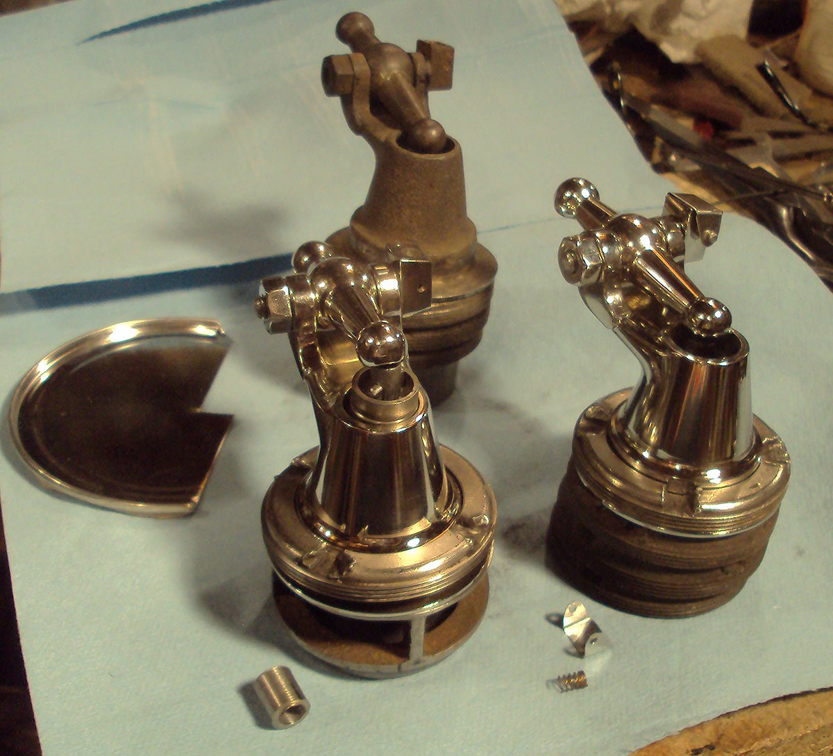

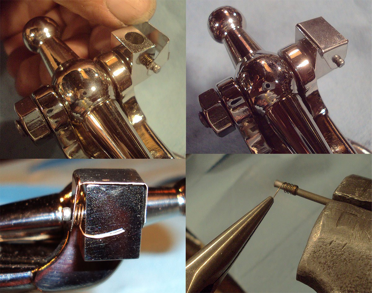

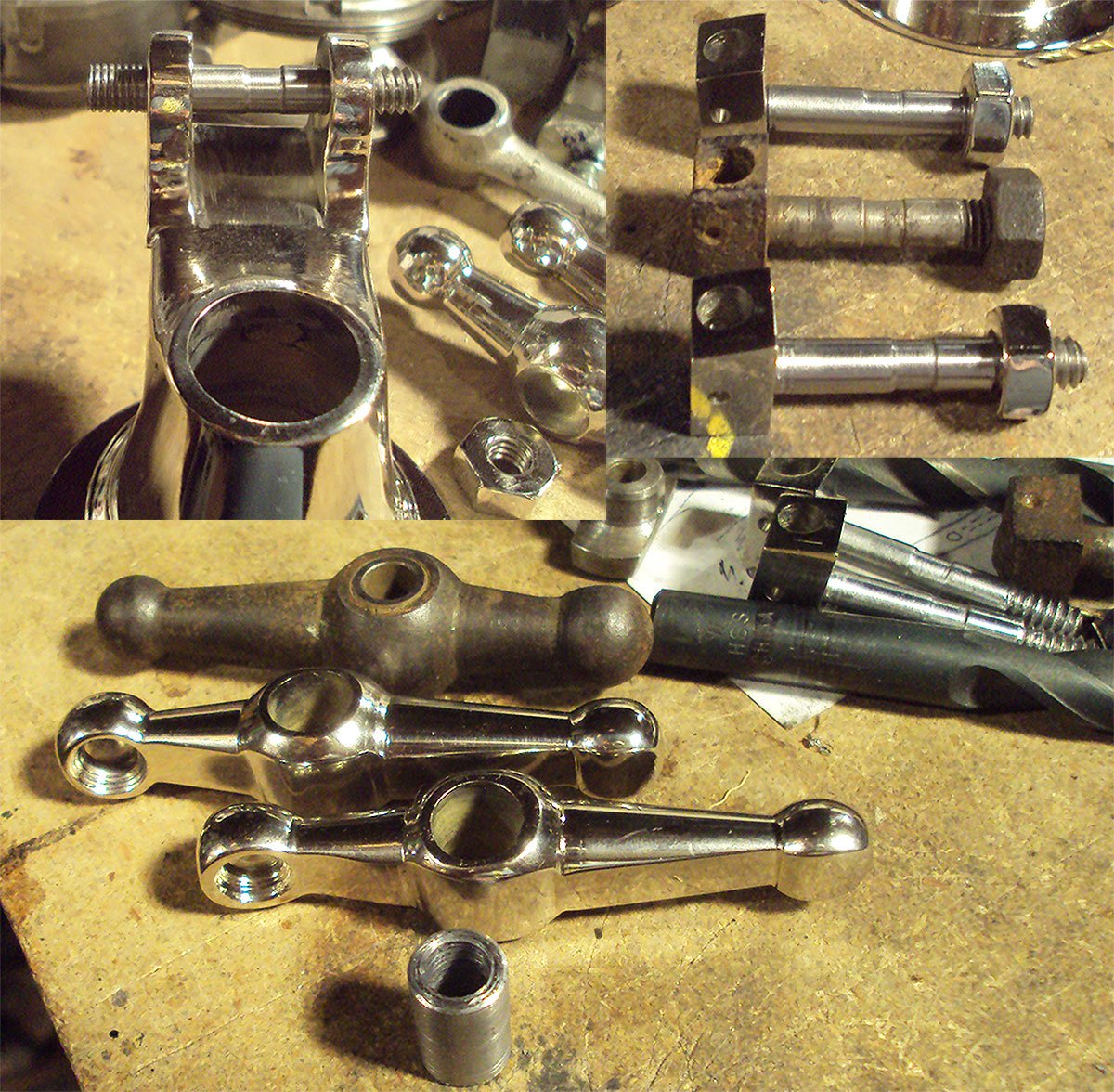

Here is another photo of the Model S project.
These are speed levers. The one on the left is the new one. It was milled out of bar stock and the clamp on the end was welded on. The middle one is an original and the right one is a casting. I'm going to use the one on the left.
I'm told the lever is supposed to be brass plated.

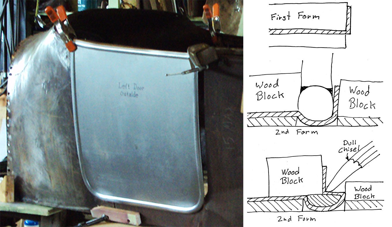

Post by Rich Eagle » Wed Mar 27, 2019 7:43 am

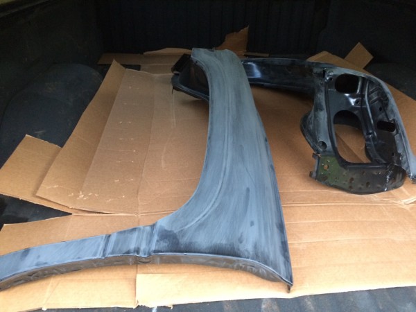

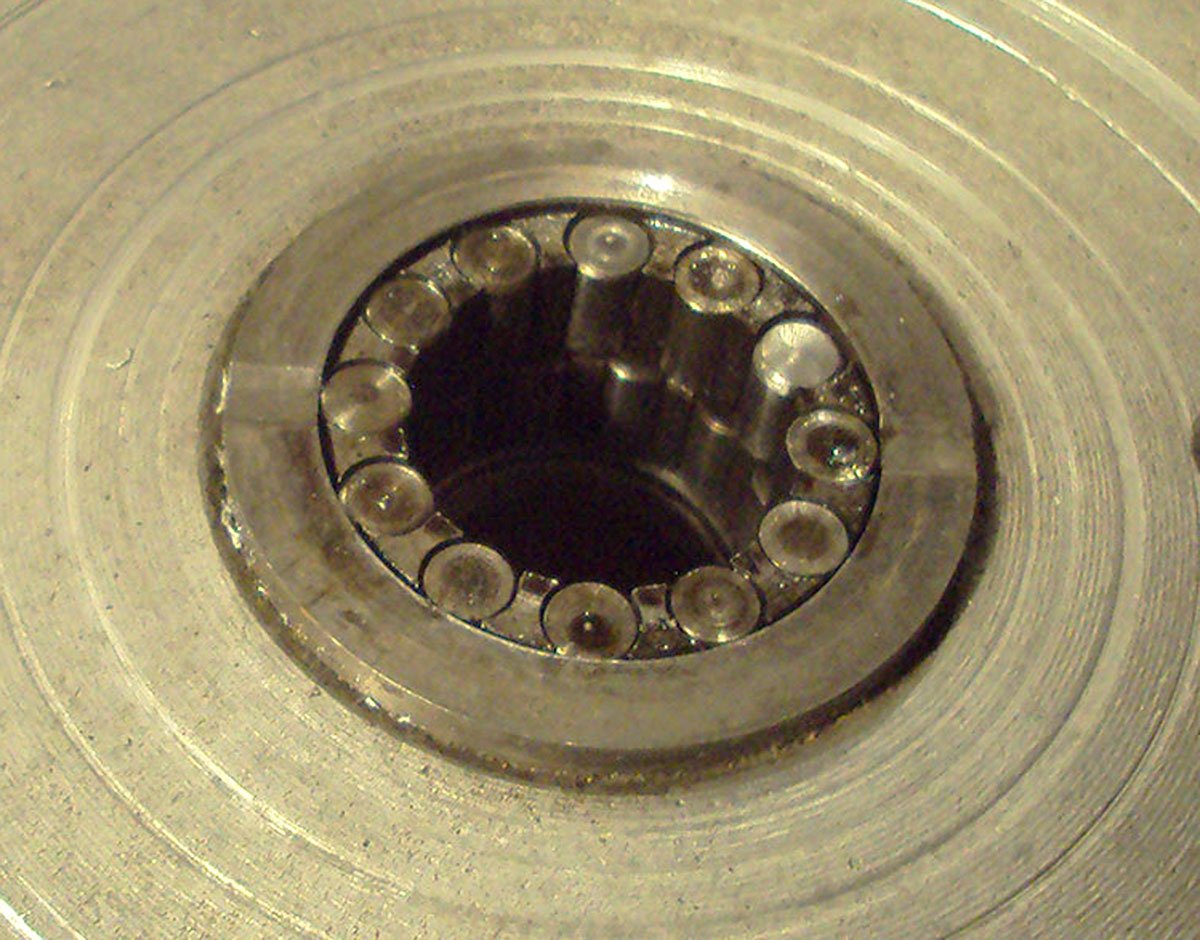

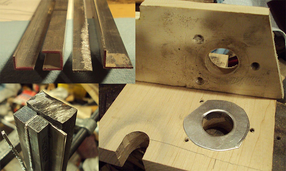

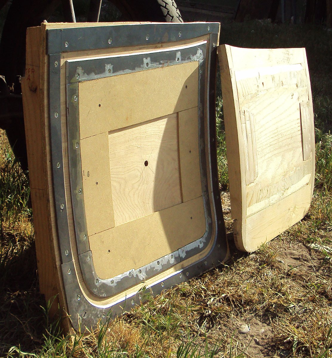

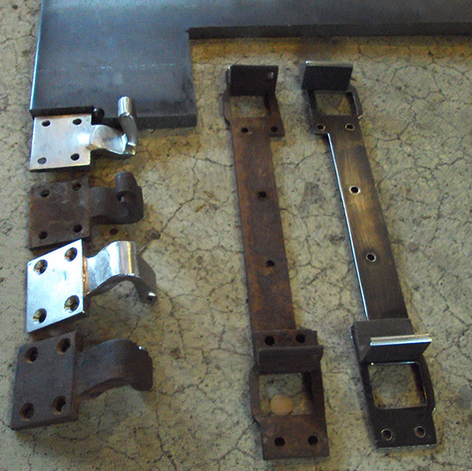

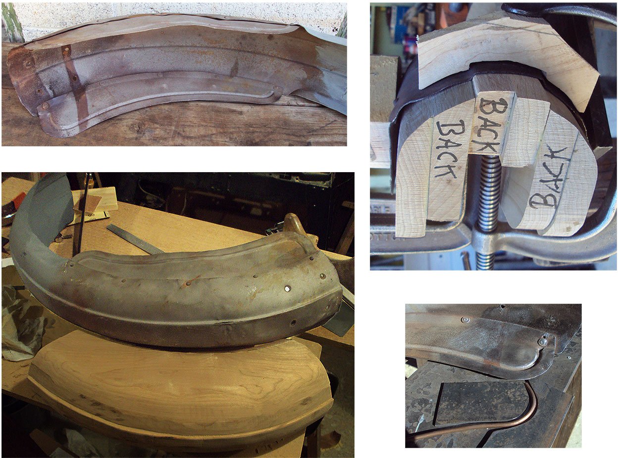

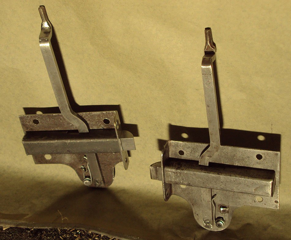

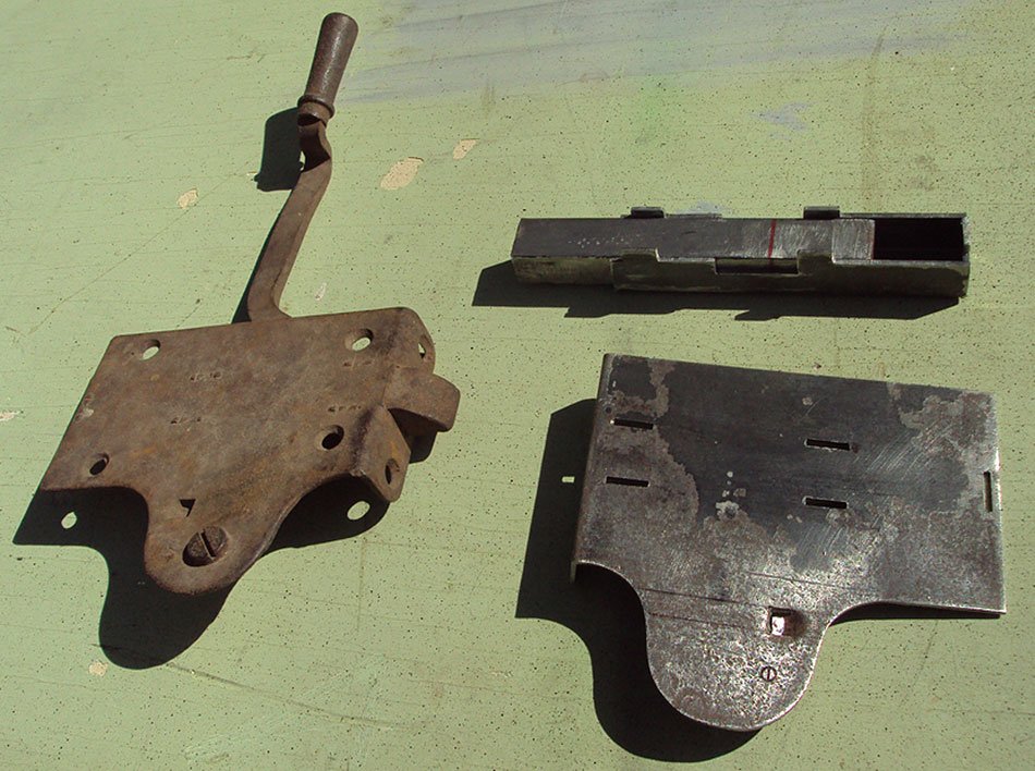

This 1915 Maxwell was missing the left door. To make a new one I built 2 wooden forms. The first one (at right) was used to bend the sheet metal edge over 90°all around. The second was used to form the bead around the door. A bar with a stem welded on formed the bead into the groove between 1/8" flat bars screwed onto the second form. This door has an overlap on three sides that covers the gap between door and doorway. A half oval bar was made to fill the bead. Backing up the sides with wood blocks the lip could be formed with a chisel dull enough not to shear the metal. The half oval bar can then be pried out.
Herb Iffrig
Posts: 1771
First Name: Herb
Last Name: Iffrig
Location: St. Peters, MO
Post by Herb Iffrig » Wed Mar 27, 2019 7:59 am
Richard you remind me of a man called "Pop" Rice. That is going back a ways. Does anyone remember hearing about him?
Post by Rich Eagle » Wed Mar 27, 2019 8:16 am
Of course a hinge and latch also had to be made. The hinge is more complicated than a T hinge as it is concealed inside the door post. However it was possible to just copy the original, other side and make a satisfactory one.
Finding the right thickness for the latch plate took some digging. A suitable piece of rusty sheet was final found. The guide is attached with slots like some Model T latches. I found I could make the odd spring by unwinding a coil spring and re shaping it.
As luck will have it a real latch showed up at a swap meet and a hinge was on Ebay. Both several years after the fabrication. No doors yet. The satisfaction of making these things is worthwhile al by itself though.

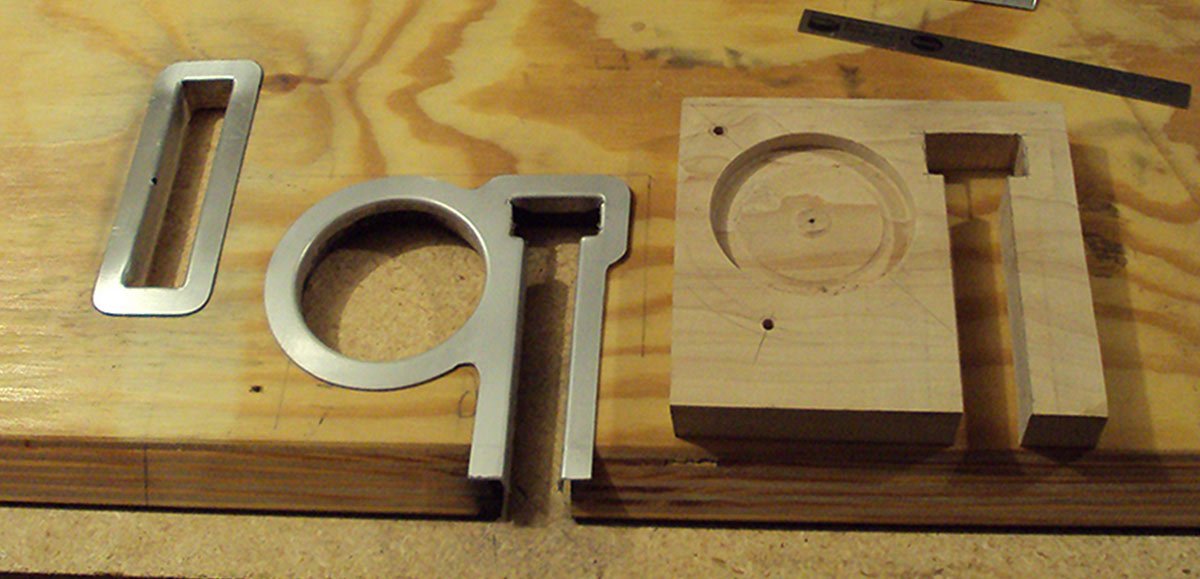

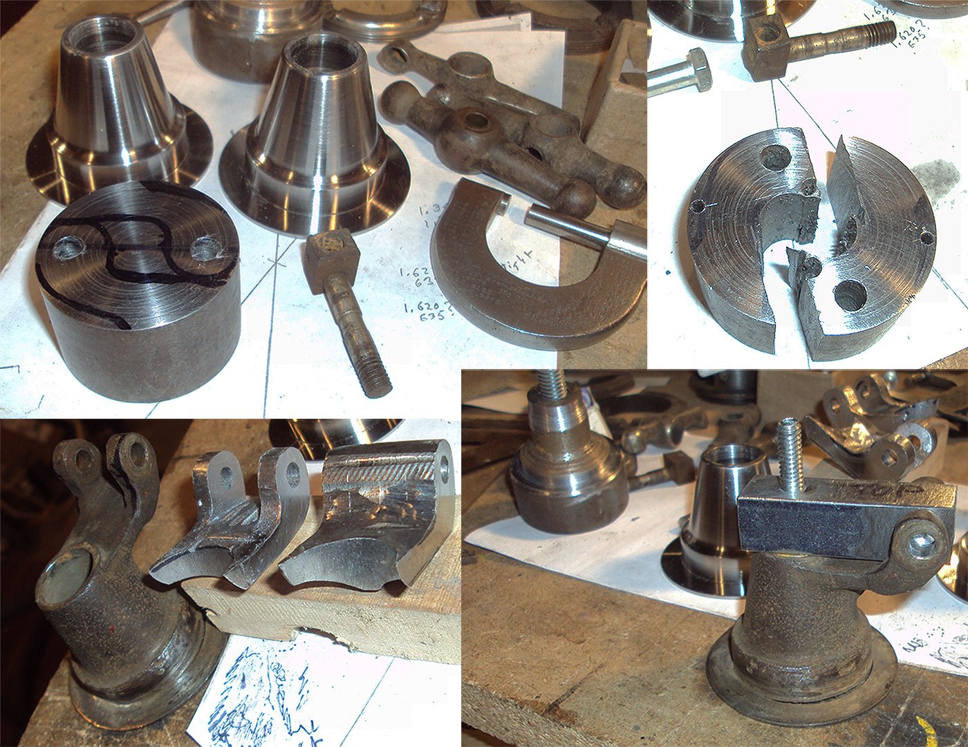

Post by Rich Eagle » Mon Apr 15, 2019 5:31 pm

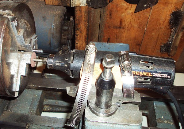

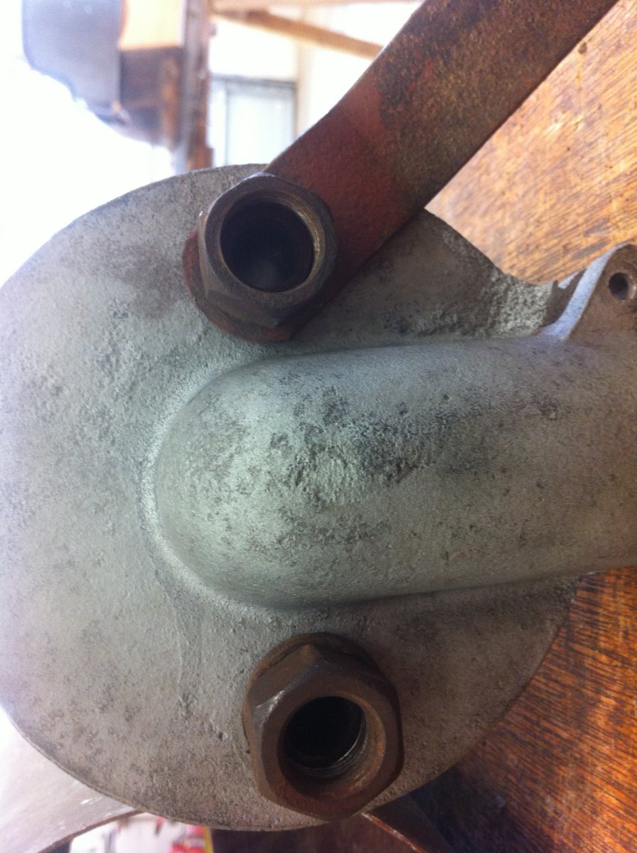

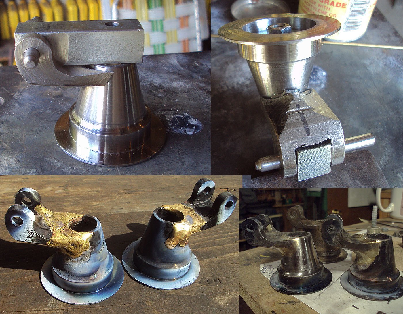

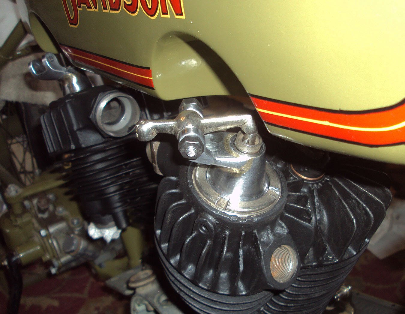

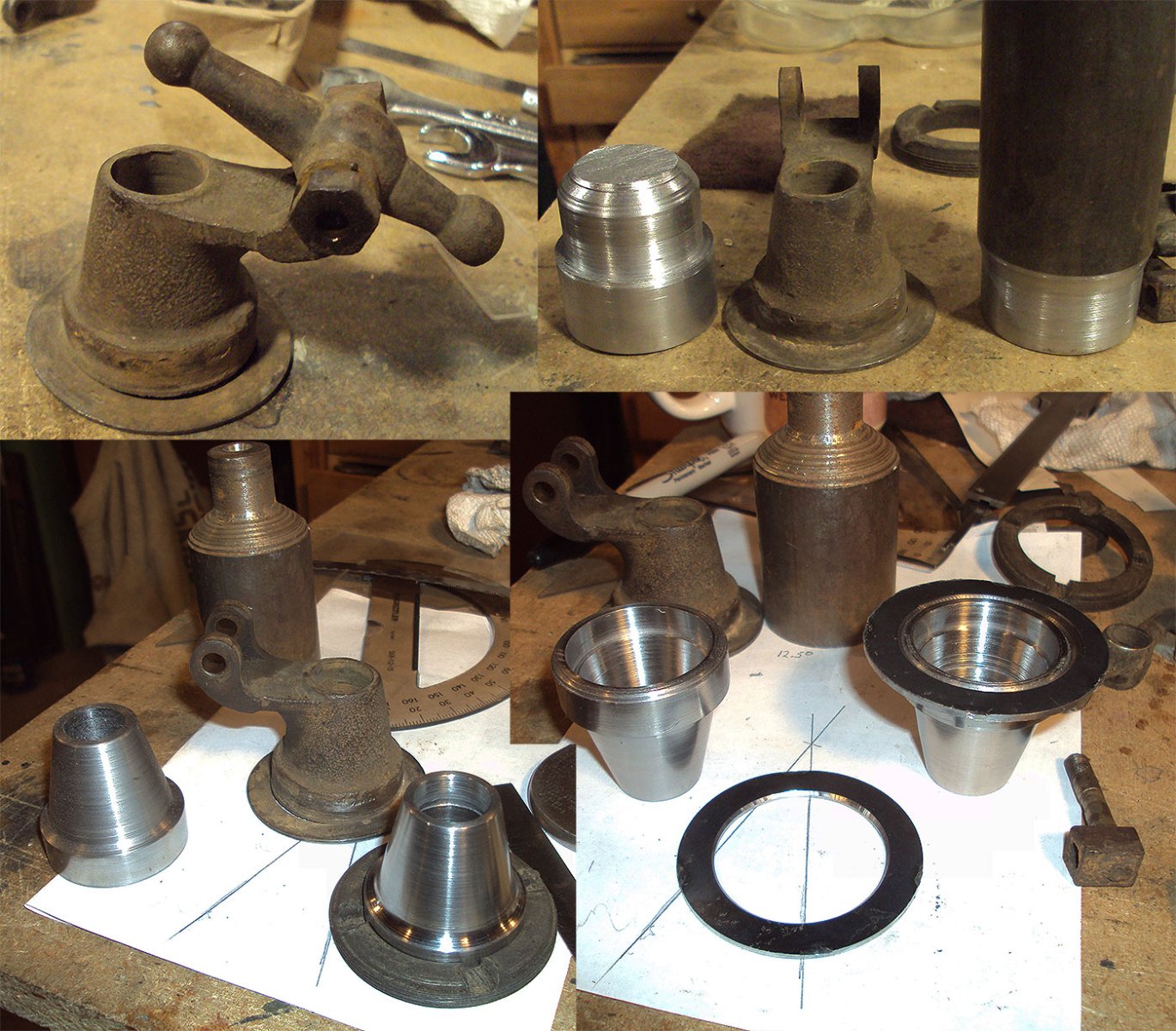

One of the charming things about the Harley JDs is the pocket valve arrangement. There are two indentations in the right tank for the intake valves to work in. The "Tower" that the rocker arm pivots in is very hard to find. I thought it would be fun to try and make a pair.
Fortunately I had one for a pattern though it was broken at the bottom . A piece of 1 3/4" round bar came in handy for this. Machining the cones careated a lot of shavings. Then some discs were cut from sheet for the bottom flange and brazed on.
The pivot arms were an odd shape and it took a while until I realized I could cut them from a slice of the same round stock. By machining the end flat I could drill perpendicular holes in strategic places and eliminate much sawing. The remainder of the shaft made a handy jig to hold the pieces in a vice or the lathe.
A piece of 5/8 square stock was used as a jig to hold the rocker shaft holes in the same position as the original while brazing the arms to the cones.
The rest of the project was to grind, file and sand the parts without destroying the turned cone shape.
These will nickle plate nicely when I get some more parts made.

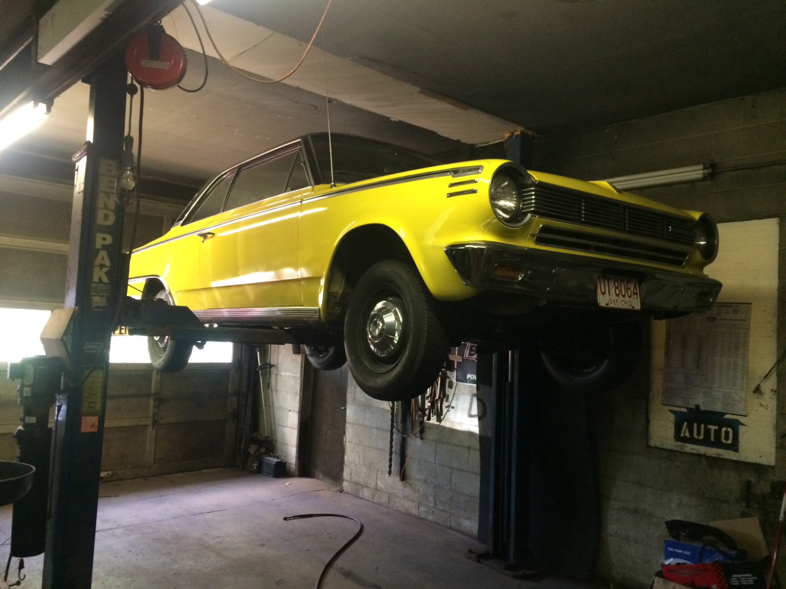

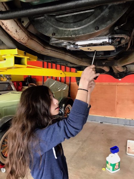

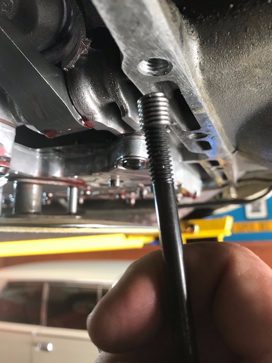

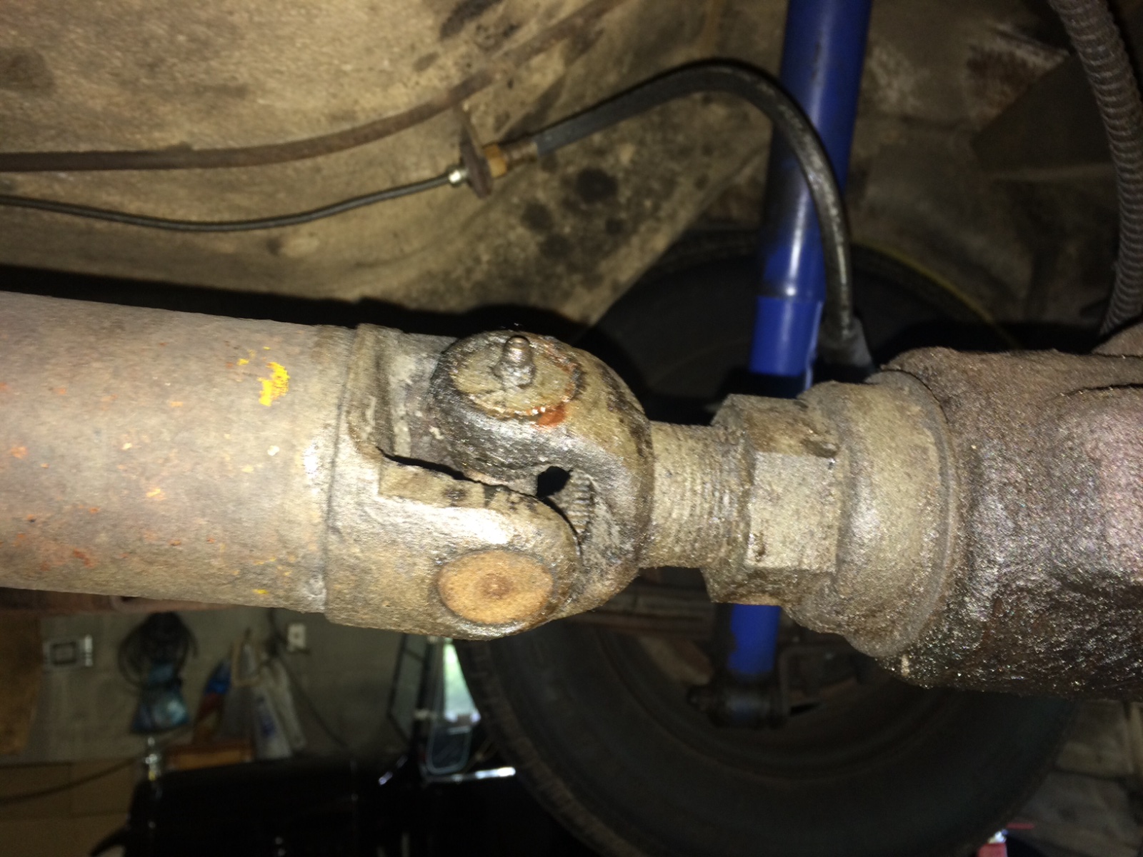

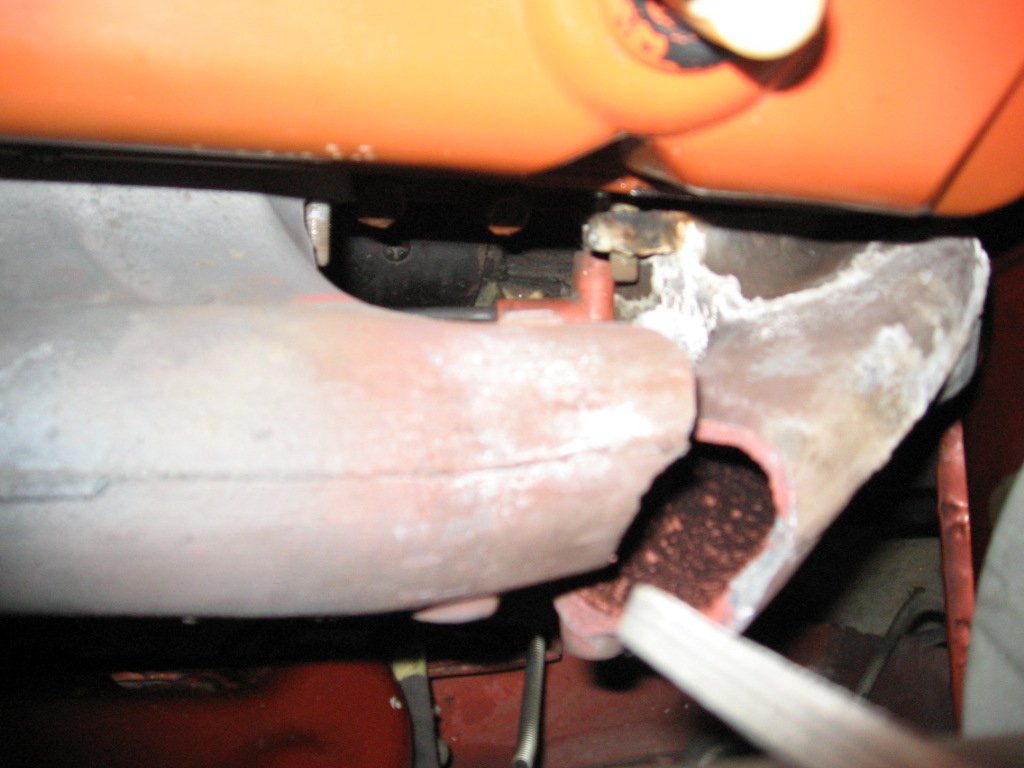

I hate, loathe and despise bleeding brakes on my old truck. It seems a leaking wheel cylinder allowed all the fluid to drain out of the master cylinder. With some vehicles that's not a big problem. You just fill the reservoir and pump the pedal until all the bubbles are out of the line. Not so with this beast. Once the master cylinder runs dry, getting fluid back into it is the job from Hell. I was finally able to get fluid flowing again by applying air pressure to the reservoir with a shop vac. Tomorrow I'll buy a new ground cable and hope that has me ready to get some yard work done.
Dennis Prince
Posts: 413
Last Name: Prince
Location: Madras Oregon
Post by Dennis Prince » Wed Apr 17, 2019 8:07 pm
Steve, on a vehicle that is hard to bleed like that, you can push fluid through the bleeder and fill the system one wheel at a time. Start at the furthest wheel and work your way to the closest. It pushes the air up into and out of the master cylinder. This can be used if you have to mount the wheel cylinder upside down for what ever reason.

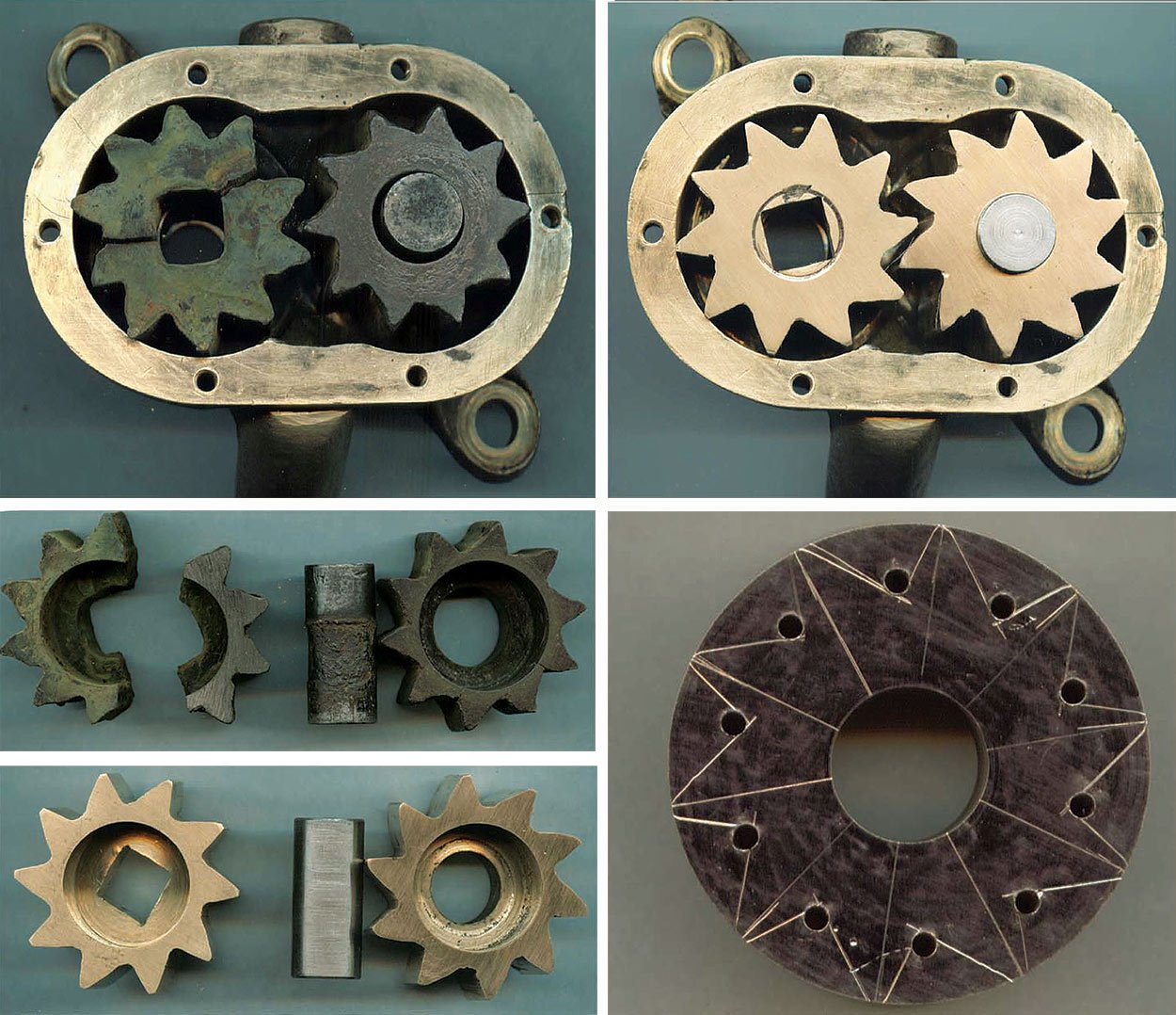

The 1907 Buick I posted on the Journeys and Joyrides yesterday had overheated for many years. The original radiator core had been discarded and a new core installed twice trying to solve the problem. Nobody wanted to open up a water pump that wasn't leaking I guess. It was suggested I do so. I found that the drive gear had broken at it's square hole. Not only was the pump not pumping but the gears were not letting any thermosyphon effect through. These gears were made of a light porous material that has very little strength. I believe it was done to be the weak point in the pump and would break before the more expensive parts in the motor would should the water freeze.
I selected to make new gears from bearing bronze and just be careful. Not having a mill I simply scribed out the shapes and drilled and hacksawed them to shape. I checking to make sure they didn't bind. While they are not precisionally perfect they do push water which is noticeable looking in the radiator neck. It cools very well for an old car under 35 MPH.
just more fun along the way.

Rich, may I ask why you didn't guess at straight cut pump gears instead of the "very little strength" bent over style?
Funny what a fella with a crazy mind, a hacksaw and a file can do? Been there, done that myself. NOT with an '07 Buick tho...
Good reminder for everyone. We CAN.

Duey, I just tried to copy what the engineers decided on in 1905. When I try to improve things I lose out. Hacksawing is one thing I think I am getting good at.
Derek, this is a good place for those interests and it broadens our horizons. I don't understand the technology but like the colors.

Post by Rich Eagle » Sun Jul 28, 2019 4:14 pm
The Harley rockers plated nicely
The next step was to build the shafts to rock on. I waited til the plating was done for any size changes. Bushings were also made.
The shafts are drilled for oil and have a little box at the end with a spring loaded cover. I made a temporary cover from a tin can bottom. It was a little tedious installing the spring. Coils springs can be pulled straight and modified fairly easily. Eventually I will build better covers perhaps out of stainless. I think they are a bit dainty to buff and plate.

Beautiful !! Uh, what is it ?!? :shock:
After your edit - I kinda figured that's what I was looking at, funny how so few words make it perfectly clear. I still say it's beautiful !!

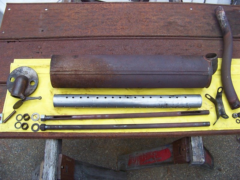

I recently had to repair the muffler on my '14 Metz.
On July 13th I drove the Metz to the annual Metz Gathering at the Waltham Museum in Waltham Massachusetts, that being where Metz cars were built. The round trip was about 150 miles.
Well, as I was checking over the car a week later before attending a local meet I discovered that the muffler was falling apart due to one of the nuts which hold together the muffler and loosened and fallen off. No driving the car in this condition. Bummer!
These nuts (four of them) screw onto two thin pipes (or heavy wall tubing) which run the length of the muffler on the inside and exit through the two cast iron end caps. The pipes are 0.665 inch OD and the ends are 24 threads per inch. The only place to get these unique nuts is from the Metz parts room or from the chunk of steel on the table of the milling machine.
I spoke to my son-in law for assistance as he is co-owner of a small machine shop. My daughter married well.
"No problem" says he, "Let's make four incase another is lost later." They looked good and fit nicely.
After removing the muffler from the car to decoke it I discovered that the inner baffle was absent! I fabricated a replacement with a piece of appropriately sized exhaust pipe which I perforated as the originals were. I also added a small bracket and spring to hold closed the valve of the integral cutout valve.
It was a satisfying project.
The component parts of the Metz exhaust system, excluding the manifold.
The Metz has, I think, a very restrictive exhaust system. After the exhaust gases enter the muffler through the short exhaust pipe, they leave the inner baffle through the many holes. Then those gasses must enter the three narrow slots milled into the two inner pipes and exit through the ends of the pipes. The Metz manual mentions that the exhaust cutout can be opened on hills for more power.
These two holes (the ends of the inner pipes) and the two on the other end cap, are the exits for the exhaust gases.
Bill Harper
Keene, New Hampshire

Here's a little more "unexpected" annoyance.
65 Rambler American of a friend's, pulling transmission to replace front pump seal and such.
Anyone know how this driveshaft comes out ?
Chilton's says "remove shocks, U-bolts at leaf springs and slide rear axle back !! :(
I plan to just slide the slip joint out of the transmission. One of the U-bolts was already broken, so he's getting a couple made and back to it Monday.
Post by Ruxstel24 » Fri Aug 23, 2019 9:11 pm
Here's a picture of the whole Rambler...

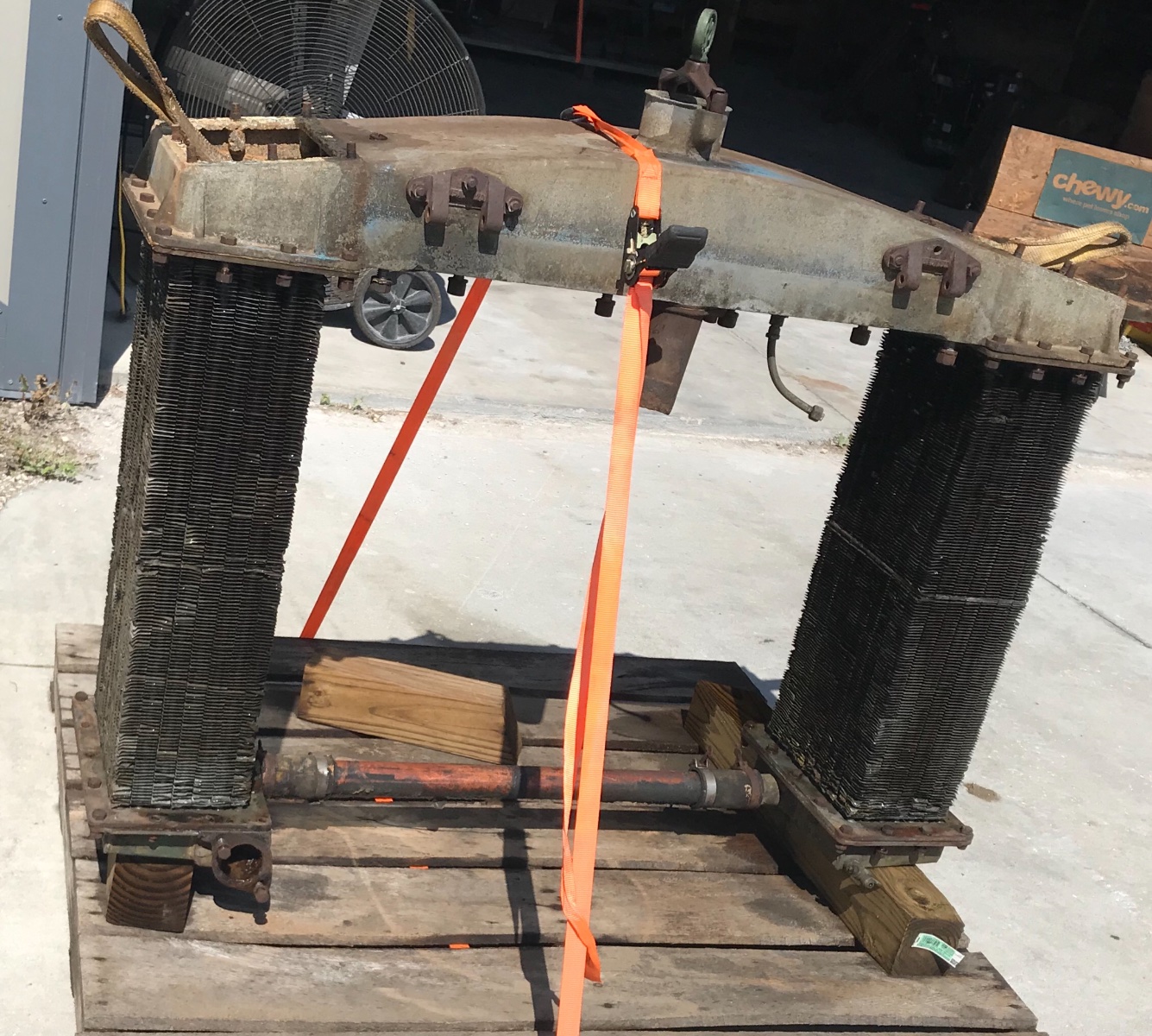

And at last, here is the actual radiator.
For scale, the pallet is 48” wide.
Now off to the radiator guy to get it cleaned and checked out.

Paul, that looks heavy. There were no "rules" back then. Build it to what is needed. Thanks for the update.

Hmmm, removable covers above the cores. Inspection and cleaning if need be. I think, very cool.
Weight: One of my mid sized trac...s... Eh hem OT has a radiator that is 130 pounds and I'd bet that truck rad trumps my OT rad.

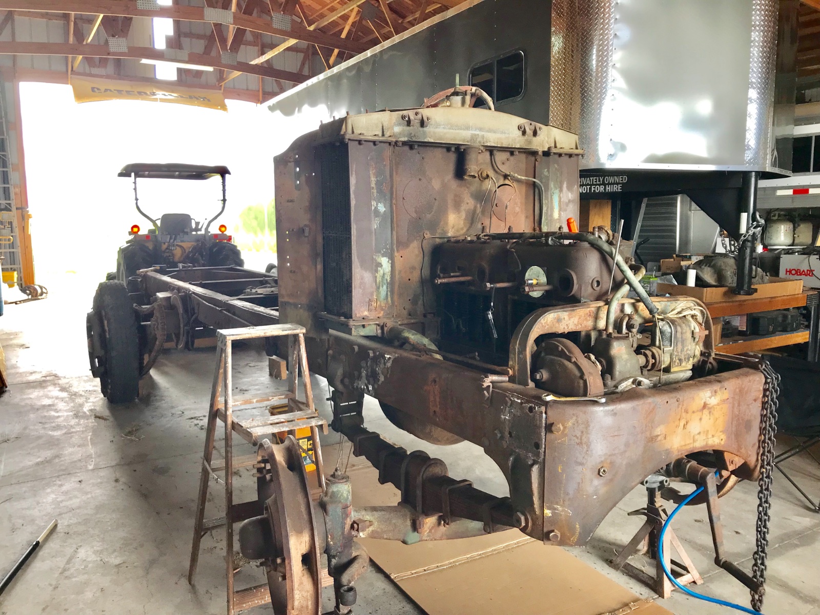

Post by PDGx » Thu Aug 29, 2019 8:20 pm
Had to consolidate and park everything out of the way for the next week or so - to make room for the RV - (security is on duty)

More than forty years ago, a few friends of mine were working on big Mack trucks like that! I really enjoy seeing someone else tackle one of these. Wonderful and quite impressive trucks.
One thing about that "short term memory" you joke about on your signature line? Two weeks after the cleanup is done? You can forget about the hurricane. Just be safe in the meantime.

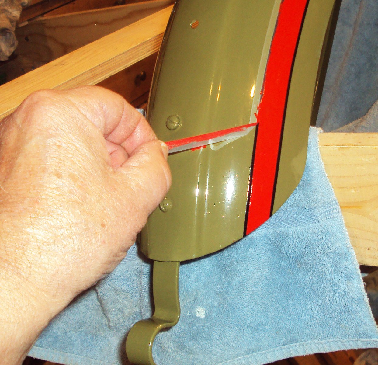

Post by Rich Eagle » Sat Aug 31, 2019 12:33 pm
My best wishes for anyone weathering the storm.
My Harley fenders had seen some exciting times. I sand blasted them a few years ago and made a wooden buck to start straightening them. A month ago I started the finish smoothing and finally painted them this week.
The final step was striping them. I use Scotch Magic tape and 1 Shot lettering enamel. After a few minutes of drying the tape can be carefully removed and the paint dries cleanly without a raged edge.

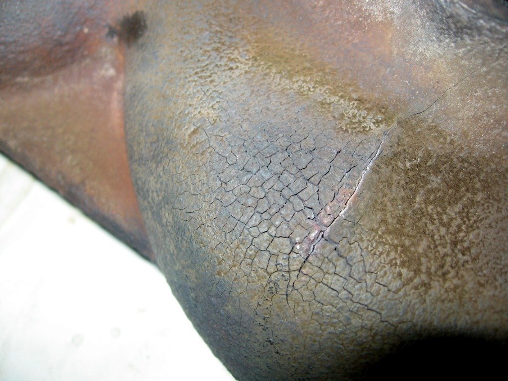

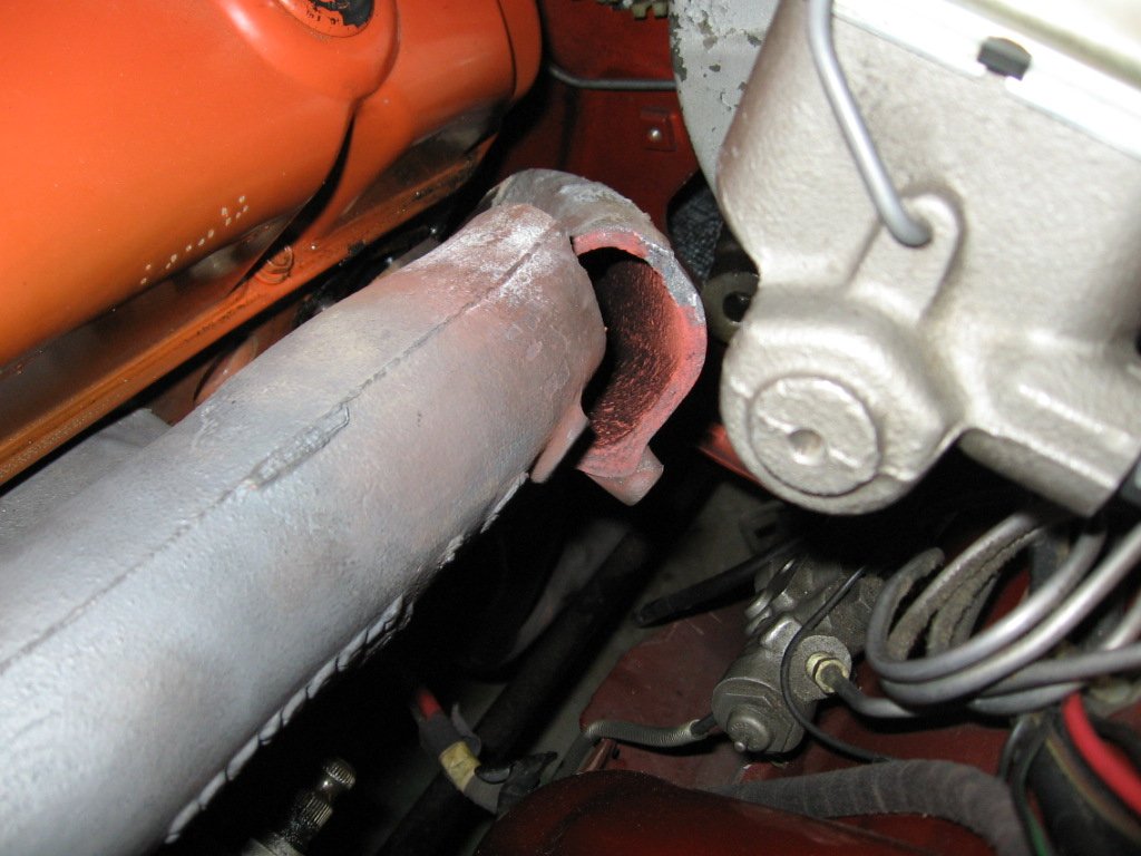

A couple of months ago, I finally got fed up with the exhaust manifold leaks on my 1971 Plymouth GTX. I thought that the gaskets were blown, but once I got the manifolds off it turned out that the driver side manifold was cracked into two pieces and the passenger side manifold had a circular spot with cracks radiating from it.
I purchased two good used manifolds and swapped them in, the exhaust is nice and quiet now. :)
Post by Rich Eagle » Sat Aug 31, 2019 12:53 pm
As for the paint I use tractor and implement paint from our Cal Ranch store. I matched the Harley color using black and yellow. Perhaps a touch of red also. It's been more than a dozen years. The enamel has a very good shelf life if kept tightly sealed. However as the level goes down air lets the top dry to a skin. For that reason I pour the paint in a smaller can as it gets low. I mixed a quart and moved it into a pint can and then a half-pint can. After painting the fenders the half-pint can was half full. I have tried smaller jars and "touch-up containers over the years with poor results. This time I cut down a half-pint can and soldered it together. There are a couple chain guards to make and they will need matching paint.

Mark S, You may want to check your exhaust system for some sort of blockage or flow issues. One of the few times I saw exhaust manifolds do like that was my dad's '68 Chevy pickup. He had always pretty much done his own repairs most of his life, but as he neared the end, he just couldn't. The exhaust system had been patched along a few times and was really ready to fall apart, so for one of the few times in his life, he took the truck to a muffler shop. This was over fifteen years ago, but even then wasn't like forty or fifty years ago when good people in good shops could easily be found. It only took a few months, and one side exhaust manifold bubbled out and broke. He replaced it. About six months later, the replacement did the same thing. He again got a replacement. By this time, I figured something was wrong, so I crawled under the truck and looked at it. Turned out, the highly rated shop instead of using or making a "Y" crossover/connector to run two banks into a single exhaust, used a "U" shaped crossover straight from the left to the right manifolds! To make it even worse, they cut into the middle of the crossover pipe, and welded the outgoing exhaust pipe in at a significant angle!
This horrible (choose preferred expletives and similes here) did TWO things that made short term failure a certainty! One, because the output was significantly angled, one side of the motor exhaust flowed nicely on out to the muffler and tail pipe. The other side, had to fight its way doubling back and pushing against the other side with a dominant flow. So slightly more than half the crossover pipe had one side that pressurized hot gasses and held them causing the manifold and crossover pipe to heat up way more than normal. And then two, because the shallow "U" shaped pipe went straight under the oil pan, the two two inch pipe formed bends with only a few inches of rise on each end had virtually NO NADA NONE flex. The overly heated crossover pipe, at about a thousand degrees more Fahrenheit than the crankcase, expanded more than the block did. Once the manifold bubbled and cracked like yours did, it didn't take much differential in thermal expansion to snap the manifold into several pieces.
Even if you have dual exhaust, if something has caused partial blockages in a muffler, it can create a significant back pressure and cause the manifold to do that.
Posts: 2550
Last Name: Strange
Location: Hillsboro, MO
Post by CudaMan » Sun Sep 01, 2019 8:37 am
Wayne, now that you mention it, I did have an exhaust blockage earlier in the year - the flapper in the manifold heat control valve broke off and got blown downstream in the passenger side exhaust pipe earlier in the year. It was causing an intermittent rattling sound. Thinking that the sound was coming from a loose muffler baffle, I removed the muffler and found the flapper stuck in the exhaust pipe just upstream of the muffler.
The heat control valve in the replacement manifold was already damaged, so I removed it and plugged the pivot shaft holes, so there will be no chance of a repeat occurrence with the replacements manifolds. :)

Post by Rich Eagle » Tue Sep 03, 2019 2:21 pm
Had I concentrated on the bike stuff rather than the T stuff 50 years ago it would have been a better move financially. The initial $75 for the bike and a couple hundred in parts has increased 100 fold. The wrong parts I bought will easily pay for anything I buy for it now. T stuff hasn't done nearly that well. Not being able to find certain bikes parts stopped me frequently and I have built a dozen cars since then. From time to time I find a bike part and it spurs the project along but I doubt I will ever try to ride the bike. It is a static display at this point but lots of fun to own.
A flathead V-8, a two cylinder car and my Yellowstone Bus have been wonderful projects but for fun and practicality I keep coming back to the Model T's. You just can't beat the fun of driving and working on them for my money.
