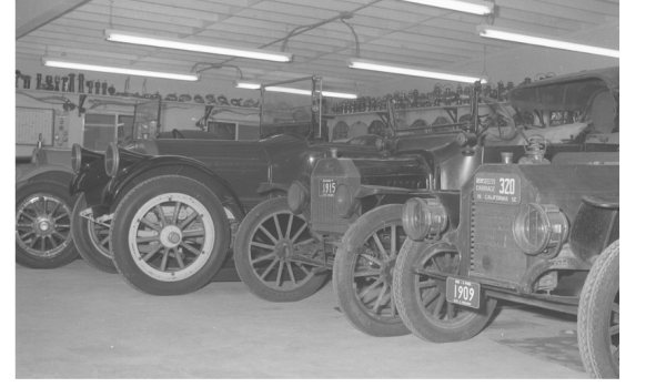

Forgive my ignorance, but I was wondering where do you get tires for the rare vehicles, with odd sized rims. Are they custom made somewhere, or does one or two companies manufacture them somewhere and sell them?
I do not have a vehicle myself, nor does anyone in the family that needs special tires or anything, I was just wondering... :)
I know that you can buy Model T tires from multiple sources, but what about all the odd sized tires for other models?
As you can see here in this photo, there are numerous different sizes and shapes.

Nice photo Austin.
There are several companies that offer a variety of types and sizes for most antique car, truck and motorcycle rims. Coker, Universal, Lacas and others can be found on the net.

Once upon a time, it was not that uncommon to re-rim a set of wheels to accept more available tire sizes. Similar to the recent 30x3-1/2” white tire availability issues, obscure tire sizes are made in occasional batches and may be several years (or more) between batches
