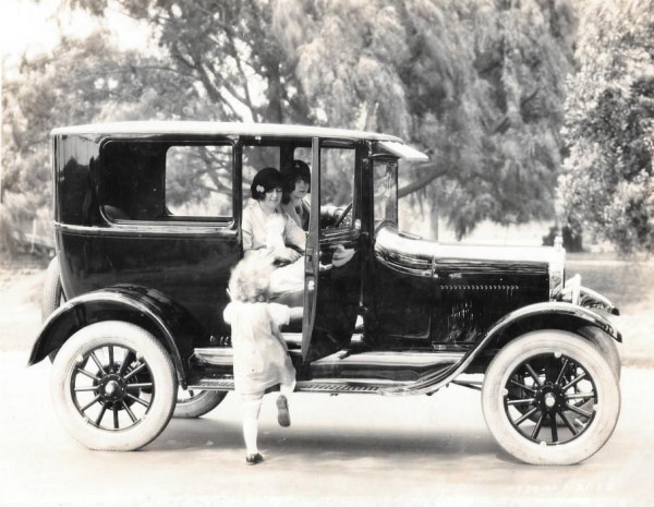

Much has been posted in the subject of the pyroxylin finish on bodies for the Improved '26-'27 cars, and how they were a "satin" or low luster finish. This photograph is from promotional material for the new series, and it sure looks like it's about as shiny and high-gloss as anyone could wish for. Thoughts ?

Someone probably had it "Simonized". As I understand it, the cars were not polished at the factory. Dealers could polish them, or the owner could do it, or have it done.
I'd think the paint would take a much better shine after having cured for at least a few weeks. Ford did not keep cars sitting around the plant waiting for paint to dry.

Wouldn't Ford want them to be shiny when new? Because shiny sells much better than not so shiny. I suspect the shine didn't last very long after purchase and being exposed to the elements except for the most meticulous owner.

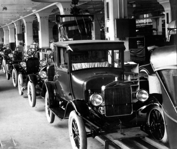

This photo shows the gloss at assembly. The color may not be as reflective as the black on the fenders which may have still been Japan Black.
Competing against other makes, I think they would have had to be somewhat glossy. Advertising photos would have been taken with the best lighting. Nickle plating and striping would complement a semi-gloss very nicely.

Ford may have "dolled" this one up for a promotional photo. The numbers in the lower right-hand corner of the photo suggest to me that it's a factory photo. Or, maybe black ones were still shiny?
