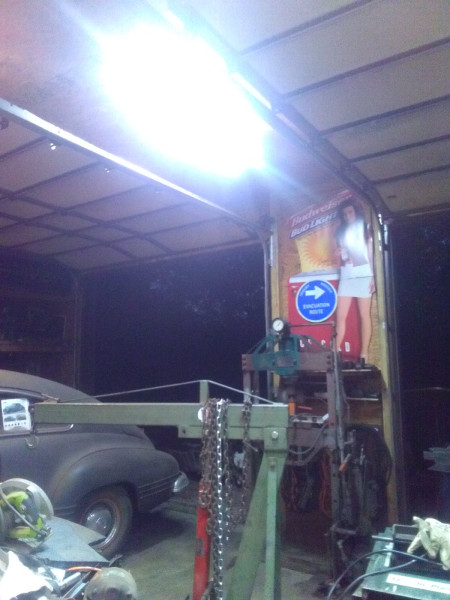

Folks I just thought I would share something that may help some of you regarding shop lights.
When I had my shop wired, I used 18 recessed lights because the man had them for free that did my electrical and I could just screw in a bulb. I was afraid of florescent because the flashing might cause a seizure since i had some the night of my head injury.
and led was not common yet.
Well fast forward to a couple weeks ago,in wally world I spotted a folding 4 foot led light that screws into a bulb socket.
I can't climb ladders and have to have someone change bulbs and such for me.Naturally being a tight wad I didn't buy the light at Wally world as it was 35 bucks for 1 light if I read the price right.
I found these on Amazon and just got them installed this evening.
Let me tell you, BIG difference. I Just ordered 4 more .
https://www.amazon.com/gp/product/B0BD4 ... UTF8&psc=1
Took longer to drag the ladder around than it did to upgrade the 4 lights.
You can't take a good pic,I tried.
They don't blind you when you look up at them. but the flipphone pic gives the impression they would
When we screwed in this first 1, we took out a led bulb and this thing lit up we were like WOW ,5 times the light at least.

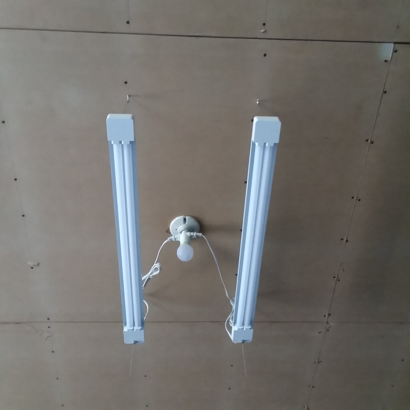

It all works nicely off the wall switch. And it won't spin the light bill up.

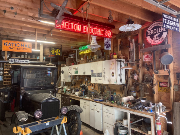

Since I built my own place, I did not inherit old wiring and fixtures to
adapt to. I pulled my own wire and placed outlet boxes all over the
place to plug lights and neon signs in to. They began as 4' fluorescent
shop lights, but were replaced a few years ago when I found a screamin'
deal on some same-size LED's. Strung through the entire area are strings
of cafe lights. These have the old incandescent-looking bulbs that are
actually LED as well. The former really light the place up for work, where
the latter provide a softer, warm light that is nice for ambiance. I can turn
on one or the other, depending on my need.

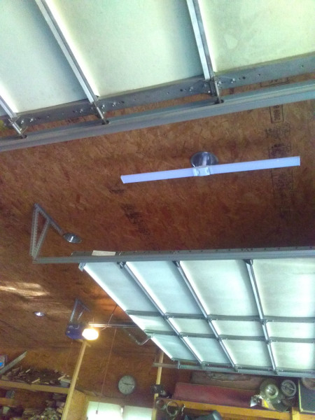

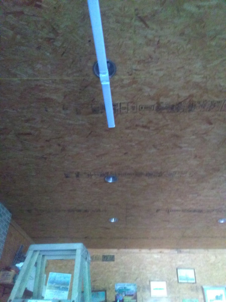

In my case the included extensions were not enough to get the new light below the ceiling but if your sockets are surface mounted, you should be good not using anything .
I wish a 100 times over I had known just 3 things before I built my shop. 1, 2 cement blocks higher and i could have installed a car lift, 2, had i known about the truss's with the fake bracing in the middle, I coulda had a storage or work area in the attic area of the shop 3, put outlets in the ceiling to plug in any old kind of light that does the job.
Bare in mind when you get the box and you handle each light ,you may think,Wow this thing is light and cheapy how is it going to work? well, just screw it in, it works!
