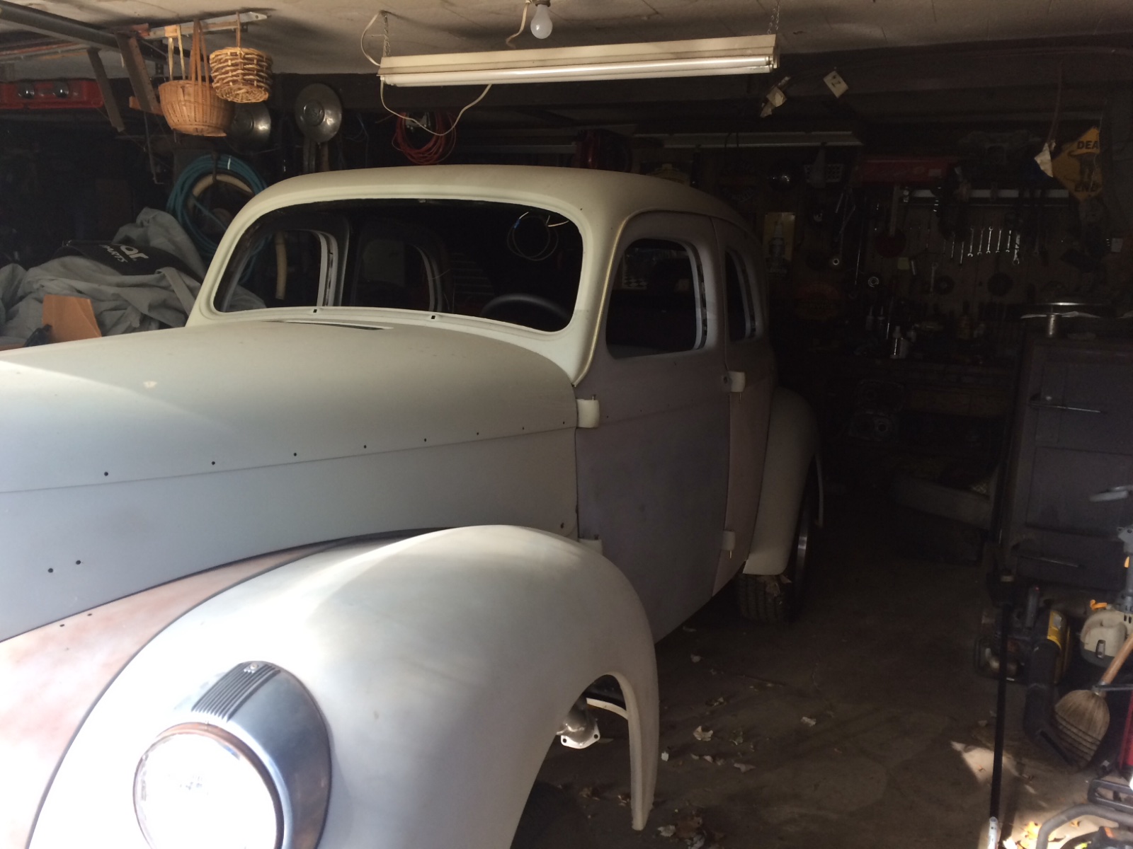

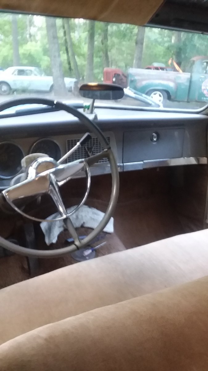

Forced once again to sell everything I had worth keeping, any antique close to being drivable, I am again cutting lots of corners, to make a car that will not be anybody's idea of a beautiful restoration. But hey, If I can get it on the road, and on tours? I will love it! And besides, it is so bad that nobody else would likely restore it these days. So whatever I do with it will be a huge improvement.
I loved your comment: " I have lost a lot of time waiting to do things the proper way."
One of the important lessons my dad taught me, entirely NOT meaning to. He was a "wanna-be perfectionist". He had many great plans. The cars and trucks he was going to restore. The businesses he was going to start. Don't get me wrong, he was brilliantly intelligent, in some ways. But he was dumb as a stump in others. He bought the 1927 Paige when I was fifteen, to be the "great family project". It was disassembled, and never restored. Within a few years, I had restored my first model T, was driving a 1929 Reo, and working on others. I restored one, then another, and another, bought and sold more, had, drove, and enjoyed many (I wish life had allowed me to keep some of them!). I figured out rather early, that although "perfection" was a desirable goal? Never doing a thing just because you were going to wait until you could do it "perfect" wasn't any good either.

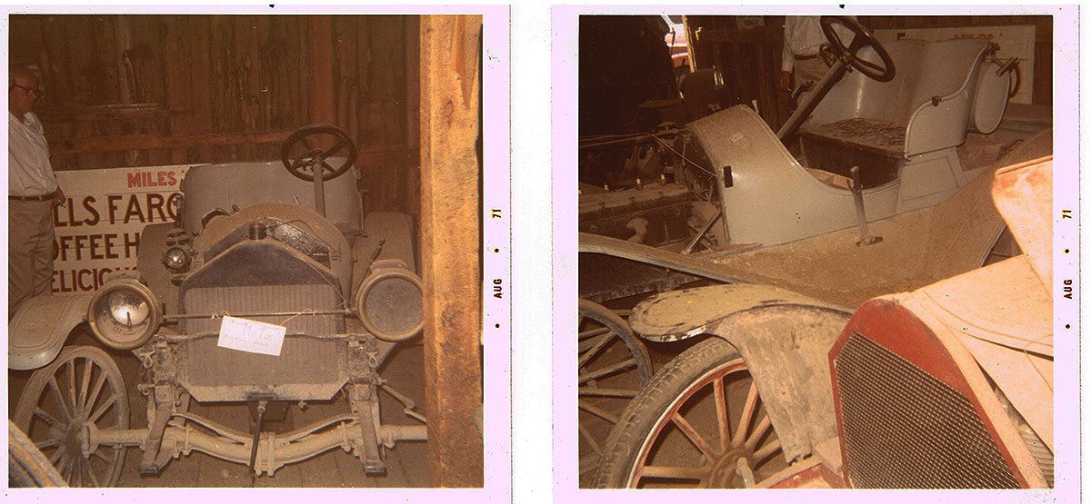

Richard you remind me of a man called "Pop" Rice. That is going back a ways. Does anyone remember hearing about him?

Hi Herb. I had to go check. A 1969 CAR Classics had an article on a "Pop" Burnside. I thought it might be him until I read the name. He was an old school Blacksmith who built an 1893 "Velo" from scratch. (In his eighties) Several other projects including a complete Oldsmobile limited body. Now I realize how much influence the old timers had on what I do. They seemed so much bigger that life at the time but now I realize they were just regular guys like us doing what they enjoyed doing. Perhaps some of the bright young folks will find inspiration by things they see on these forums.
Thanks for taking my feeble mind back to that.

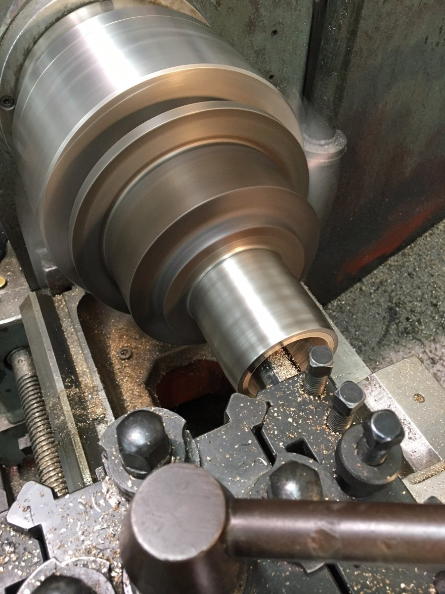

John, I think you would agree that part of the magic is being able to find the right materials to work with. I searched high and low to find some sheet the right thickness for the latch plate. I finally found it in the "For Scrap" pile I intended to take to the scrapyard some day. It was an odd thickness.
While I'm thinking Maxwell I needed a tubing size (7/16 OD X 5/16 ID). A sleeve for the magneto linkage fits over the throttle cross shaft. The original had rusted solid and no heating soaking or pounding had freed it up.
A simple item to find? No. I went to every shop and supply house and it was not to be found. I went online and could buy 200 ft of it but not a short piece like I needed. As luck would have it I has rescued some tubing from a former job and used it for wire conduit for my racer. (We were hard on head and tail light wiring). It was the perfect size and a 5/16 rod fit nicely inside of it. Keeping stuff around has saved my bacon so many times.

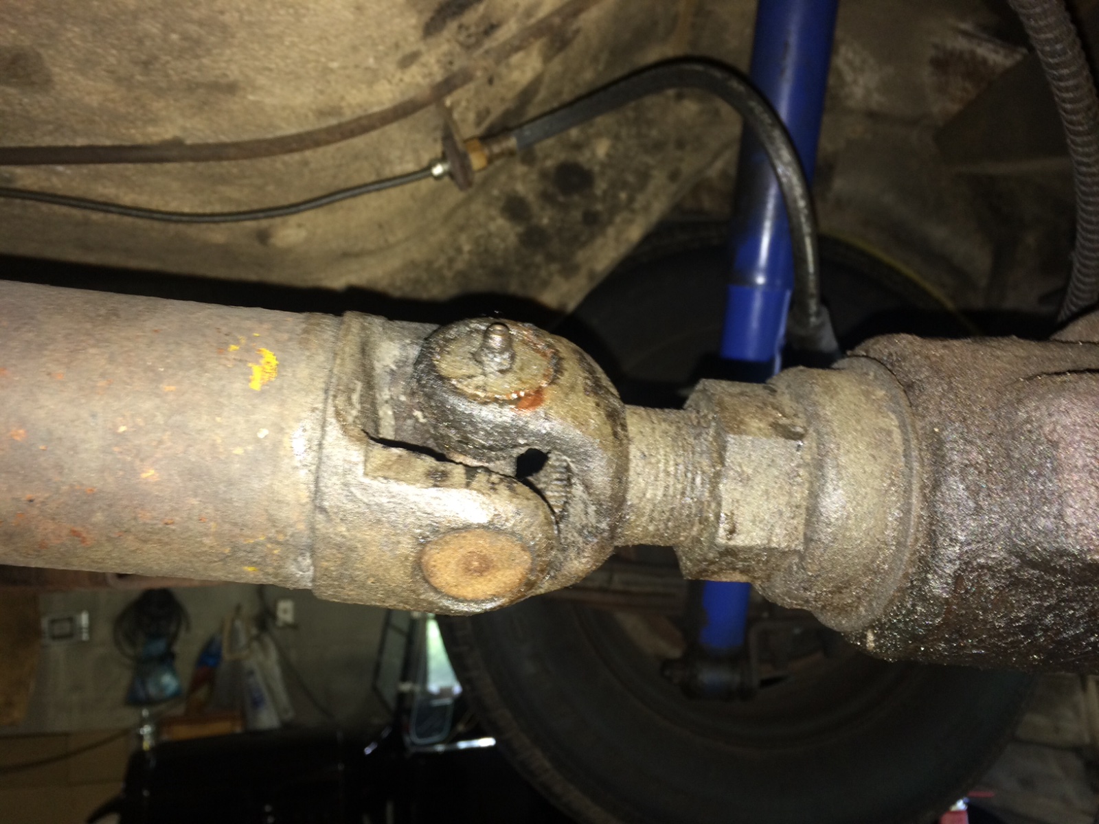

I hate, loathe and despise bleeding brakes on my old truck. It seems a leaking wheel cylinder allowed all the fluid to drain out of the master cylinder. With some vehicles that's not a big problem. You just fill the reservoir and pump the pedal until all the bubbles are out of the line. Not so with this beast. Once the master cylinder runs dry, getting fluid back into it is the job from Hell. I was finally able to get fluid flowing again by applying air pressure to the reservoir with a shop vac. Tomorrow I'll buy a new ground cable and hope that has me ready to get some yard work done.
Dennis Prince
- Posts: 413
- First Name: Dennis
- Last Name: Prince
- Location: Madras Oregon
Re: What have you done on an old non-Model T vehicle.
Steve, on a vehicle that is hard to bleed like that, you can push fluid through the bleeder and fill the system one wheel at a time. Start at the furthest wheel and work your way to the closest. It pushes the air up into and out of the master cylinder. This can be used if you have to mount the wheel cylinder upside down for what ever reason.
dlmyers
- Posts: 156
- Joined: Sun Jan 06, 2019 6:00 pm
- First Name: Dale
- Last Name: Myers
- Location: Greenville
Dennis, thank you for that information.
