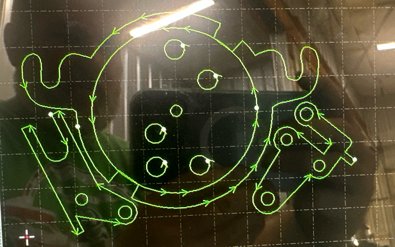

The Laser metal cutter is FIXED! I had to order replacements for several burned out parts in the servo control board, but this old man has't lost his touch when it comes to fixing power supplies...
Cutting parts today and tomorrow. Here are some pretty cool Videos of the laser metal cutter in action. Its cutting 16 gauge test parts but is capable of cutting up to 1" thick.

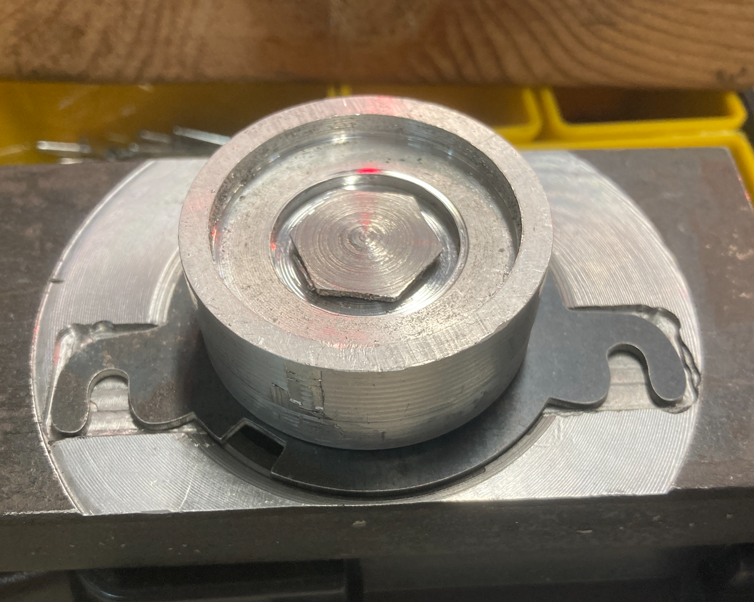

Its been 10 days since my last update and huge progress has been made. I got the cutout bases formed and Zinc plated today. I picked them up from the laser cutter and had a helper here today and was able to complete 100 of them in 2 hours. I finally upgraded my press with air actuated hydraulics - what took me so long to do that????
Deep draw die tooling I made.
. This forms the base of the cutout can. This was by far the most complicated part of all this. it's an odd shape, but I nailed it. Unlike "other" cutouts, mine slides onto the generator nut and the 2 mounting screws perfectly. I must have put 100 hours into getting this part exactly right. The original Ford cutout top fits over it and has a nice snug interference fit. I also got a spot welder to fully secure it, and that also works really well. (I STILL need more old cutouts!)

That looks great!
Is the V cutout to help in the metal forming process?

The “V” bends up and is used for the ground connection.
