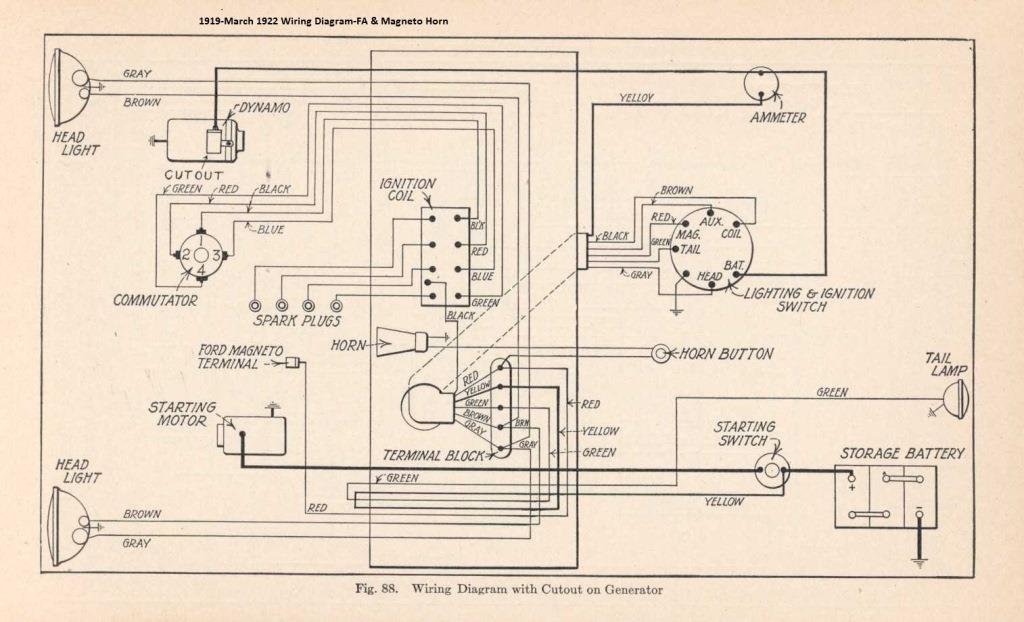

Have been trying to get ahold of Jeff on this.... (left a few messages). Maybe he is out of the office this week?
I purchased a 12v voltage regulator... it looks really nice!
I got it mounted properly, but I can't seem to locate a wiring diagram to know exactly where the inline fuse is supposed to be installed? It does mention a couple locations.
The brochure shows it with a blue wire, but I not really wanting to risk the installation incase his photo isn't using the same blue wire I have.
It is odd there are not any installation instructions on their website either.
Anyone have some photos or diagrams of where the fuse is supposed to be installed at?
I'd rather not blue smoke anything from assuming.

Post by AdminJeff » Tue Sep 23, 2025 5:39 pm
Ben, I'm sorry... on infinite hold with Fedex.
you insert the fuse wherever your car takes is main power from. on some cars its the starter foot switch (thats how it was originally wired).
On others it comes from the positive terminal of the battery.

Has there been any issues with the wire provided being too small to sit between the starter switch? My starter wire is pretty thick gauge. I suppose I could upgrade the inline fuse to something used in car amplifiers.
So just to clarify, we are supposed to cut the wire coming from the starter switch to the starter and place the inline fuse there?

cut the smaller wired attached to the foot switch.
I have a fuel pump, phone charger, distributor and other accessories and never see more than 6A of draw. I include a 20A fuse. more than enough.

Post by Ron Patterson » Tue Dec 23, 2025 12:18 pm
The Ford starting and lighting system is a 20 amp system and should be fused for 25 amps.
The circuit where the fuse goes is a #12 yellow wire.
Here is a diagram depicting in the notes
where the fuse should be wired into the curcuit.

Post by Ron Patterson » Tue Dec 23, 2025 12:21 pm
Sorry, belay that. Wrong diagram.
Here is the correct version.
