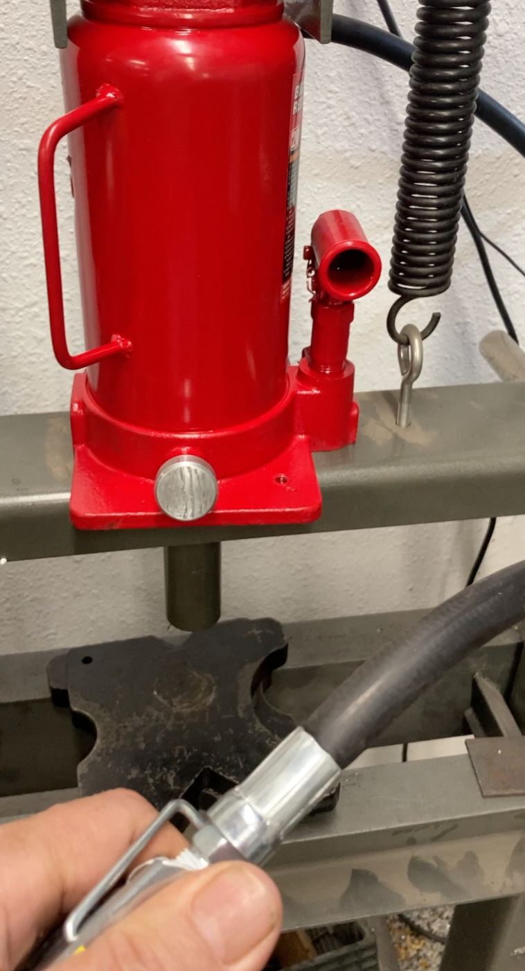

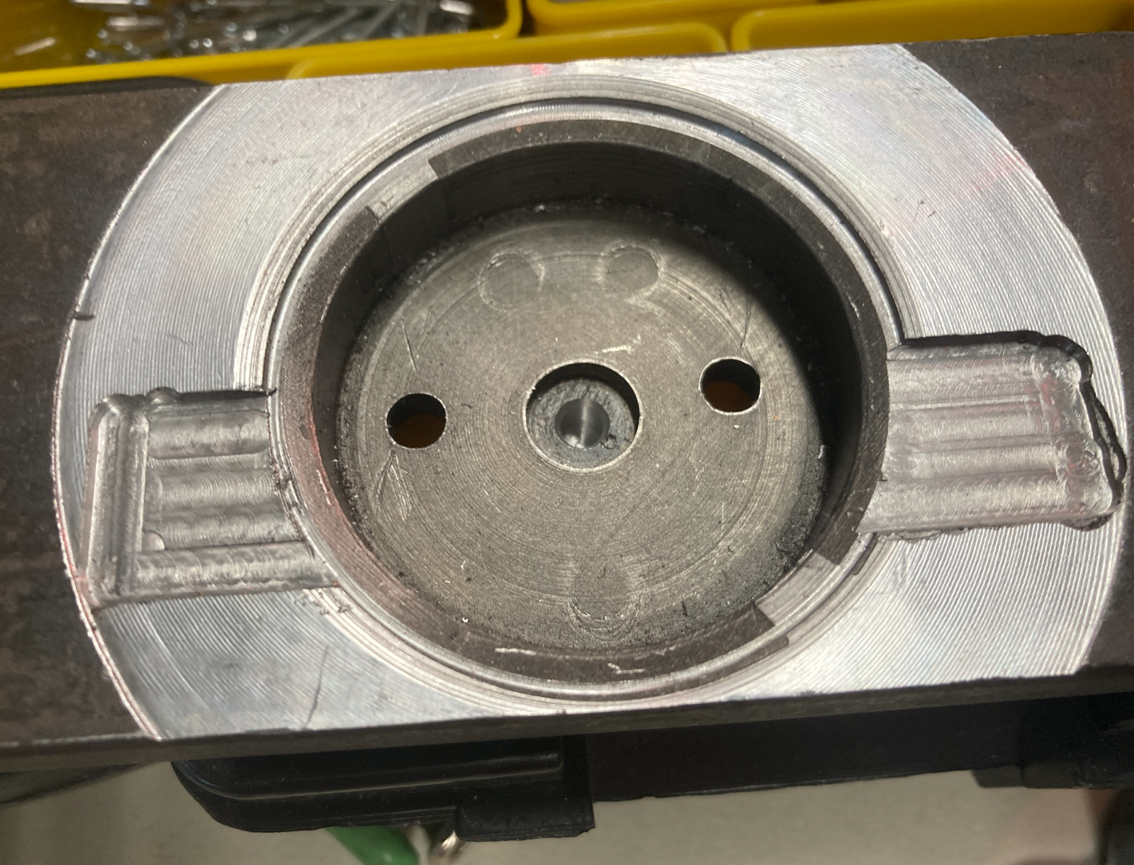

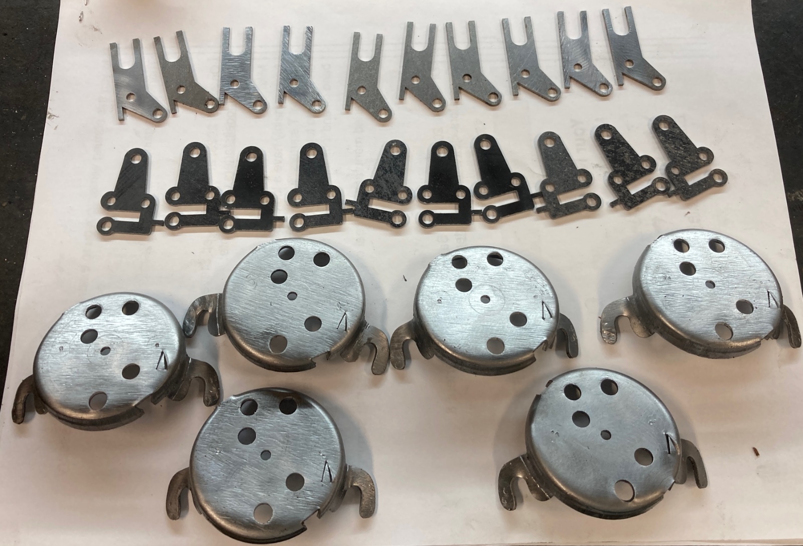

Its been 10 days since my last update and huge progress has been made. I got the cutout bases formed and Zinc plated today. I picked them up from the laser cutter and had a helper here today and was able to complete 100 of them in 2 hours. I finally upgraded my press with air actuated hydraulics - what took me so long to do that????
Deep draw die tooling I made.
. This forms the base of the cutout can. This was by far the most complicated part of all this. it's an odd shape, but I nailed it. Unlike "other" cutouts, mine slides onto the generator nut and the 2 mounting screws perfectly. I must have put 100 hours into getting this part exactly right. The original Ford cutout top fits over it and has a nice snug interference fit. I also got a spot welder to fully secure it, and that also works really well. (I STILL need more old cutouts!)
Zinc - I'm very happy with the final result - I got a "Copy Cad" kit from Caswell Plating Co. to do just enough of these to fulfill the orders I have now. Next up is the battery and generator tabs laser cutting tomorrow and then zinc plating those. The other 1000 sets will get sent to MI for Zinc plating. I found a really good and very reasonable outfit that will do all my plating work at scale.
Uline Shipping boxes and Brother Postage label printer arrived today and I just shipped all the orders I've gotten for plain cutouts (I had enough parts from all my test cuts to build those). I must say, that felt good!

That looks great!
Is the V cutout to help in the metal forming process?

The “V” bends up and is used for the ground connection.

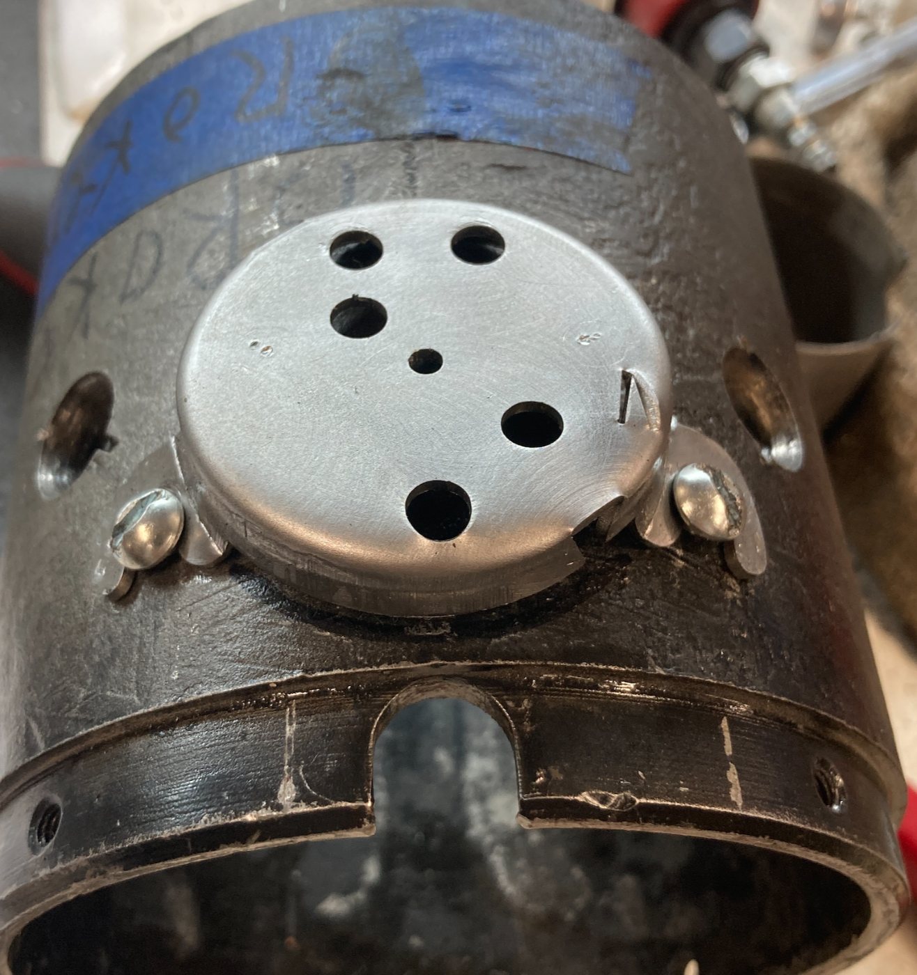

update: All cutout enclosure parts are cut, formed, and the Zinc/chromate plating is finished using the Caswell Plating kit for the first batch of 50 cutout enclosures. I just mailed off 450 additional sets of bases, generator and battery tabs to be Zinc plated by a commercial outfit in MI. I'd be here plating for a year if I had to do all 500 myself.
Tomorrow I'll finish putting the circuit board on the base, testing them and then packing and shipping them. I will likely get the first dozen shipped tomorrow. The rest on Friday.
Its been quite a journey, and the light at the end of the tunnel keeps getting brighter. I severely underestimated just how much work it would take to replicate the Cutout enclosures. Breaking it down into manageable tasks really helped. Thankfully all that is mostly behind me now.
