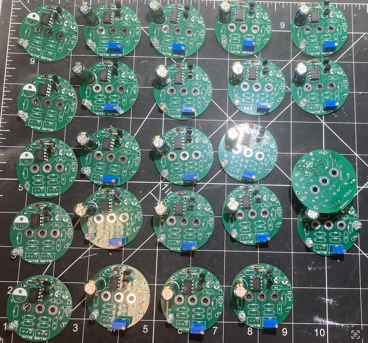

All of the above. You start with a schematic, turn that into a circuit board, get them produced offshore and in this case I populate the boards. At some point I'll be converting to SMD (SURFACE MOUNT) and then have the fab house produce them.Jerry VanOoteghem wrote: ↑Thu Aug 17, 2023 2:24 pmCurious... As someone who has zero experience in this area, how does one go about making, or having made, circuit boards such as those? Do you design the board, then have a company produce the boards for you? Do you solder each component to the board yourself, or does it come supplied that way?
The REALLY exciting news is I just got back from the laser cutting guy and pressed my first set of bases. They literally came out perfect. The old Ford Cutout cans fit perfectly. This is a VERY challenging part to reproduce. The angles are complex, and everything has to line up just right. I must have made a dozen changes to the deep draw die set I made.
Tomorrow I'll be cutting a few hundred copies. There really is light at the end of the tunnel, and it's a looong tunnel!

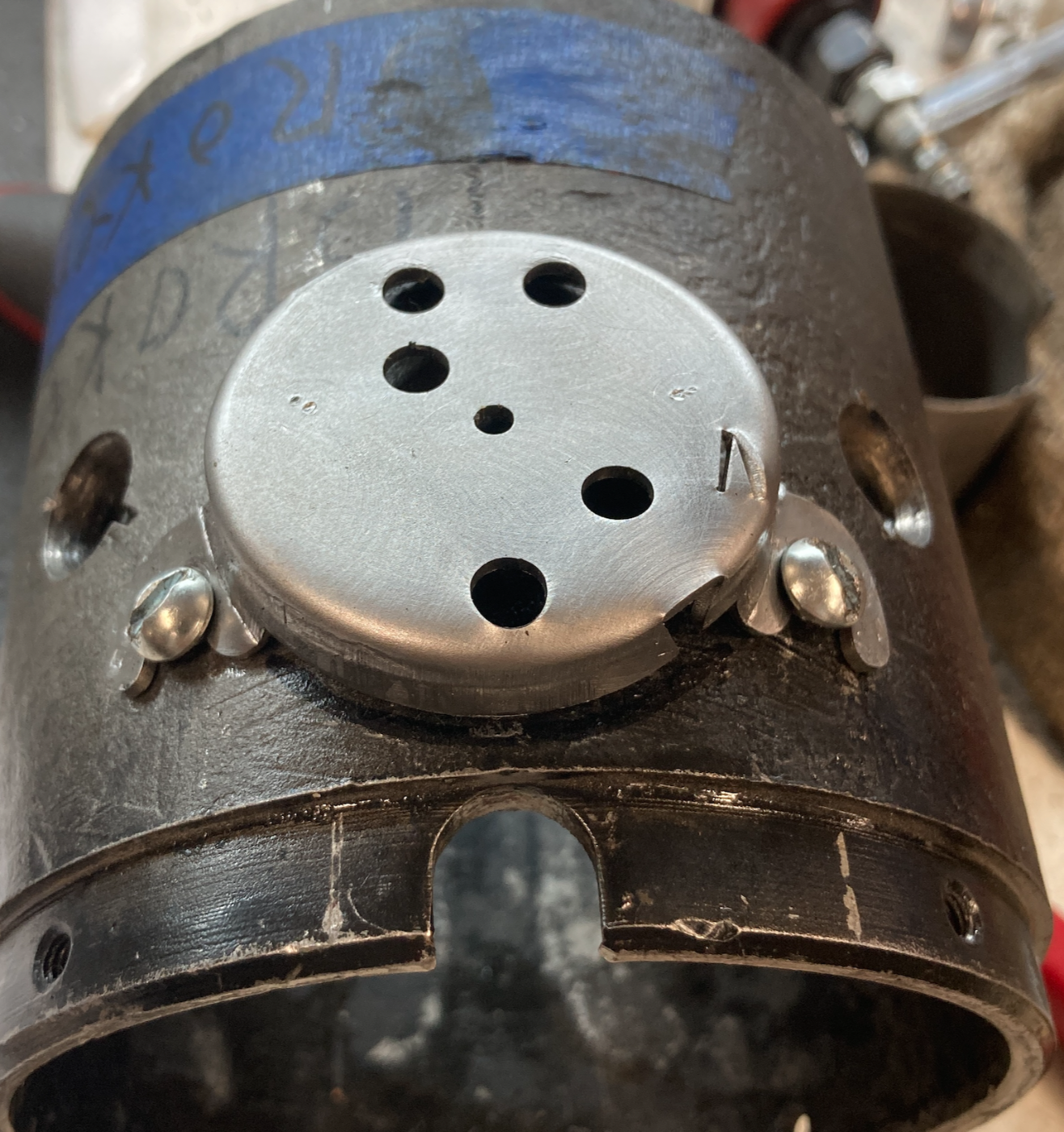

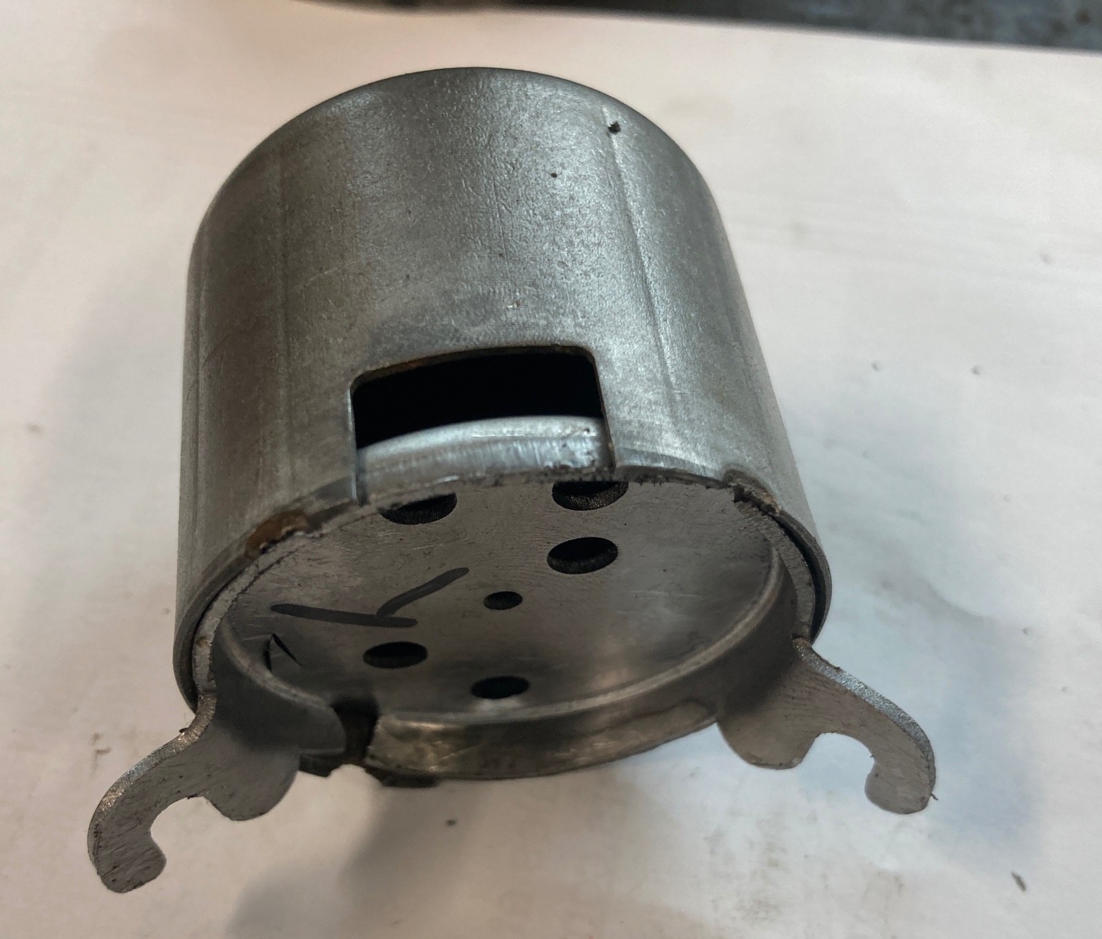

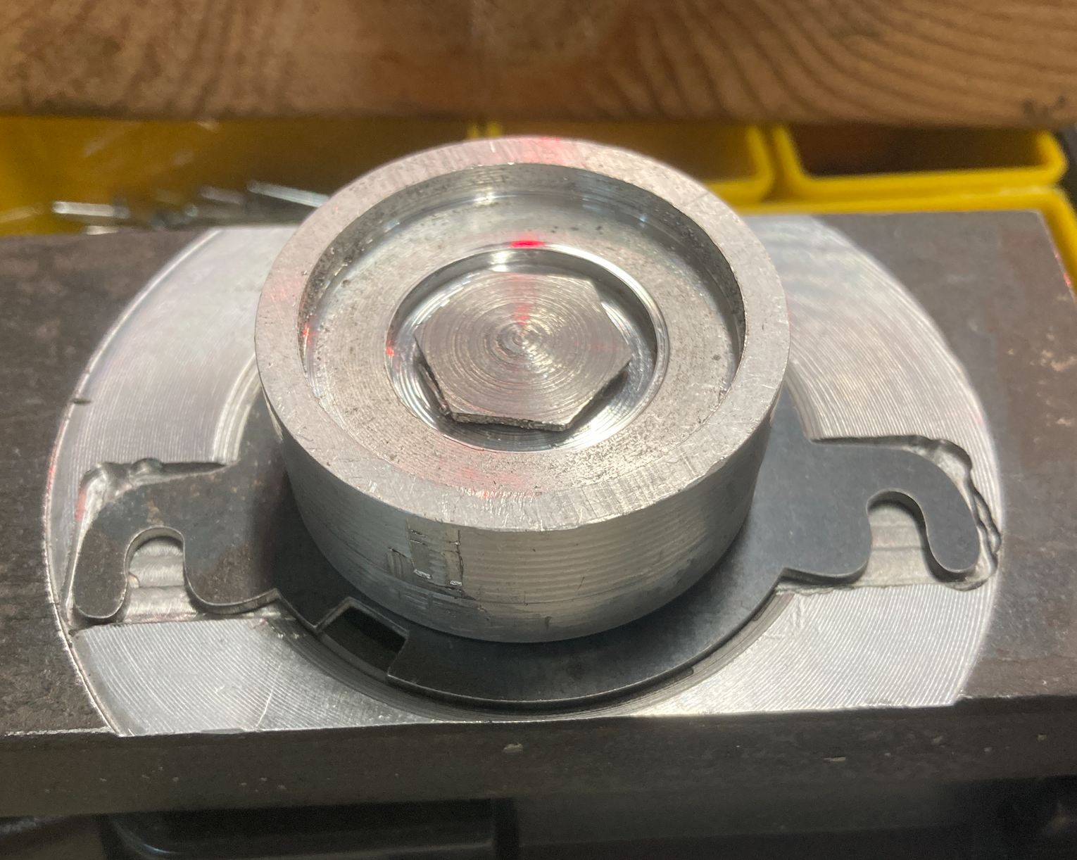

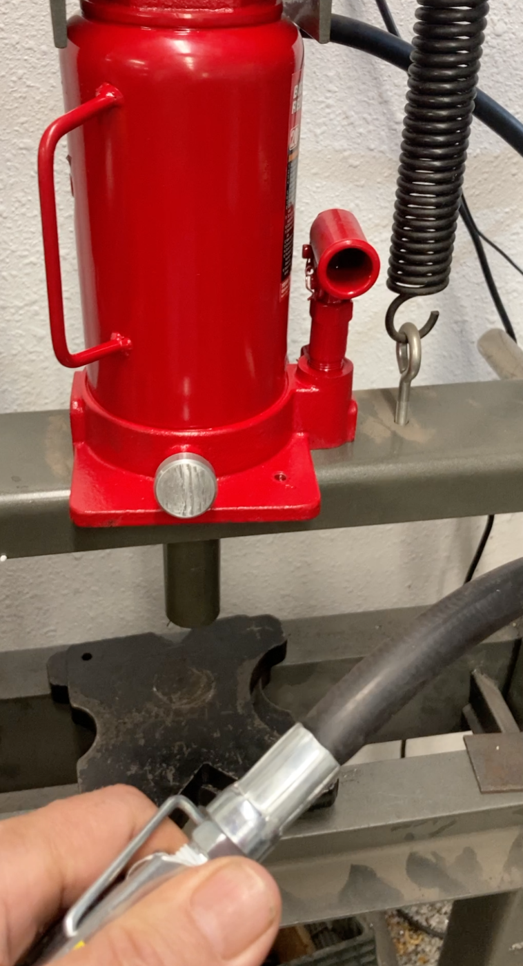

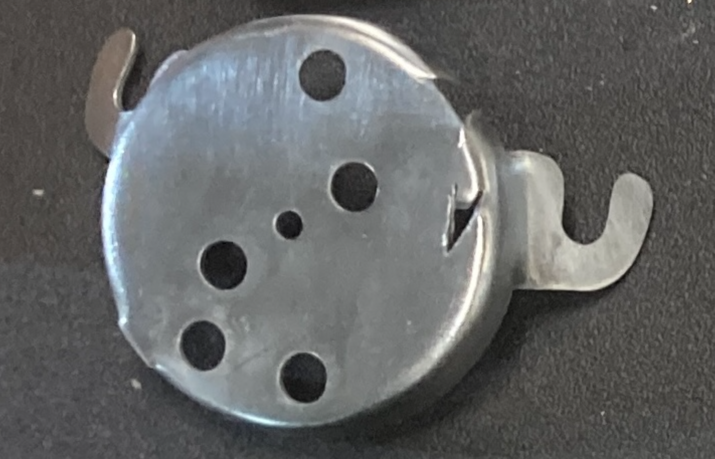

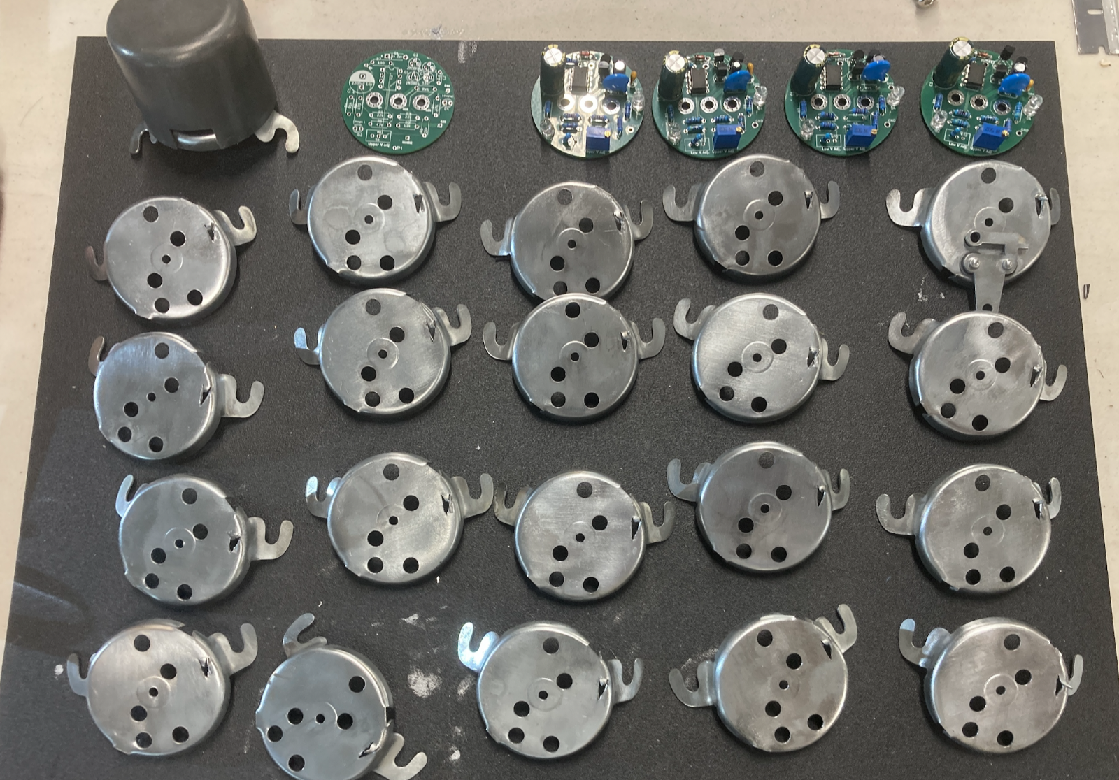

Its been 10 days since my last update and huge progress has been made. I got the cutout bases formed and Zinc plated today. I picked them up from the laser cutter and had a helper here today and was able to complete 100 of them in 2 hours. I finally upgraded my press with air actuated hydraulics - what took me so long to do that????
Deep draw die tooling I made.
. This forms the base of the cutout can. This was by far the most complicated part of all this. it's an odd shape, but I nailed it. Unlike "other" cutouts, mine slides onto the generator nut and the 2 mounting screws perfectly. I must have put 100 hours into getting this part exactly right. The original Ford cutout top fits over it and has a nice snug interference fit. I also got a spot welder to fully secure it, and that also works really well. (I STILL need more old cutouts!)
Zinc - I'm very happy with the final result - I got a "Copy Cad" kit from Caswell Plating Co. to do just enough of these to fulfill the orders I have now. Next up is the battery and generator tabs laser cutting tomorrow and then zinc plating those. The other 1000 sets will get sent to MI for Zinc plating. I found a really good and very reasonable outfit that will do all my plating work at scale.

Is the V cutout to help in the metal forming process?
AdminJeff
Re: Voltage Regulator Building Progress Update
The “V” bends up and is used for the ground connection.

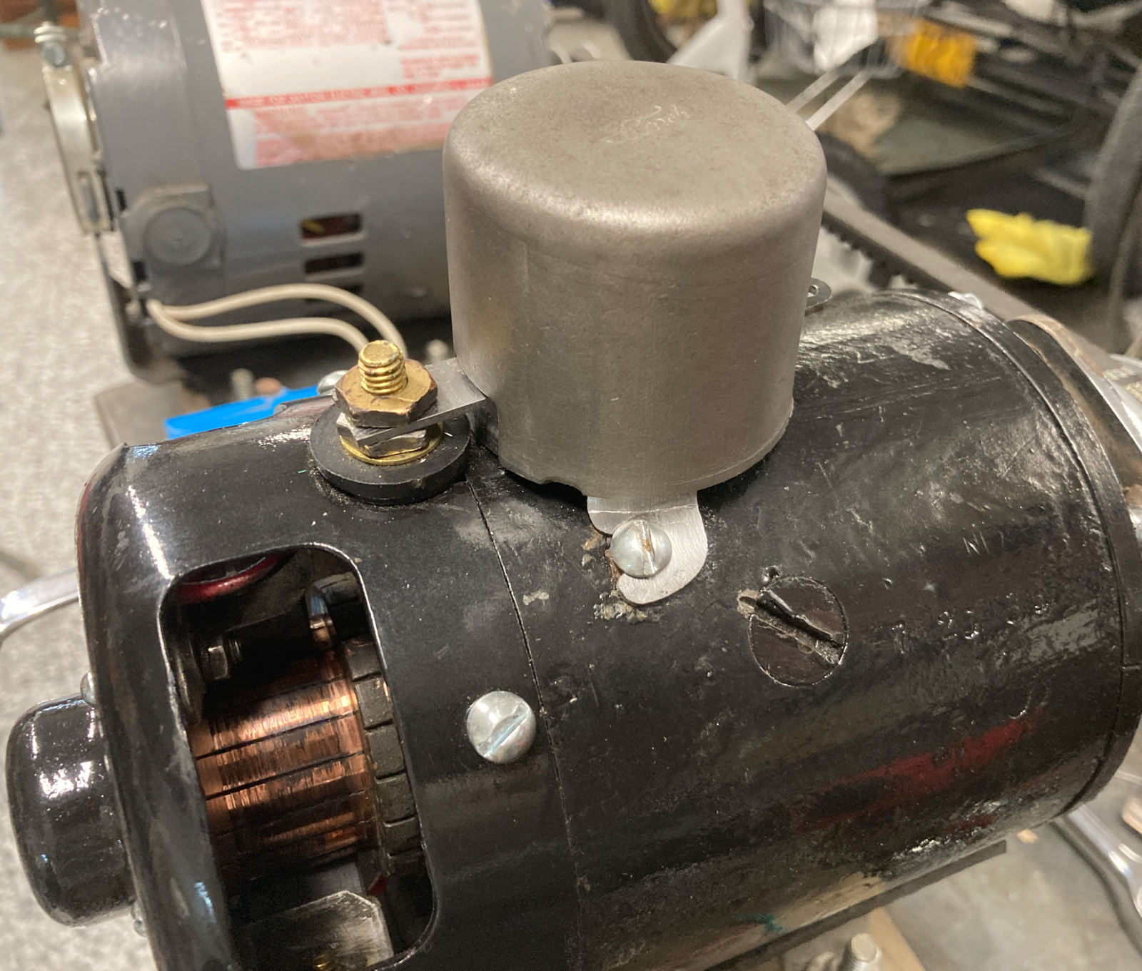

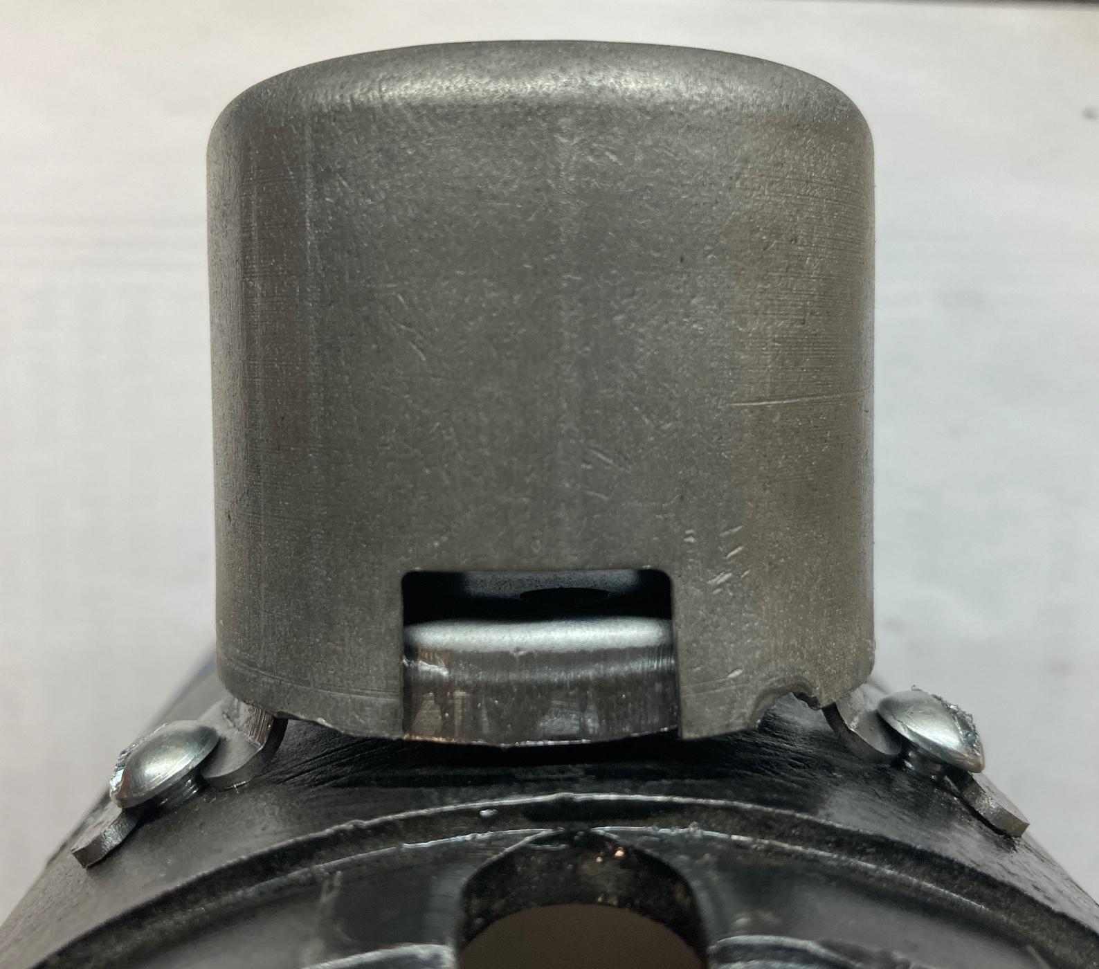

update: All cutout enclosure parts are cut, formed, and the Zinc/chromate plating is finished using the Caswell Plating kit for the first batch of 50 cutout enclosures. I just mailed off 450 additional sets of bases, generator and battery tabs to be Zinc plated by a commercial outfit in MI. I'd be here plating for a year if I had to do all 500 myself.
Tomorrow I'll finish putting the circuit board on the base, testing them and then packing and shipping them. I will likely get the first dozen shipped tomorrow. The rest on Friday.
Its been quite a journey, and the light at the end of the tunnel keeps getting brighter. I severely underestimated just how much work it would take to replicate the Cutout enclosures. Breaking it down into manageable tasks really helped. Thankfully all that is mostly behind me now.

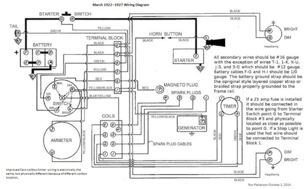

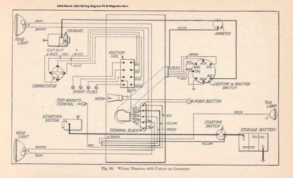

The Ford starting and lighting system is a 20 amp system and should be fused for 25 amps.
The circuit where the fuse goes is a #12 yellow wire.
Here is a diagram depicting in the notes where the fuse should be wired into the curcuit.
Ron Patterson
- Posts: 59
- Joined: Tue Apr 22, 2025 6:11 pm
- First Name: Ronald
- Last Name: Patterson
- * REQUIRED* Type and Year of Model Ts owned: 1915 Runabout
- Location: Petoskey, Michigan
Sorry, belay that. Wrong diagram.
Here is the correct version.
