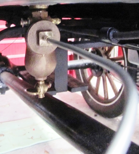

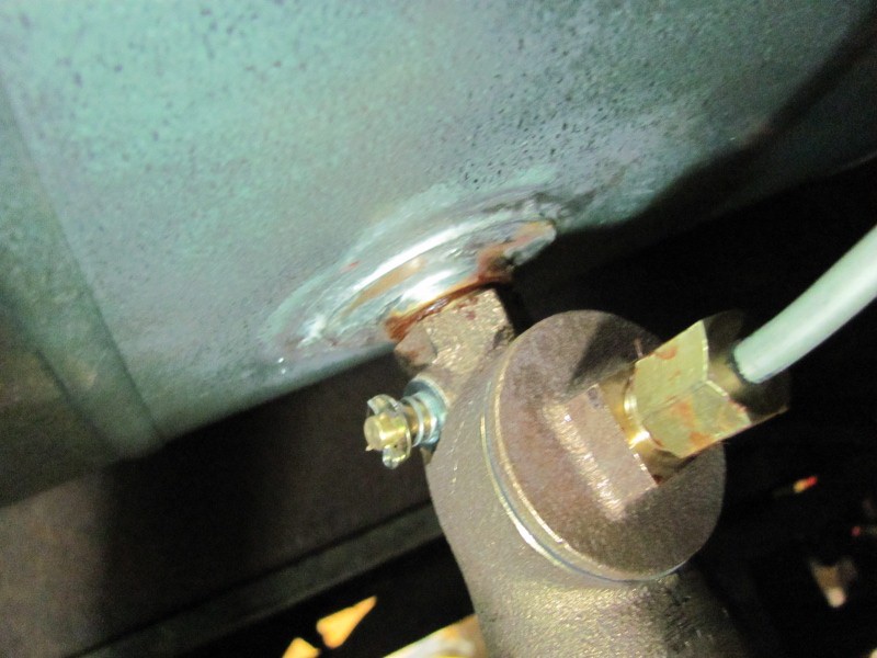

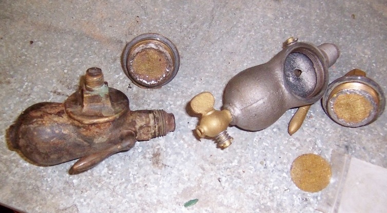

Re the sediment bulb, no torque, those are tapered pipe threads! Results for me are with Permatex sealer for the threads, gas resistant, all pipe threads use some dope in plumbing, you'll want a gas resistant version.
If the bulb is old, you have to take it apart and clean or replace the screen in the large nut. Tricky to remove, heat the iron around the nut and the lever arm with a torch, then place the assembly in the freezer. The brass will shrink from the iron and you'll remove the nut and lever without damage.
Or, replace with a new reproduction bulb, they are nice.

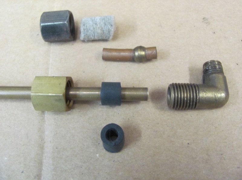

For the gas line, use steel tubing, auto store, brake line. Bend and then cut to fit. Cut so you have a bit of steel line going into the inlet elbow too, it secures best that way, then tighten the pack nut to compress. Use the factory pack nut, but substitute neoprene gas line segment for the factory felt. Then the gas nut will compress the neoprene gasket and no leaks, and no worry of fracture from compression fittings. The T really shakes and rolls, you'll find the factory pieces are made to do the job.
Top: Ford felt
Center: Poor replacement, copper tubing and compression ferrule used in a Ford pack nut, note the tubing is stressed already.
Bottom: Ford pack nut, steel line, and modern gas line neoprene segment cut to replace the Ford felt.

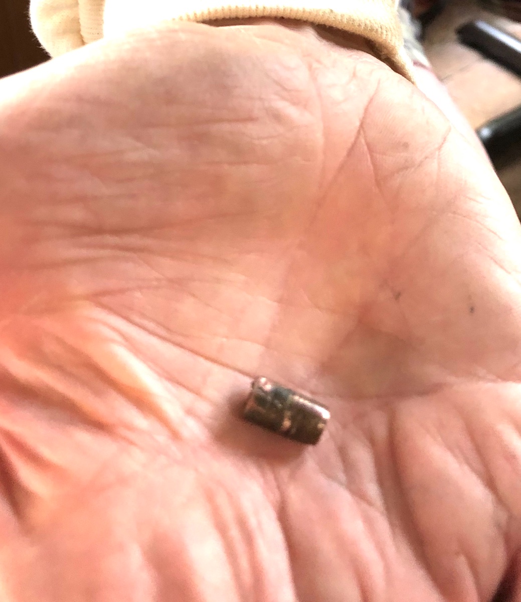

And this copper line with compression fitting cracked right at the end of the compression fitting, on a T on tour, causing owner some grief.

Permatex on threads of sediment bulb only.

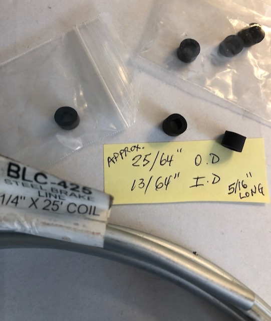

For the segments of fuel line to replace the old time felt, you may have to determine that with what steel brake line you get. I used 1/4" size steel brake line.
Lang's makes the neoprene fuel line packing, in the online catalog or order # 2913N. I use their part because it always fits fine, tight push over the 1/4" line and when the pack nut chamber closes on the neoprene, it expands and seals great. Can be reused and reused when you pull the carb, and have to remove the gas line.

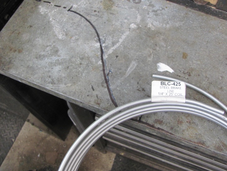

Thanks Dan, I appreciate the insight. I've ordered the neoprene packings from Lang's, and intend to use them instead of the felt ones. Did you utilize any special tools to work the steel gas (brake) line into the correct shape? I'm sensitive to the possibility that in the process of uncoiling it and routing it, it may kink, bringing me back to square one. I see there are straightening and bending tools for steel brake tubing on the market, but am not sure how many one time use tools I want to invest in to do this job...

The brake line is rather soft, so didn't need much bending tools, as the bends for the open car chassis I'm used to plumbing are fairly easy with bare hands. You do need a tubing cutter to make clean ends.
Laid out the bending guide from a package insert that comes with Lang's straight length of tubing, so I had a copy and followed it by marking on my bench the bends needed. Then shaped to the layout on the bench top with my roll of store bought brake line tubing.

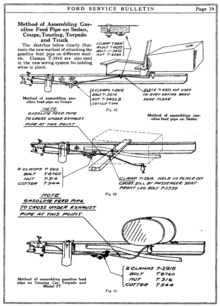

Your sedan tank under the driver's seat would use a bit of different bends, as shown in Ford Service Bulletin.

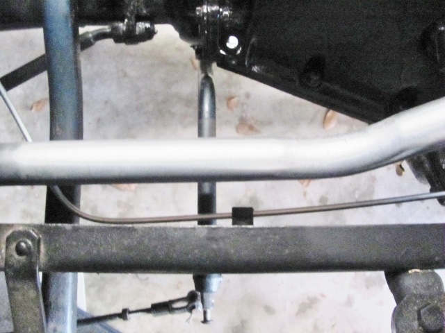

Dan Treace- Once again, THANK YOU. Does anyone have photos depicting the fuel line routing for a sedan? Should I be insulating the line with anything where it comes closest to the exhaust pipe?
Posts: 5591
Re: Advice Wanted - Center Door Sedan Gas Tank Replacement
Post by RajoRacer » Mon Jun 01, 2020 11:05 am
The proper routing is illustrated in the center diagram that Dan posted. If'n I get time today, I'll roll under our '19 Centerdoor and take a photo for you.

Here is open car, factory route, the gas line tucks under the exhaust pipe for only a very short length, no need to wrap.
Plenty of cooling air travels thru those spaces when on the road.
Some pass the gas line thru the notch in the wood block inside the frame rail and crankcase arm, but for the later N-H carb, going along the outside of the crankcase arm works well too. Is important to use the gas line clamp at the front bolt for the the control shaft. Keeps the line in place, away from exhaust pipe, and strain on the fittings at both ends.
