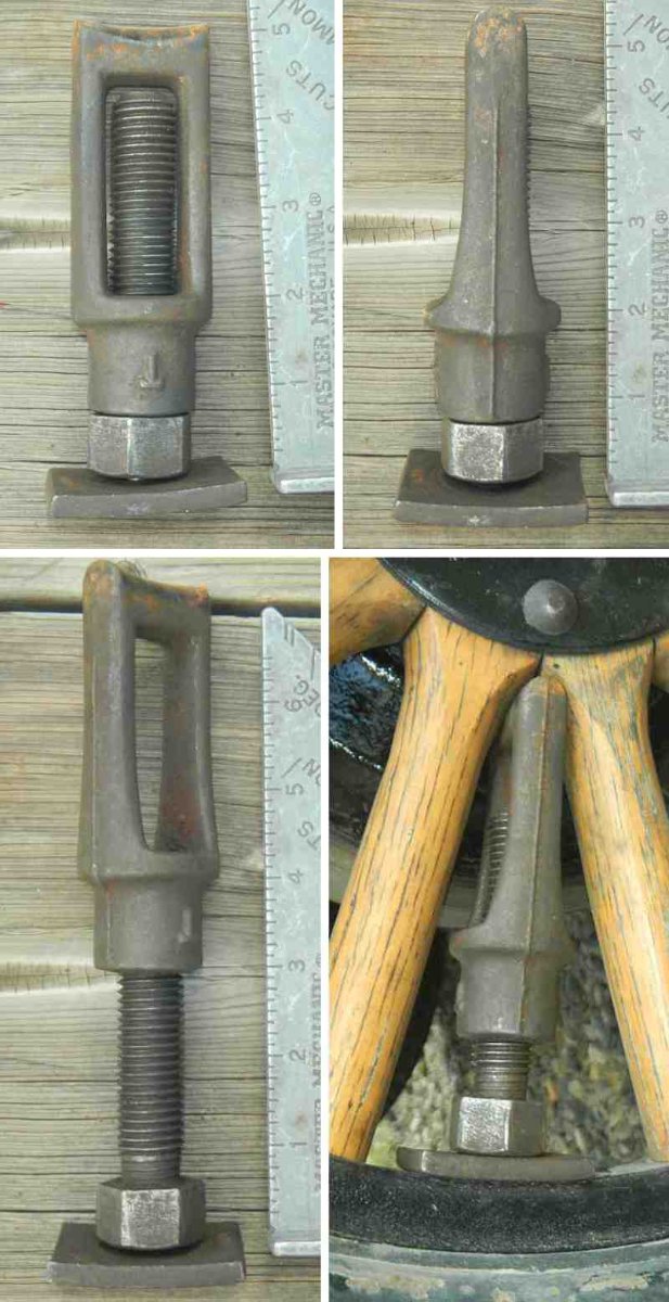

Terry- spoke jack? How about some photos of the tools and shims you use? I have steel felloes and demountable rims. My spokes are tight but I’d like to learn more for when I do have problems.

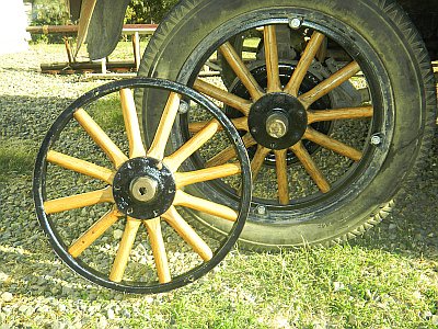

Update on my original post: I agree that I needed to do something about the offending wheel so I decided to replace that wheel with a very good spare one that came with the car when I bought it. The "new" wheel has good, tight spokes all around and I sure feel better now that I have replaced the first wheel. FYI: When I pulled the hub from the bad wheel all the spokes just fell out loose on the floor. Sure appreciate all the good suggestioins. I'll see if I can come up with some creative, artistic use for the old spokes and rim. Thanks

I suggest keeping all the parts of that wheel You are now set up for proper shimming as I discussed.

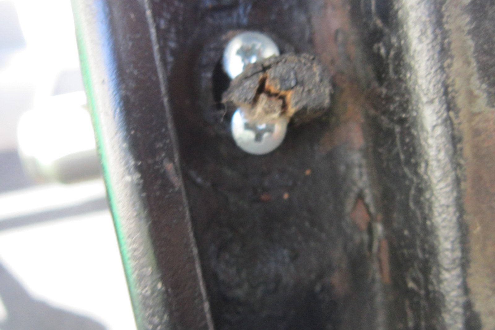

Here's how a previous owner of my 1920 T chose to "fix" the problem of loose spokes on a rear wheel. I opted to have all four rebuilt upon discovering this quite unexpectedly.

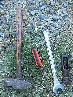

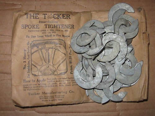

You can see how often I review old forum pages. I just saw the above message from Tim. Tim is a great guy who just gifted me with the upholstery he removed from his car... Rusty will proudly wear those seat covers...THANKS TIM!!!
Tim requested spoke jack tool photos so I have dug some up.
I also have a piece of rubber sheet in my tool box I put between the spokes and the jack to protect the spokes.
I use the hammer and the screwdriver for pushing the shims to place.
These are shims available in the '20's and '30's. If you find washers thin enough you can easily make your own ... 1" washer with 1/2" hole is ideal. I have also cut them from shim stock. When you are stacking washer shims on all spokes you should think about spoke replacement.
Sorry I took so long in doing this!
TH
