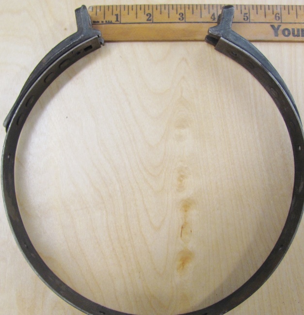

Posts: 4081
Re: Problem Installing Transmission Cover
Post by DanTreace » Mon Jun 08, 2020 6:19 pm

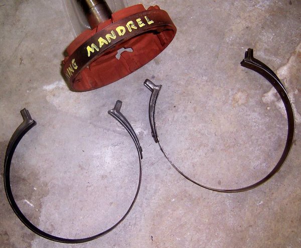

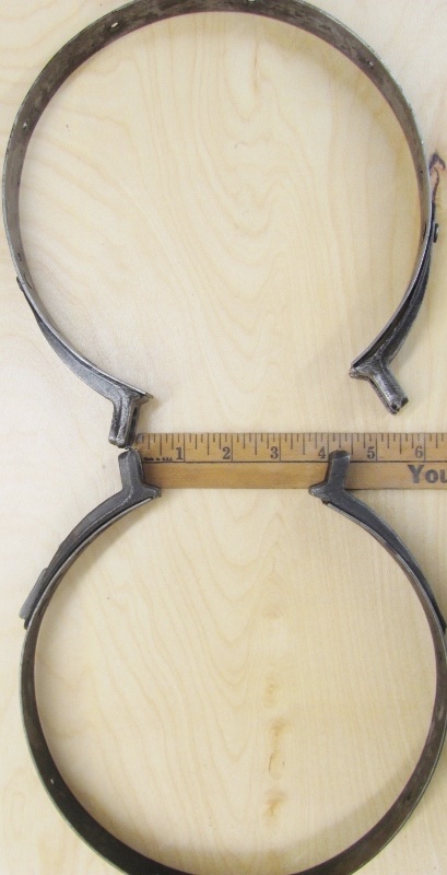

First check that you fixed any out of round band. The proper way is to bend over a dia. of a drum or something and get the circle round so that before you re-line the band, the lugs are approx. 3 1/2" to 4" apart. That ensures you have round bands.
Bands that are not ready for re-lining, note how wide apart are the lugs.
drum mandrel for bands.jpg (109.67 KiB) Viewed 9034 times

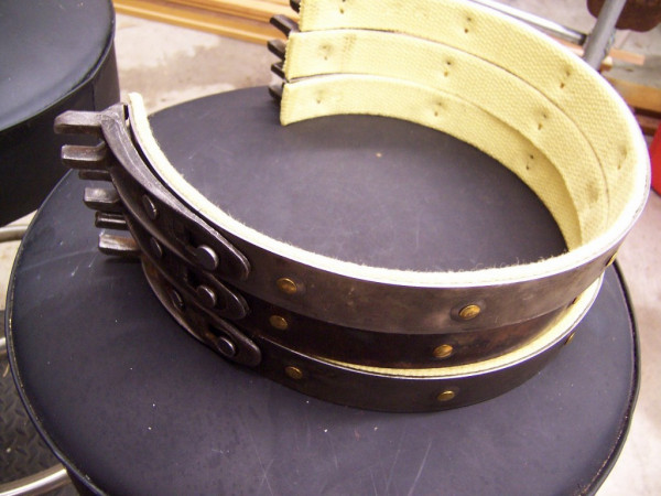

These are ready

The pictures of the bands not ready and ready for lining are very helpful. I didn't check for this at all and it may be the problem. I think that the bands had a lot more space between the ears before lining than the recommended 4 - 41/2 although I didn't measure that. At this point it seems that I should remove the lining I installed and start over. with new lining. Since I do not have any old drums to use as a mandrel is there anything that I could use instead ? Does anyone know what the actual drum diameter should be.

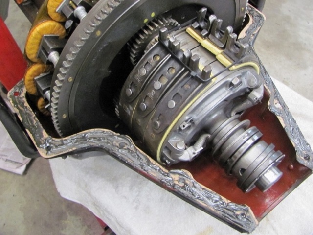

Posts: 4081
Post by DanTreace » Tue Jun 09, 2020 9:45 am
Bill
The transmission drums are 7 1/2" in diameter. The shape of the band does impact the way the lining grips, so yes, I try to get the steel bands into shape by wrapping around a drum, and tapping with a ball pein hammer to get the band as round as possible, that ends up with around a 4" gap at the ears.

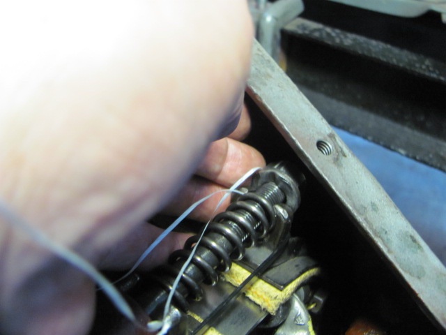

Since you have them re-lined, should be able to fit them anyway. Check first that none of the bands are riding on each other's edges, and they wrap pretty straight around the drums. Then use Vise Grips or some means to draw the ears to appro. 4". As you said that breaks the wire, go with heavy plastic type straps, the thicker ones. I use two, as the length isn't enough, so I loop two together. Those straps are tough. Should hold.
Then when you get the hogshead on, clip the plastic to withdraw. If a tiny piece should fall to the crankcase, its only plastic and not steel wire, so injury to the gears is so minimal if any.
Band ears wrapped in plastic wire ties
Finally, when you fit the nuts over the pedal shafts, use methods to keep from dropping a washer or nut! Some like to place the springs and washers and nuts on the reverse and brake shaft prior to fitting the hogshead, so all is done in one placement. That works, but normally I like to do the springs, washers and nuts separate.
Dental floss to keep from losing stuff into the abyss!
Then with the hogshead seated, BUT not bolted in place, remove the plastic tie wraps.
Then proceed to completely seat the hogshead to do the final bolting, BUT, also fit the inspection cover with a couple of screws before you grab a handful of bolts and nuts for the crankcase to hogshead! You don't want to drop those either!

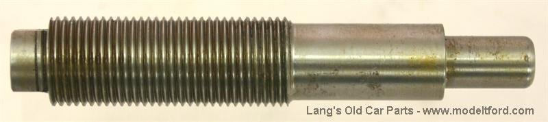

Post by Scott_Conger » Tue Jun 30, 2020 11:58 am
You can mess with that, as it looks like someone made a stub to go into the hole of the original (now incorrect) adjuster bolt. Or buy this:
from here: https://www.modeltford.com/item/3419B.aspx
