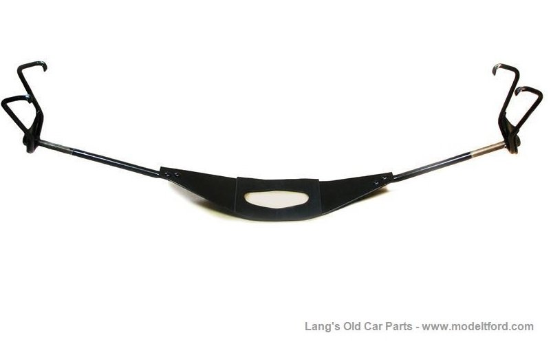

For us new people, what the heck is a belly sling?
But if Tim makes them I probably want one!
- Posts: 6542
Re: Pad for belly sling?

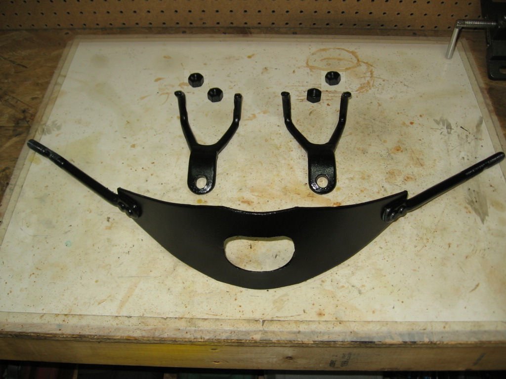

This is a belly sling. Hooks onto the frame's side rails. Lang's sells them. Padding with a sheet of neoprene wouldn't be bad idea.

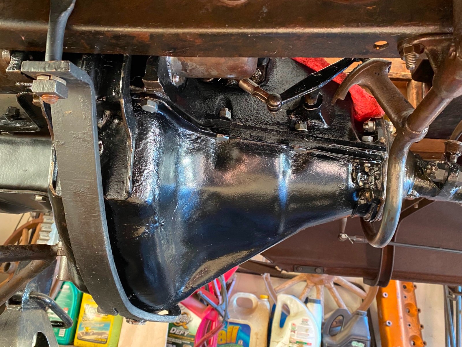

Here's the one on Betsy, my 1924 cut-off touring. I installed it because one of my pan ears had a weld repair and I wanted extra support in case the weld ever failed. Note how the nuts firmly clamp the hooks onto the threaded rods to prevent relative movement that can cause the hooks to rub a groove into the rods over time.

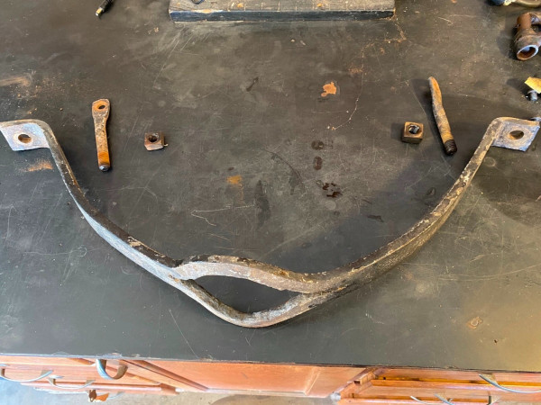

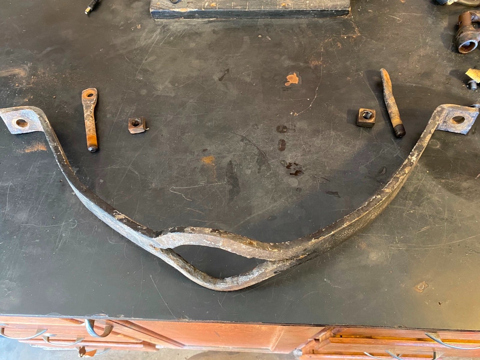

My parts chassis came with a homemade belly sling. The chassis was last used as a car in 1961 and the by the looks of it, the belly band was in place for a very long time before then.
It's pretty crude looking visually but very solidly engineered and easy to install. And, since my aim has been to return my 24 Touring to how it may have looked during the tough days of the Depression/WW2, this homemade sling fits right in. It and the attachment bolts look like they were made by someone like my Papaw (my dad's dad). He had enough blacksmithing skill to make things he needed on the farm and make them solid and dependable but he didn't have enough skill to make them pretty.
Look at where they split the band in the middle to make access to the oil drain plug. Dang...it's pretty roughly done...but I think it's a pretty safe bet that whoever made this back in the day, didn't care one whit about what it looked like. He probably had a cracked oil pan arm that he'd just welded up and was making and installing the belly band to prevent it from happening again. (For what it's worth, the engine that this belly band was supporting did have a cracked and repaired arm.)
I don't know exactly how far I've driven it since the belly band installation, but it's not an insignifant amount and I haven't noticed any need for a pad.
