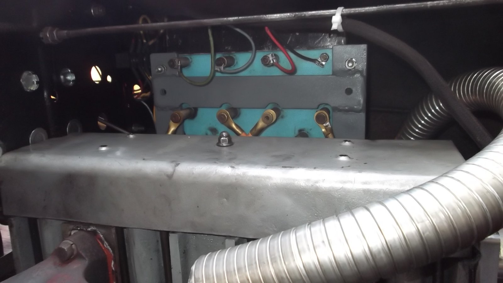

In case you are wondering how I mounted the coil box;

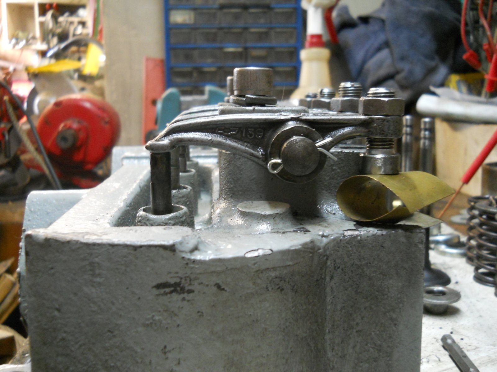

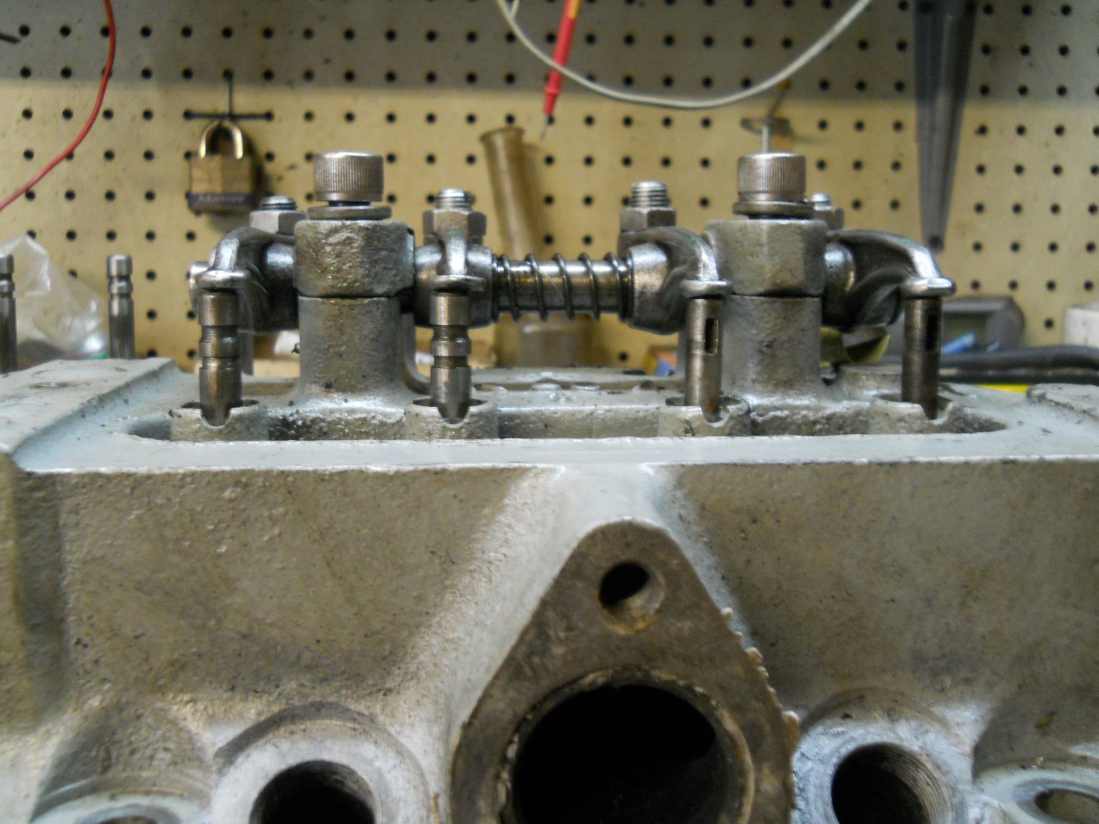

Give me a side photo of your #1 cylinder valves on top dead center. If your rocker arms are not set at the correct angle of contact, you are in a bind. Remember, that is a “B” series head, rocker ratio is 1.33 to 1 X cam lift. Sounds stupid but after they heat up, clearances close up and the tip of the rocker slips into a mild bind.
Just Saying been there done that. Sometimes rechecking the rocker contact alignment and slightly redressing the tips is all it takes. Your other specs sound Great Mark.

The Chevrolet head is off and T head back on. The valves I have installed are within a few thousands of the stock Chevrolet in length so rocker arm angle should be the same. I could install the valves loose with rocker arm an get a photo if needed. ? But you said "B" and 1.33:1, wouldn't that be RAJO?
Update; The valve do travel down more with the lift from the T cam because the lobes on the T cam are higher.

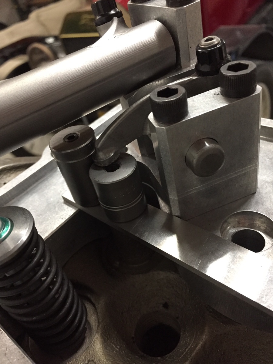

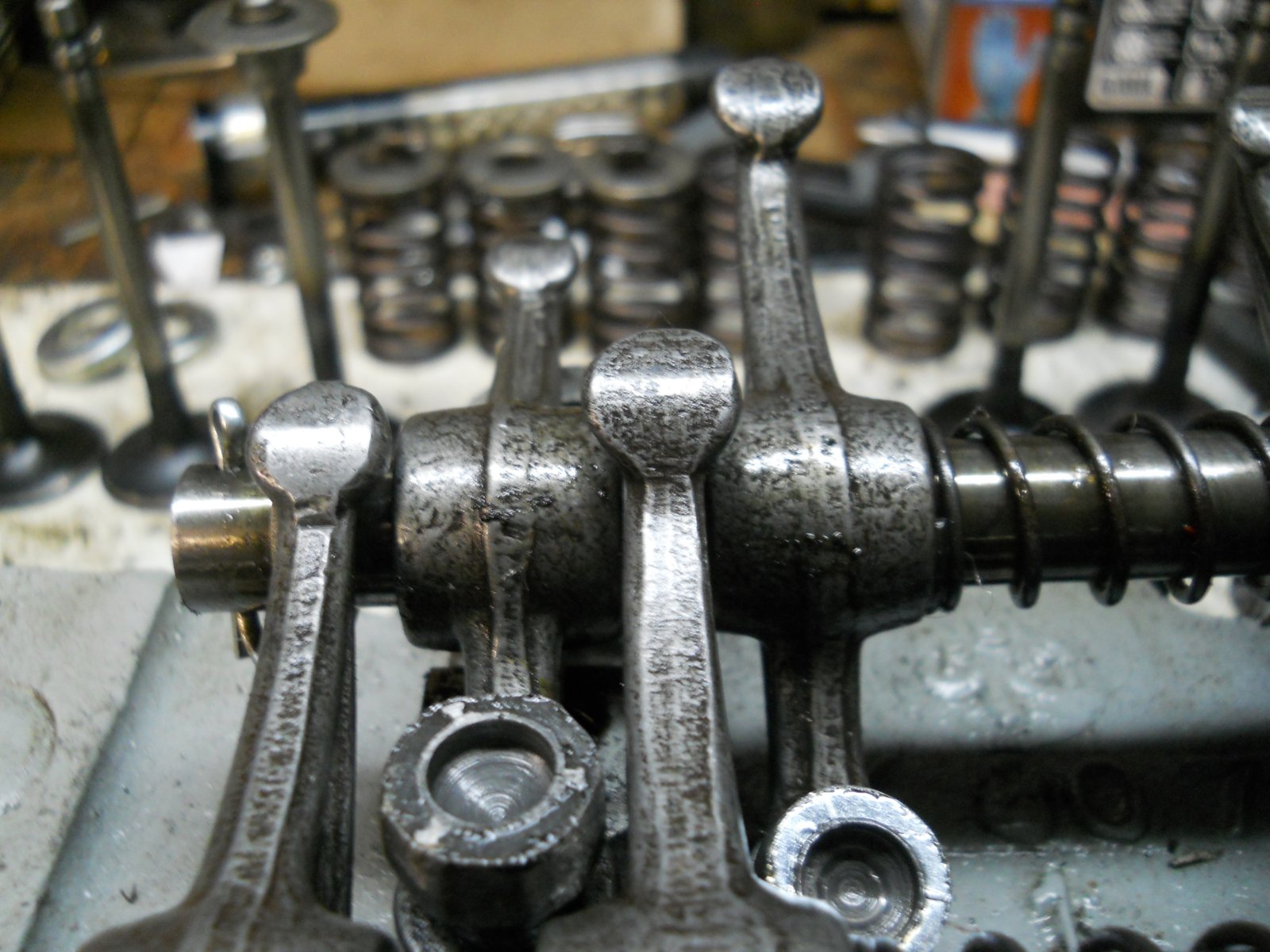

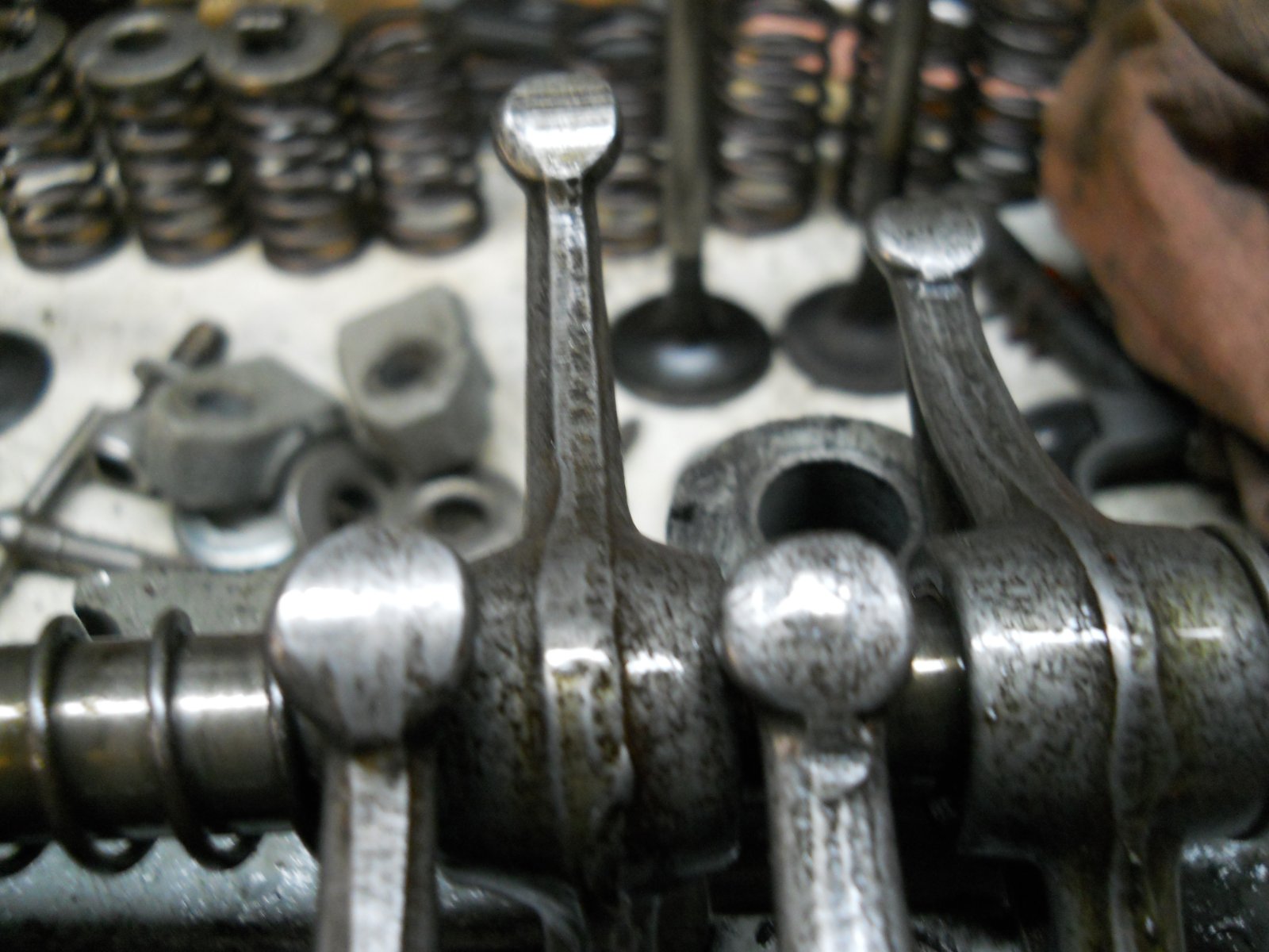

Got the B thing now. I thought the rockers were 1.5:1 on this head? Here are a couple of shots with the valves closed, No 4 are stock Chevrolet valves and No 3 are the replacements, I took shots with valves open but forgot to take into account the multiplying factor so will need to redo.

Re: Chevrolet over head conversion valve issues
Mark,
You do good work on taking pictures!
It appears you do not have enough radius grind/polish on the tips. Using a rocker arm attachment on an older model Sioux Valve Grinder to ratio angle would really help. Lack of angle/introduction causes a binding to occur thus preventing the valve to rotate naturally and will cause them to stick. I believe this is where your bad pixie is hiding.
Hope this Helps and all the Best,
Hank
Hank

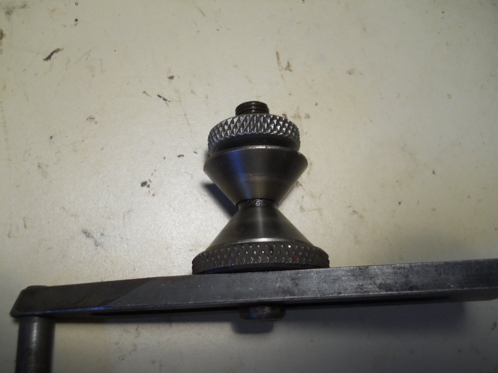

RE the radius, I sorta was thinking about that yesterday looking at the pads. Not something I really know about but sorta can picture what and why.
https://www.ebay.com/itm/SIOUX-VALVE-GR ... Swxbhe1Dz1
I was thinking maybe some of the pads looked a little flat and that they might not slide/roll across the end, not thinking that it would causes problems. I will have to take a look in the Black and Decker we have at the shop, I did a long time ago when we first got it, might be an attachment that at the time didn't know what it was for. There are a lot of dodads and what-nots in the cabinet.
While we are on the subject of the valve train, I noted that the exhaust lobes on the Chevrolet cam are more flat across the end so the valve stays open a little longer. The intakes are pointed so they ramp open and closed quickly. Looking at a Model A cam that we think is full race, both the intake and exhaust lobes are a little flat too, but not as much as the Chevrolet exhaust. Would there be any benefit to keeping the same cam lift but getting the exhaust lobes ground to the Chevrolet profile?

Ok so I looked at the pads on the ones I was using, not as bad as I thought but need attention. The one, top row, 2ed from the right has cuts running through it. The rest if not radius-ed need to be smoothed. Looked at the other set in my parts, yck! They need even more work. The two cam photos are the 28ish Chevrolet cam. RE the radius on the pad, good info for anyone installing an overhead, RAJO etc.

Just trying to help with experience and knowledge gained. Those rockers in my opinion do need to be polished up. Minor rust pits, looks like one has been on a belt sander (cross sanding), etc will cause drag with relative pressure. From your first pictures the high soot and lack of contact on the middle valve is a give away of this occurring. When you redress them and polish, you will notice a big difference!

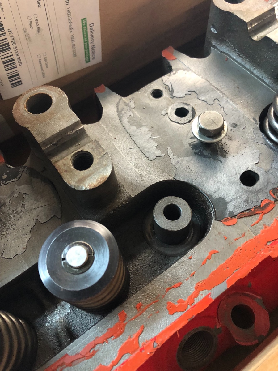

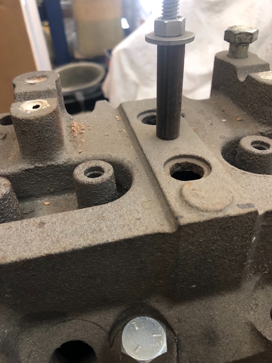

Here are some photos of a stock valve guide boss.
Here is after a trueing of the sides and decking to the main casting height.
I make my own tool, using multiple bimetal hole saws glued together with JB Weld (it is only cast iron and cuts like butter)
Simple valve springs used.
Hope this Helps Ya'll!

When I did my bosses, I counter bored them, then drilled an oil well as original. The only reason I did the counter boar was because the modern spring retainers came down too far. I'll post some photos tomorrow. I agree on the pads needing attention. They are pretty snarky. Thank you for the information, I am sure I am not alone in needing this heads up. Should add, the valves shown are from the front two cylinder, the back ones don't look like that, they all still have shine on the contact surface.

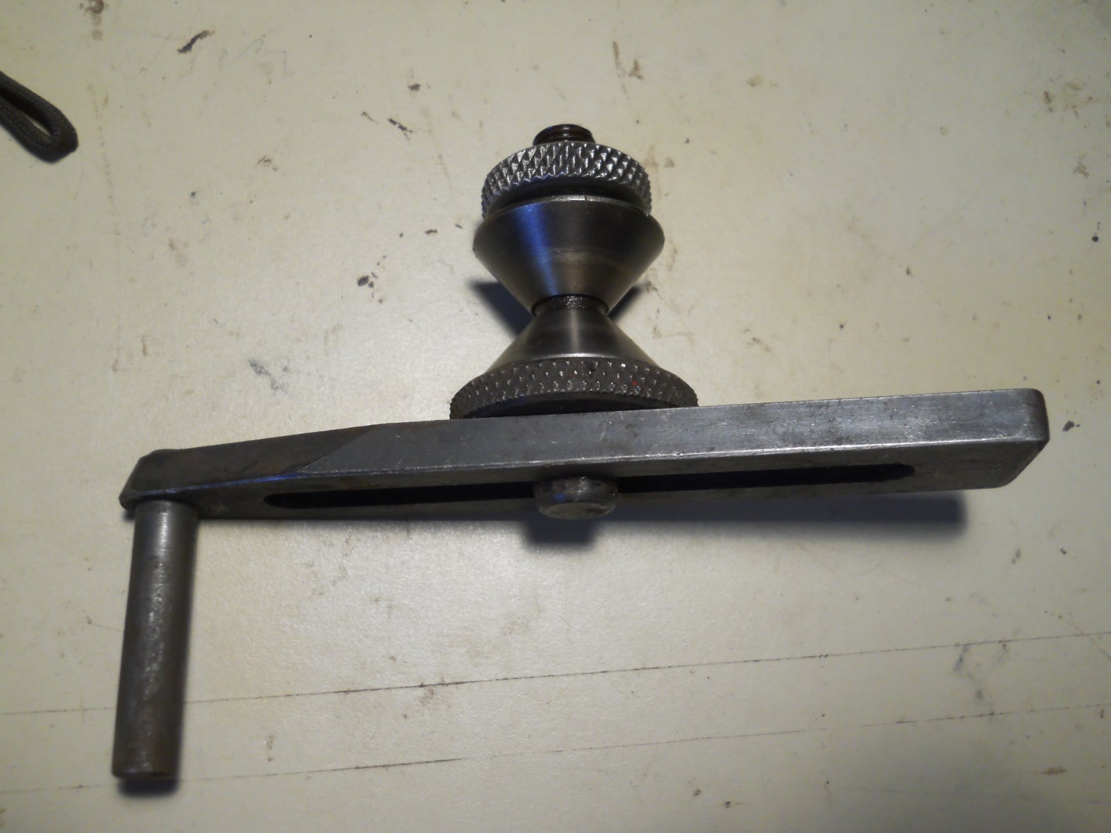

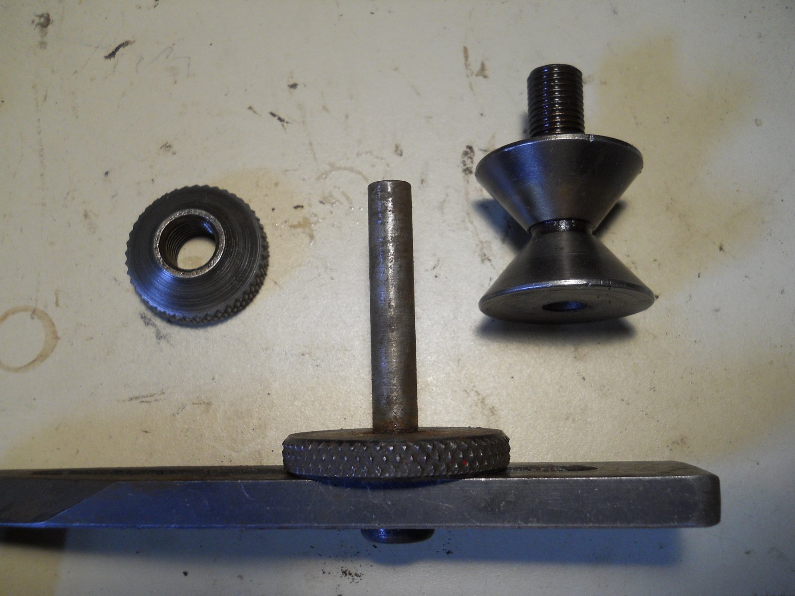

Few more photos. The Black & Decker holder for doing rocker arm pads and how I did the bosses. I am still working on freeing the adjustable cone on the rocker arm holder. I don't think it's threaded, if it was, there would be a flat knurled area to turn it. Tried a little heat and paraffin but she no move. The knurled piece at the bottom is not attached to the cones, it clamps the center shaft to the bracket, the top one is not attached ether, it locks the adjustable cone in place after the rocker is installed.

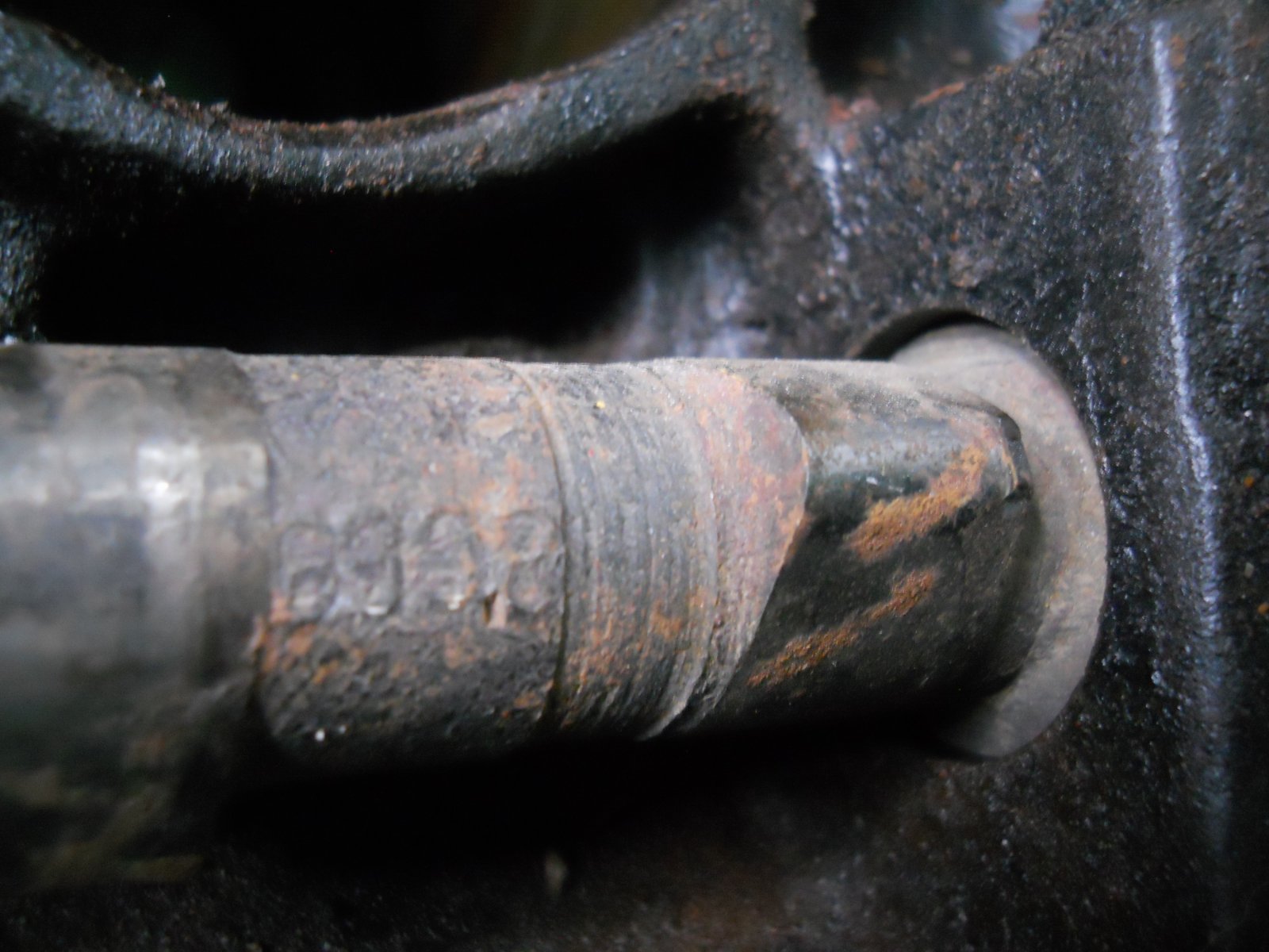

Update; I got the cone loose. It was a little rusted in place. I have been reading some postings on the subject on pads. Some of the post seem to indicate that as the pad wipes the end of the valve stem it turns the valve too. Trying to figure that one out?
