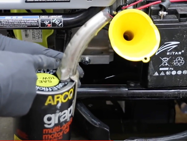

Arco did market a graphite oil in the late mid to late '70s as the gas prices jumped, tried to claim better milage.
You won't find it on the shelves today. But you can find flake or powder graphite if you wanted to add it to your oil, but.....
