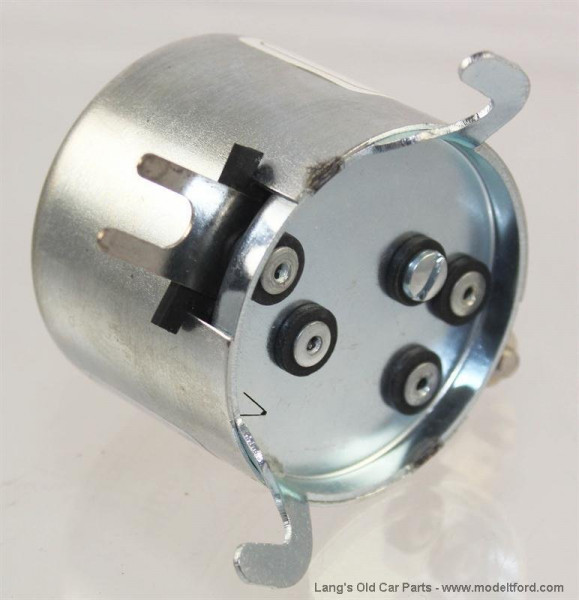

To tell if you have a VR, remove from generator, and look at the underside.
The VR will have that tell-tale 'arrow point' notch in the underside, that is a purpose placed feature not found on any type of cut-out.

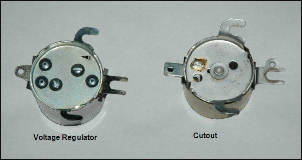

Unfortunately that is not 100% true. The first photo is a cut-out that I was in the process of modifying for a diode. It has the notch punched through for connection to the solenoid. The second photo is from Lang's for the underside of a 5055 Fun Projects Cut-Out. Third photo id's what the screws, rivets, notch are for. "electronics" may be a solenoid, diode or VR board. Somewhere in the MTFCA discussions there were pictures of the undersides of the Fun Projects cut-out and VR's
By John F. Regan on Friday, April 15, 2011 - 04:14 pm: "All of our voltage regulators are easily discernible as to 6,8, or 12V as follows: On the underside of the base the 8V units are stamped with a letter "A" while 12V units are stamped with a letter "B". No stamp at all and it is then a 6V unit. Positive ground Voltage Regulators have a steel washer in place of one of the center insulating washers. As pointed out - a rivet in one of the center locations designates that it is a cutout. Hope this helps."

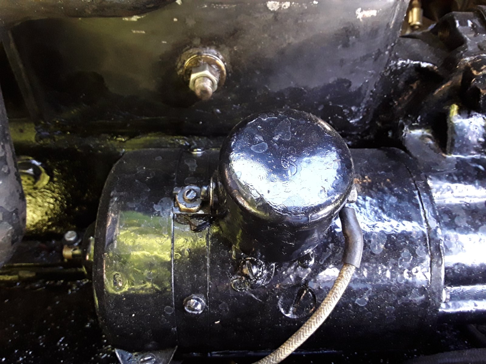

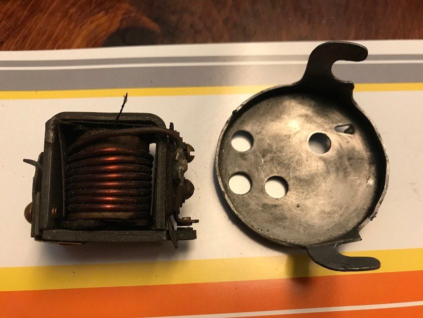

Well, I finally took off that little drum that sits on the generator. I turned it around and found out that it is probably a cut out and not a voltage regulator. I took some pics and would like you to confirm this.

It does not look like the Fun Project's VR. The best way to tell is to remove the cup from the base. Normally just two spot welds hold it on to the base. If its not VR but solenoid cut-out you may want to rebuild it with a diode. Perhaps someone can design a VR that can be put in front of the battery and leave the cut-out where its at
