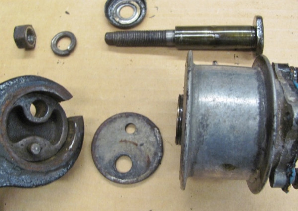

This might be of use, good luck, jb
https://www.mtfca.com/phpBB3/app.php/gallery/image/1124

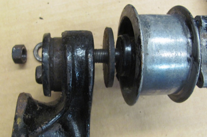

Unless it's rusted in place, you should be able to remove the eccentric from the rear, after you release the nut on the fan shaft.
Then the fan shaft with the fan should drop down and out through the slot in the bottom of the fan bracket. The longer fan pulley for the late thin row radiator complicates things.

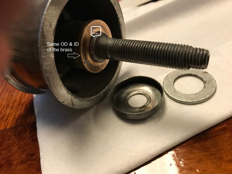

Chances are the Fan Shaft is worn and the bearing hub will be a loose fit and it needs to be replaced as well. Also you might need a washer to compensate for the felt washer which is no longer needed. I found one of the correct ID, thickness and OD that fits inside the fan shaft cap.

Very likely easiest way would be to remove the radiator first. Then you can remove the blade and or remove as in the picture by Dan. You will need to remove the fan anyway to remove the shaft.

- Posts: 6544
Re: 26-7 Fan Hub removal.
Using the stock hub as example: I found a thrust washer the same size as the brass bushing (OD/ID) and was thick enough to cover the shaft end and fit inside the fan shaft cap. The purpose is to prevent the bearing bushing from spinning. True Value hardware stores with those multiple part trays will have them.
