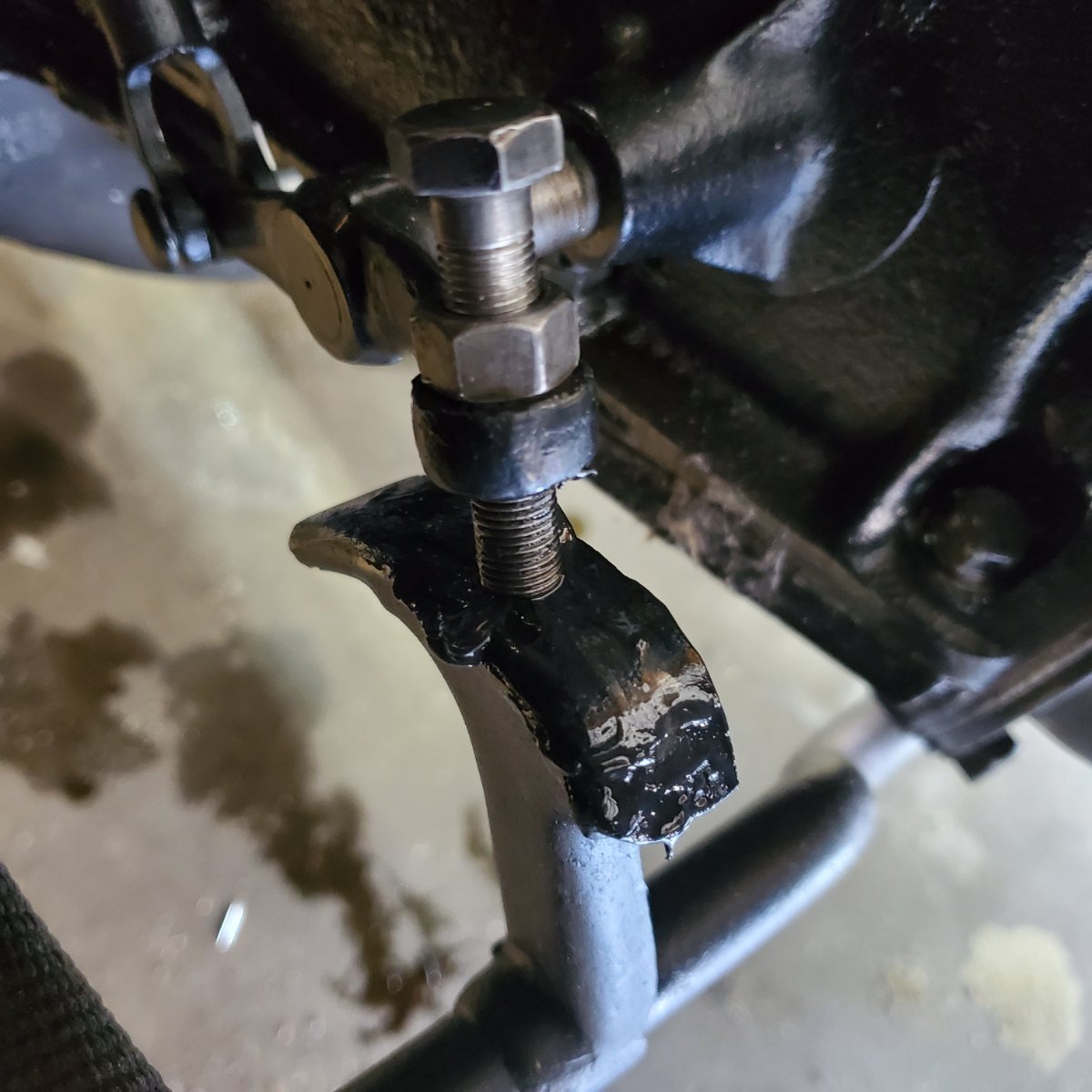

Norm. The brake rods are plenty long. I readjusted the brakes and reversed the position of the bolt that engages the handbrake cam to where the threaded end slides on the cam. Adjusting the brakes with the engine running helped
getting them so they grab at the same time. Reversing the handbrake cam bolt allowed a bit shorter handbrake throw before engaging high gear. Result is I can pull the handbrake lever further back than before but it still goes into high when I release it. I'll drive the car after lunch and see if there is an improvement on the road.
