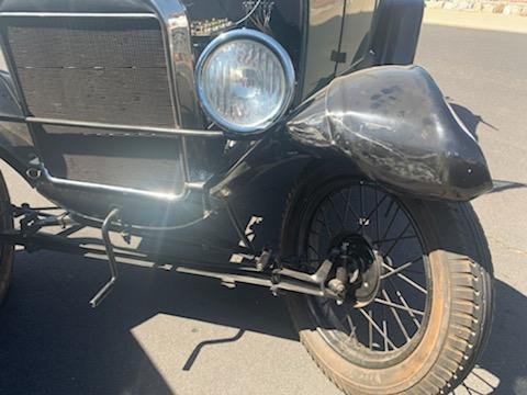

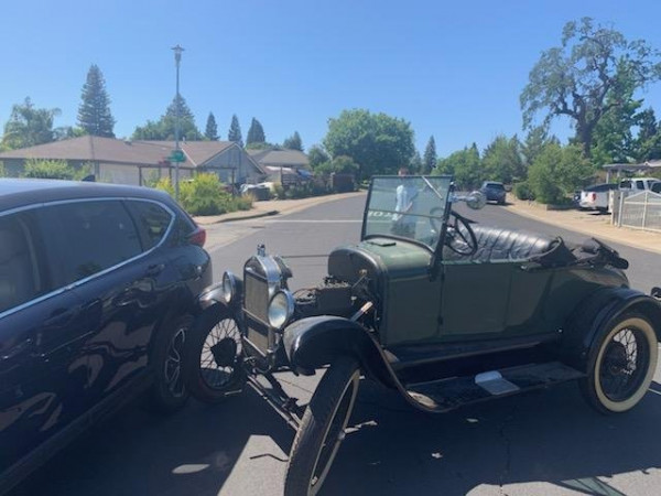

I was hit by a distracted driver. Serious fender and front end damage. Possible frame damage. Is there someone near Sacramento that does good body and fender repair. Be great if they did chassis repair too.

Huge bummer Richard!! At least the damage to the car is fairly minimal, and hopefully you are no more than shook up.
It looks like the walk home was pretty short too... isn’t that just at the end of your street?

No injuries. Don't know why she didn't see me. She claimed she wasn't texting. She admitted liability to me on the spot and made some incriminating statements eg I was looking at nearby landscaping, but her ins co (Allstate) says I'm 35% to blame. I expect to file a claim in Small Claims court for the what they say is my share, but I'll contact the California Insurance Commissioner first. Their partial denial is a naked attempt to save money. After looking at the front end, I need to replace the axle and spindles for sure. The fender of course is trashed. Hope to salvage the rest. Don't know about the frame yet.

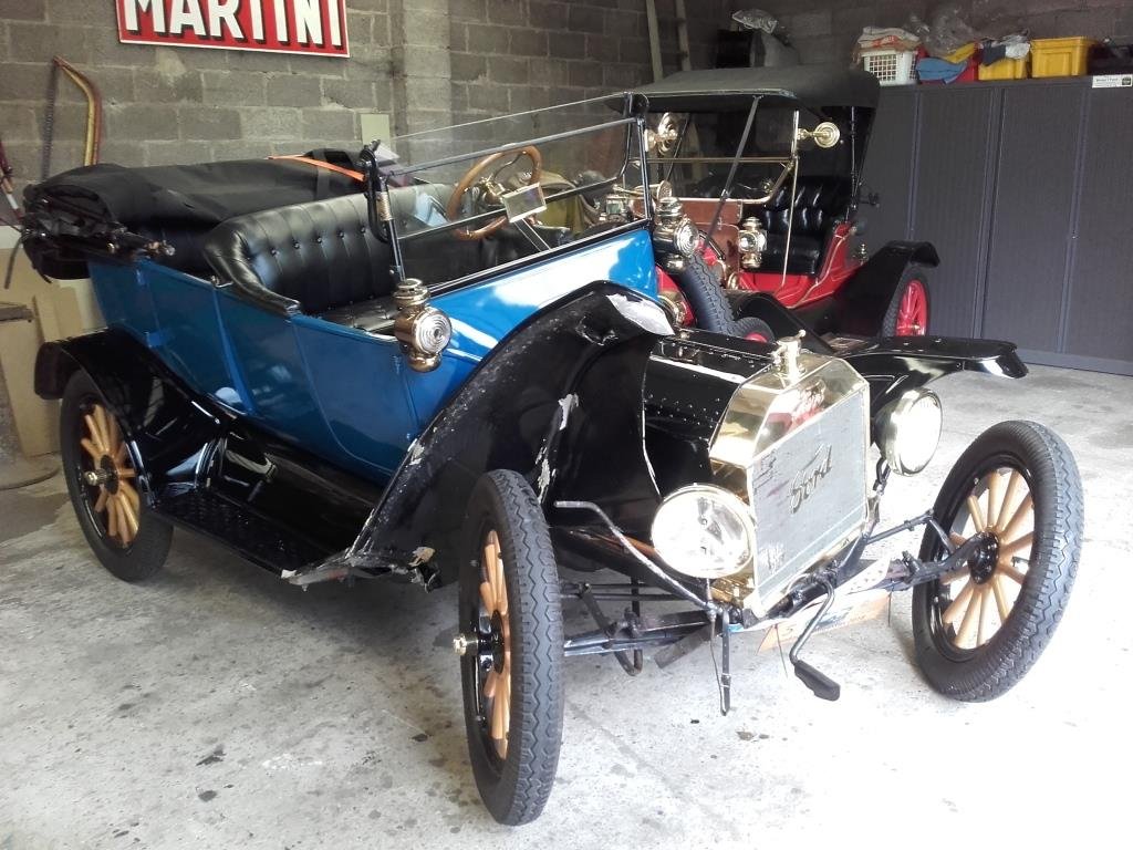

Lucky there were no injurys,
I was there before.
To repair it, you will need to take it all apart. Separate the body and the frame and look closer to the oilpan specialy the spot where the wishbone is attached. Have seen this before. By the 1915, at the first look, the oilpan was OK till I took it apart. The wishbone spot touched the coilring and broke it. The oilpan was also out of line.
Good luck

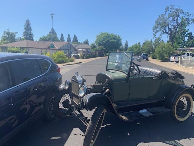

Kind of a weird picture. Can’t tell who was coming or going. What actually happened?

I had a chance to go through the car this morning and discovered that there were more things damaged than what I first thought.
Specifically the pan is sprung, the front axle is bent, the spindles are bent, the radius rod is bent, the fender is destroyed, this splash apron is bent and the driver's head light rim is damaged as well as the headlight bar and the bucket.
In addition there is a question as to whether there is damage to the following items: the front wheel bearings, the frame and crossmember, the spring perches and shackles as well as the radiator shroud.
The agreed value of the car is $10000.
