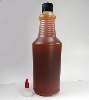

They call the 600w oil grease. Rear axle “grease”, 600W Oil. Heavy weight clinging type oil specifically made for the Model T rear end. https://www.modeltford.com/item/600W.aspx I also read where some use #2 red grease on the bearings and thrust plates to keep things stuck together during assembly.

Yes, but this is different than cup grease which is typical wheel bearing grease. That much I know!TRDxB2 wrote: ↑Tue Jun 23, 2020 11:04 pmThey call the 600w oil grease. Rear axle “grease”, 600W Oil. Heavy weight clinging type oil specifically made for the Model T rear end. https://www.modeltford.com/item/600W.aspx I also read where some use #2 red grease on the bearings and thrust plates to keep things stuck together during assembly.
