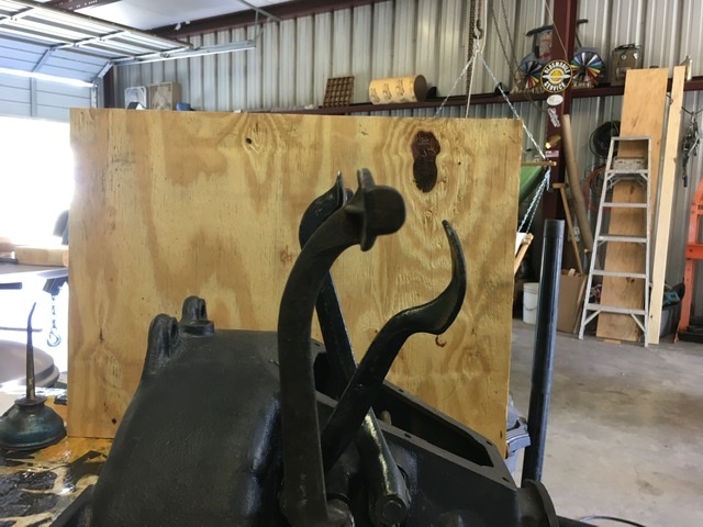

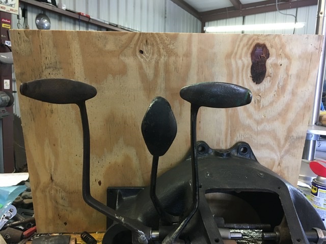

Setting up the pedals on my 27 hogshead with new cams and looking at pedal alignment. Have Rocky brakes with a homemade pedal (crafted looking at an original, using a wide pedal head). SO, I know I can heat and bend pedals where I want them, but this is bending against the main spine of the pedals. Also, since reverse is probably the least used pedal as far as really pushing on it, should I try to align with it, or choose a happy medium between all 3. Trying to do this before putting the engine in the car, but I know that floorboard height is a concern eventually.

I don't see anything wrong with them the way they are.

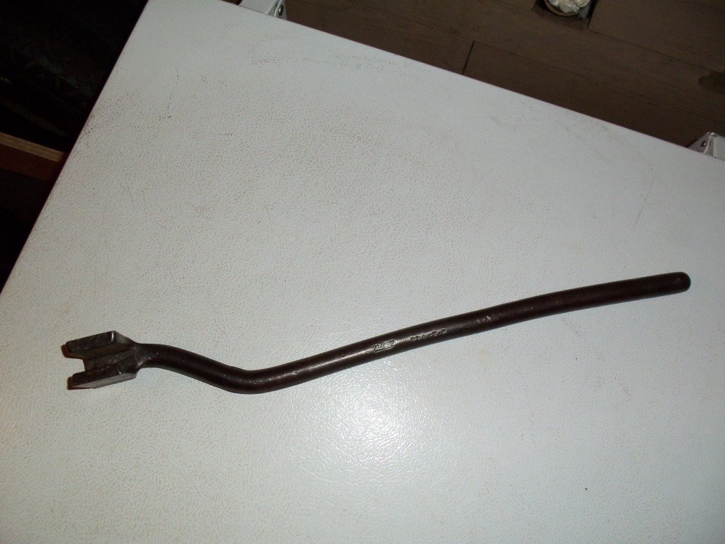

This is a Ford Z tool - it's used to bend the pedals cold and would place your reverse pedal centered between the other two as it should be !
Well, ok, I'll agree with the reverse pedal needing to be contered.

that is barely a tweek to make right

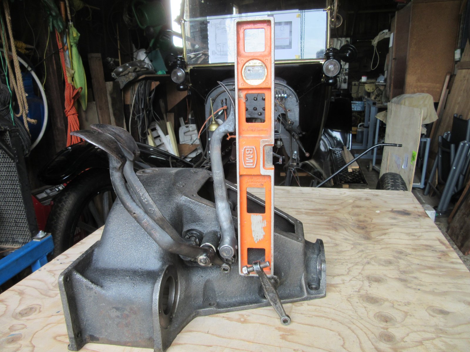

Post by ABoer » Sun Jun 21, 2020 3:59 am
Hi all ;
I bend the brake pedal warm , so he is vertical [picture] .
For the other two I don't have a good measurement till now .
But the reverse is mostly OK .
But first I weld up the Pedal supports # 3436 -3442 .
So there is not any forward movement of the pedals, only sideways .

Post by fordt » Sun Jun 21, 2020 10:13 am
That’s a great picture. I’m assuming when you say welding up pedal supports, you are welding/building up the 2 cam surfaces and not actually welding the cams to the hogshead!?

Post by ABoer » Sun Jun 21, 2020 10:47 am
Rob , Yes I am building up the 2 surfaces on the cams ,
and also I put some O rings between the cams and Hogs Head

Thanks to all, got things more evened up and aligned today. As an aside and a possible tip, I cut some conduit to use as a spacer to hold the pedals up solid against the cams. Made it a little easier to heat and bend the pedals to their final resting place.
