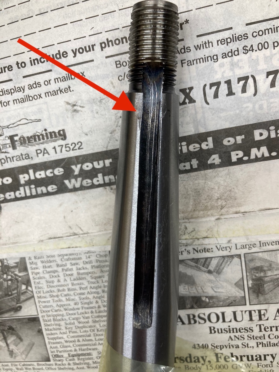

Re: How Tight Should Keyways Be In New Axles?
Here’s a pic from the first set of axles received. Both were the same. I’m this close to putting the originals back in.
Thanks to Scott for the kind words. Some know that I Iost more hair sorting through this recently. The nice thing about the axles you're using is that they are consistently wrong and the outer keyway seems to be the only real issue with them. In all other respects they are pretty nice. I tried a set from a different manufacturer trying to get away from this issue and they were all over the map with several dimensional issues that made them unusable. So far as I know the ones you have in-hand are the best available.
I was going to post documentation photos that I took at the time but the forum software doesn't like the dimensions and I don't have my easy resizing software since a recent hard drive crash. With four axles in-hand all the the keyways were 0.247 when checked with gauge blocks. The key stock I used was 0.251. In the end I think I left the keyway about 0.0005-under after taking an equal amount of material off of each side. That made for a nice tap fit in the axle and took care of some of the issues with the hubs I was using.
You don't want to dress the whole sides of the keys, just the area that fits in the groove. The part that fits in the hub has to stay the same. I wonder if these are made to fit the key stock that's available? Some of the keys being sold are under size by one of the major parts seller suppliers.
That keyway is shallow and not easy to measure with calipers which is why I used gauge blocks. I didn't find any of the four that I did to have variation along their width or any other out-of-squareness. It's a problem and it's irritating that a lot of these things we buy can't be used right out of the box, but the trade-off is this is one of the few cars where you can get anything this cheap. Other cars where you have to have this stuff custom made one-off, you can get it done by the right shop and it will be perfect when it come back, but it won't be just $100 bucks, either.Dan B wrote: ↑Tue Jun 23, 2020 9:07 amI am not a machinist nor do I pretend to be, but it seems that even someone untrained like me should be able to take a reasonably good pair of dial calipers down that slot and measure the same width throughout. That’s not the case here. I don’t know how this is possible on something that you would think is precision machined. The keys themselves also leave something to be desired. There is some variation in the width along the length of the key and the end where it is cut was very slightly mushroomed.
