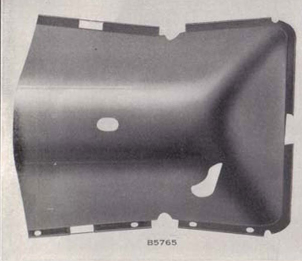

As I prepare to pull the engine on my 1923ish Touring, I've found one of the more difficult things to do has been removing the splash pans.
I have had no love for these things ever since I had to fight with them when removing the Pitman arm from the steering shaft.
My question is: are they really necessary?
Would it be a big mistake to leave them off?
