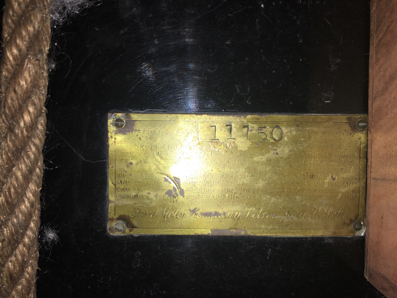

Post by Alan Long » Fri Jun 26, 2020 10:14 pm
Great video and thanks for sharing and getting another T on the road.
What I don’t understand is a previous post that said “it’s 1910 made in 1909” How can that be?
that must be a reference to “Model Year” ? Curious to know if you have documents to confirm the actual Build Date?
We don’t refer to “Model Year” in Australia but always refer to the Build Date on compliance plates. Interesting stuff
Cheers Alan
Posts: 4344
Re: First time out for my 1909 Model T touring
Post by Wayne Sheldon » Sat Jun 27, 2020 12:12 am
Alan, Here in the USA, most cars, almost from the beginning, had a "model" year. Usually, the "model" year would begin about September in the autumn months preceding the "calendar" year change. However, this has never been "officially" so, nor has it been in any way consistent or reliably so. Automotive history, and especially model T history, has been rife (is that a good word in your part of the world?) with exceptions to the "September model year change". Tony's model T touring car is a re-restoration of an old restoration of a truly original automobile, with a somewhat confirmed build date in October of 1909. Technically, it is considered by many to be a 1910 MODEL year model T. However, since the cars were changing so much and so quickly at that time, it should be noted as being a 1909 built model. Ford was not making clean model year changes in those early days of the model T, and basically never did (consider the whole '22 to '23 to '24 issue). Some will argue that 1909 touring cars were painted red, and most early '09s were. However Ford began painting many of them green in June of 1909, and by July, very few were being finished in red. So the color is correct for both model years.
As far as I am concerned, Tony should call it whichever year he wants to. If it is technically a 1910? It is by only slightly more than a month. And his car is early enough to have several early features that most 1910 model year cars did not have. I think he has done a wonderful job taking a nice older restoration and making it better than it has been in well over a hundred years!

Post by TonyB » Sat Jun 27, 2020 10:11 pm
I’m fairly confident about the date of manufacture with two irrefutable items. Both were in the video but only visible for a few seconds.
The first is the serial number tag shows 11150 which according to the encyclopedia is 4 October 1909.

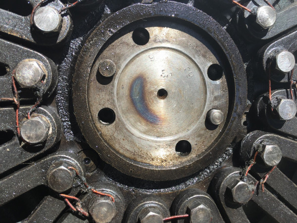

The second was even more convincing, indeed when I saw the transmission shaft stamped 9 30 09, I bought the vehicle.
Date on transmission shaft
So that’s how I dated the car. Subsequently I bought the build sheet for 11150 and sure enough it was stamped on 4 October 1909 and shipped to a Michigan dealer. I also acknowledge that all cars built after July 1909 were considered 1910 models but in my mind, that does not effect the date the car was assembled.

ModelT46
Posts: 1658
First Name: Darel
Last Name: Leipold
Location: Excelsior MN
Post by ModelT46 » Tue Jun 30, 2020 5:08 pm
There seems to be some evidence that the Ford company made a clean cut change from the 1909 model years and to the 1910. After the change there were probably none painted red, only breewster green, whihc is a 1910 color only. A local T has a serial about 8500 it it is an original tourabout, which was first offered during the 1910 model years. There are nice 1911 torpedo roadsters around with september 1909 build dates and this style is a 1910 body style only. What is important is to dress a Model T out correctly for model year and the above T is finished as a 1910.
