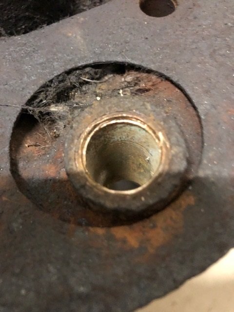

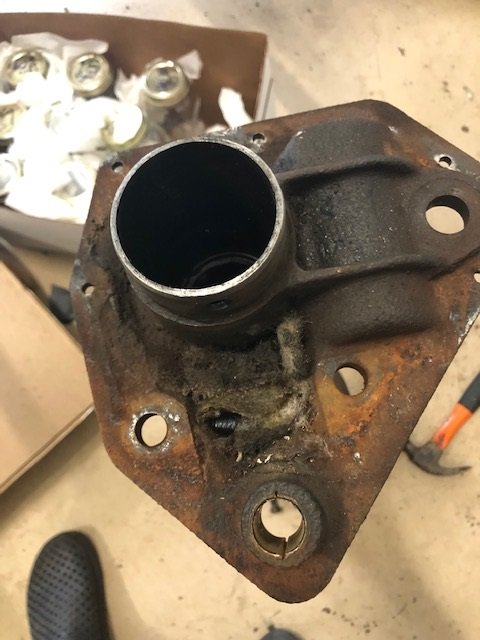

Hi, I am wanting to replace the pictured brake cam bushing but it is just a thin shell left. The regular bushing removal tool moved it only a little because the bushing is too thin. Is there an easy way to take it out?

Looks like there is plenty of bushing there. The indent is from your driver tool. I’d say that either you have the wrong driver or it’s poorly made. The outside diameter of the driver you are using is too small.
Adam has it! Your driver tool diameter is too small and it's forcing itself into the bushing, spreading it further open and only making things tighter. You need a driver with a bigger shoulder. For comparison, slip your driver tool into the new bushing and see how much smaller the driver diameter is compared to the outer diameter of the bushing. They should be nearly the same size.

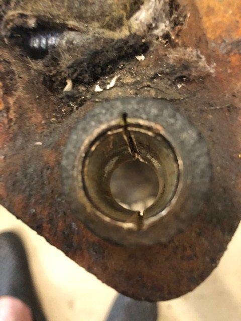

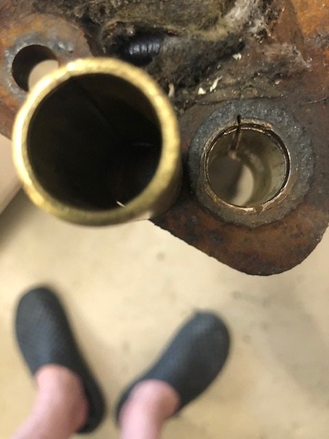

I am using the 'Shackle and Spindle Arm Bushing Driver' from Lang's https://www.modeltford.com/item/3820-44T.aspx I've cut it with a hack saw on 2 sides (see pictures) and whacked it pretty hard with a 5 pound hammer but it doesn't seem to budge. The brake drum backing plate is off. The insect larvae uncovered is a plus. I could use advice at this point because it doesn't seem to be moving. Hack saw it more? The last picture has the new bushing right beside where it is supposed to go for comparison.

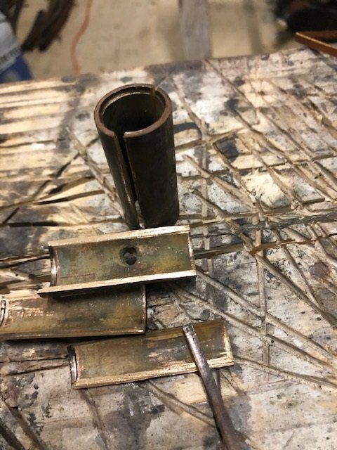

They are out with a combination of hack saw and hammer. They really wouldn't move at all until they had been cut enough with the hack saw to collapse or compress.

Turns out my bushing removal tool was fine it would simply not budging whatsoever until I cut it with a hacksaw. I was whaling on it with a 5 pound sledge, was bending the plate and it wasn't happening. After I cut a sufficiently deep cut to make it collapse a bit then and only then it moved.

You can see in your old bushing how the driver jammed itself in for what appears to be about 3/32" at the one end. This is what made the bushing so tight, even after it was split. The driver being rammed into the end of the bushing expanded it and made it all the more tighter. Therefore, a proper driver would have a wider shoulder, to more fully engage the end of the bushing, and a diameter just a little bit smaller than the outside diameter of the bushing you're removing. Where to get one is a different matter. Aside from making one on a lathe, you might try measuring the bushing diameter, then sourcing a length of metric drill rod from McMaster-Carr. I say metric because some metric sizes will be just a tad smaller than fractional sizes. In most cases, the next available smaller fractional size is already too small. Anyway, once the rod is purchased, it would be ideal to step down the diameter of one end to just slip nicely into the bushing. This gives you a nice pilot, or guide, to center the tool over the bushing. That's where a lathe would be handy. The pilot however is not 100% essential, if you can hold the tool central to the bushing until it begins to move. After that, the the hole you're driving the bushing out of becomes your guide. Hope this helps.
