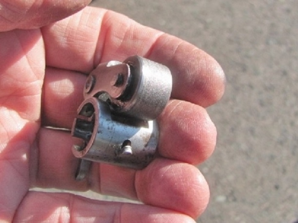

If you're running an original, might be the issue. Likely the roller rotor is now pitted and running poorly making for lack of proper timing to the coils and the fire to the plugs is reduced.
This one caused similar running symptoms at speed, during a tour few years ago, replacement with a newer one and troubles solved.

Head is off. The valves look ok except number 1 and number 2 are more heavily sooted, number 3 and number 4 are less. The two adjacent exhaust valves on 1 and 2 are sooted. Maybe I should have just kept driving it to clean it out after it had run poorly for awhile? Pictures below are with 1 and 4 up and 2 and 3 up. The engine top and head was scoured clean 3 years ago with a wire brush. -- IV

Looks like you have burn't exhaust valves on 3 and 4, I suspect a bad intake gasket on 3and4.
- Posts: 4512
Re: Running poorly.
I think I would replace all the valves and lap the valve seats while you have it apart. Looks like you have the original 2 piece valves. Not many folks still use those in a rebuild. If you keep driving your car and I know you will the valves might need to be changed. They may or may not come apart but after 90+ years something might happen.

Ignacio - You've gotten a lot of good advice here, but I think John Tannehill in particular gave you some very good advice. I don't think you've got burned valves. In blowing up your photo of the engine with the head off, I think I see something that the wet & dry compression test that John T. suggested would have confirmed. It looks to me like you may have developed a compression leak between #1 & #2 cylinders. A blown head gasket between cylinders where the head gasket is very thin is a fairly common problem. I see just enough black (dark area) in one spot on the thin part of the gasket between #1 & #2 to indicate that possibility,...perhaps blown out on the under side of the gasket where it can't be seen in your photo, next to the engine block surface. Again, a compression test might have shown low compression on adjacent #1 & #2 which would have confirmed this, but I'm betting that you'll find the gasket burned out at that spot on the under side when you take the gasket off and examine it closely. If you just want to "freshen the engine up" a bit, I'd leave the pistons alone and just replace all those old (probably 2-piece) valves with new stainless steel valves after making sure you've carefully inspected and restored good valve seats. Cutting new valve seats with carbide valve seat cutters would be best, but carefully grinding new seats and lapping in would suffice, but being careful not to remove any more material than necessary as the valves look to be seated pretty low in the valve seats already. (...new valves might help that however!) Hope this helps,......harold

Well,....SHOOT! Egg on my face!!! Now that I look at the photo closer, that "dark spot" might just be a shadow! I didn't notice that when I blew the photo up larger for a close look. I'd still replace the valves tho' as others have suggested.

- Posts: 6593
Re: Running poorly.
Pull the valves, measure the guides. If necessary (and it will be), ream the valve guides to the next size up. Cut new seats with Neway valve seat cutters, buy new valves of correct stem diameter. Send new valves out to have seat angle reground (cheap insurance against shipping damage) and fit the valves. Everything else you mentioned, pushrods and cam bearings have nothing at all to do with how it was running, unless it was smoking like a bandit, and you never mentioned that.
I've seen this many times...if you don't define the problem and the specific solution to the problem, and then stick to your guns in fixing THAT problem, this engine is going to take you all the way back to a total rebuild. After you have the parts in hand, this should be a long weekend's work and be on the road after. If you start the "what if?" game, like I said, you'll talk yourself into tons of unnecessary work.

Thanks Scott, I know from previous adventure that the pushrods are dished. Replace?
- Posts: 6593
Re: Running poorly.
Everything is worn. Changing push rods means fitting them/reaming the boss' to match. To do that, you must pull the cam shaft. It and the bearings are worn...replace them, too? The cam gear will be worn...replace? Probably need an oversize cam gear since the new gear will not mesh well with the crank gear. Replace the crank gear to match the new cam gear? Pull the engine and drop the pan. Only thing left is the main bearings and crank. Sound like an engine rebuild?
If the car is not smoking, the push rods are not overly loose. I'd leave 'em alone, replace the old valves and be done with it. Later on, the engine will dictate more work and by then, it will be a complete job. The valves look sunken into the block enough that the next time around, you're into valve seats anyway. Do that with the complete engine job...years from now.
Now, all that said, it is with the assumption that it is indeed a valve problem. With those valves, they need to go, anyway, and you'll likely find very compromised seats on at least 1 exhaust valve and probably more. I would also measure the total lift of each valve to ensure you have not for some reason (unlikely) wiped out a lobe on the cam. I would finish the job with new, quality intake/exhaust gaskets. I would not be surprised at all if that was the original and possibly root cause of your carbonizing in the first place.
It is too bad you did not perform a compression test when it was suggested. A vacuum test would have been useful too. At this point all you're left with is inspection and remediation, with some restraint on how far to go.
