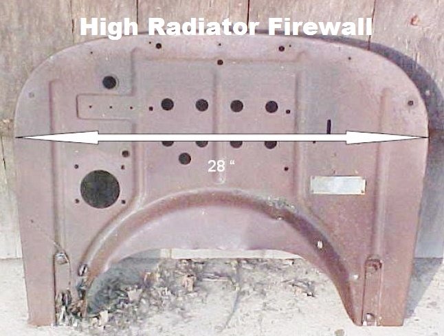

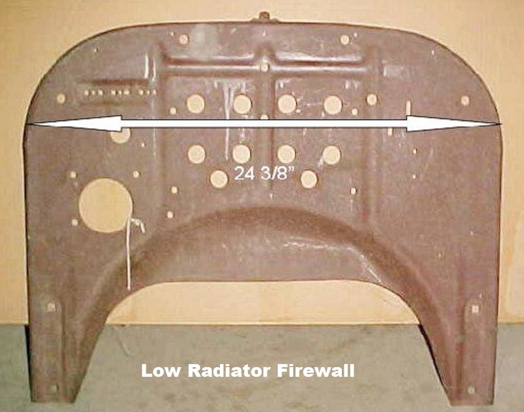

First off I'm new to Model Ts. Totally ignorant. I have the remains of a roadster body that I was told is a 23. The firewall is missing and in trying to do some research I find two width firewalls. One 23 and three eights wide and one 28 wide. When I measure across the body opening I get 27 inches. How does this work? Thanks.

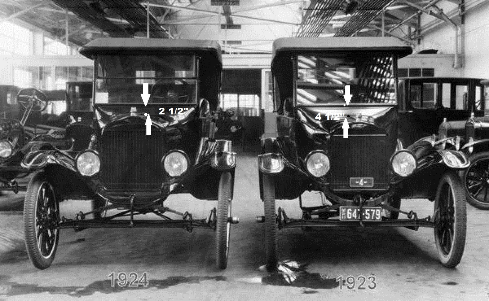

One way to tell the '23-'25 open car body only without a firewall is to measure the cowl height from the upper windshield ledge to the lower edge where the firewall mounts. The high radiator body cowls are much shorter than earlier low radiator cowls, i.e. the low radiator cowl is much steeper drop. Open Improved Cars ('26-'27) have very different cowls with gas filler door and gas tank in cowl.
High radiator are '24-'25 model year, with that 'new bodied' 1924 model year (in late summer 1923).
Low radiator are '23 model year, for the first slant windshield that came out for the 'new bodied' 1923 model year (in Fall 1922).

If the body you have is missing the firewall, and any significant amount of wood structure, the sheet metal usually sort of "spreads" without some support. That could likely explain the in-between width.

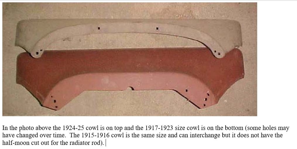

If the body is all the same sheet metal that came from the factory it is easy. If like many bodies the wood is gone and you have sheet metal from various year ranges it is more difficult to figure out.
During the 1923 Calendar year Ford produced a 1923 model year car that had a "low cowl." That body with variations was produced from 1915-1923. And during the later part of 1923 Ford introduced the "High Cowl" cars that were continued into the 1925 model year again with some changes to the body.
The cowl of the bodies look generally like the ones shown below (some small differences depending one which of the 5 or so body makers produced the 1915-1923 body and also when either of the boides were produced). But the key thing is the 1915-1923 has a large flat panel at the front of the cowl while the 1924-25 style has a much smaller lip that runs only an inch or so at the front of the cowl as shown below:
