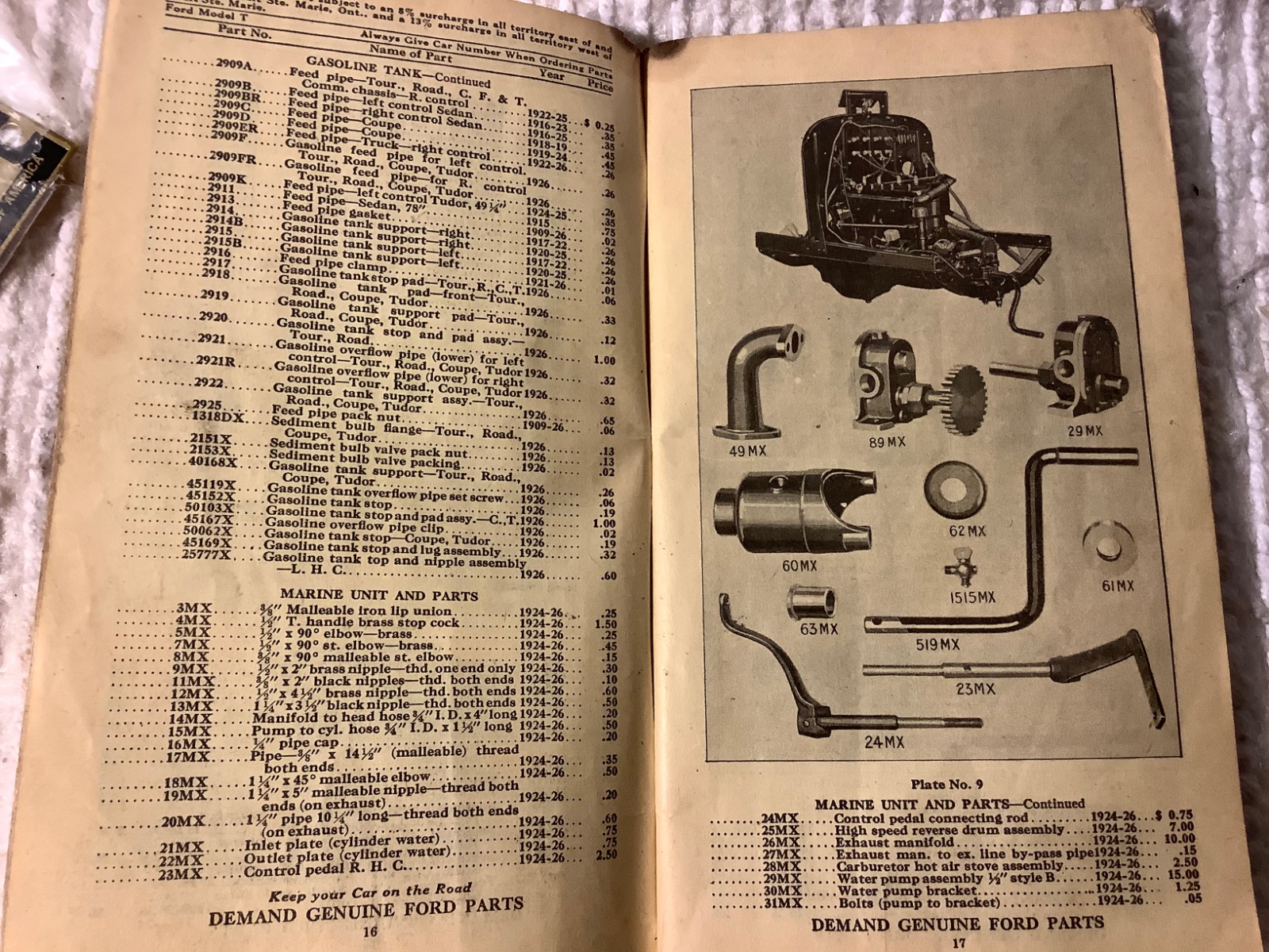

The usual marine transmission was a very clever adaptation of the car gearbox.
The teeth were ground off the driven (sun) gear, and the low and brake drums were locked together.
When the reverse drum was clamped, the output turned at 0.96 x engine speed in reverse, so the sailor had direct drive for going forward, and almost the same in reverse for going aft.
I take my hat off to whoever thought of that mod.
I believe it was incorporated in the marine motors made by Ford Canada (MX part numbers)

This a link to Cimorelli's library and page that shows marine conversion parts sold through Ford of Canada and Australia (1927). The Canadian parts book shows the same parts in it. Maybe not the same but might be of some help.
http://www.cimorelli.com/mtdl/default.htm

Thank you, Mark!
The Australian parts book also has 3 pages devoted to Ford Marine Installations.
Very helpful to know!

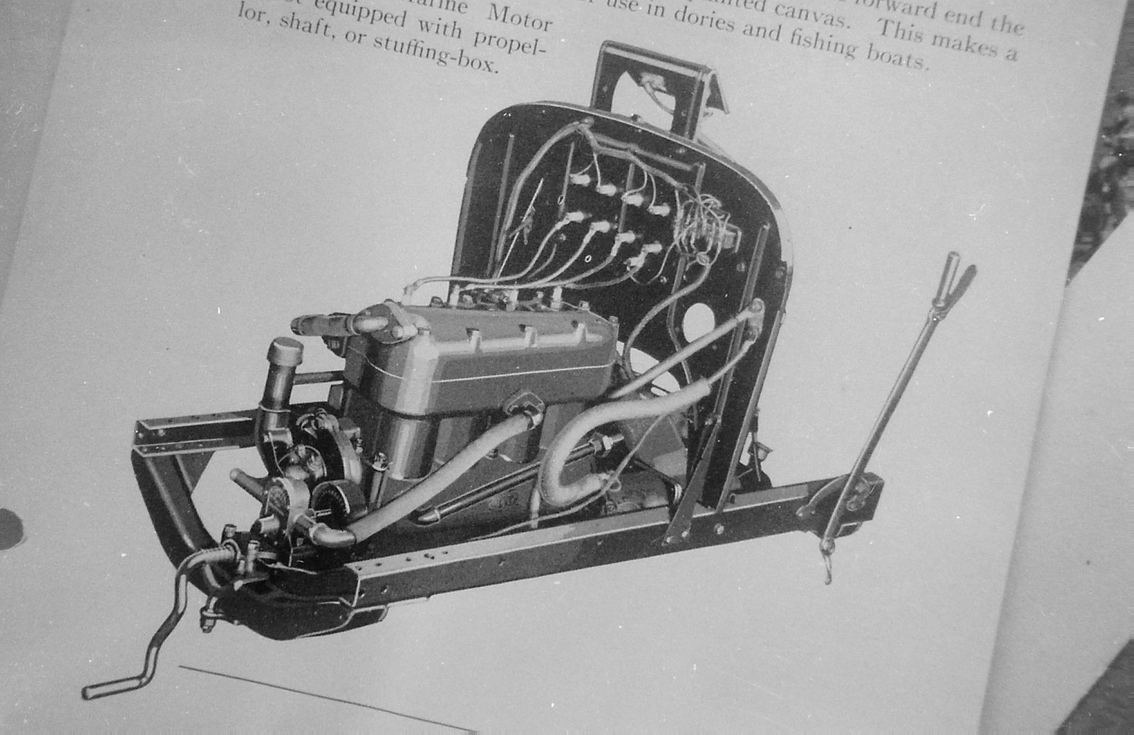

Mario,
You may find it very difficult to track down a St lawrence Co Motor, but as Ford Canada produced a marine motor why not set about using a T motor and converting it so it works in a vintage boat?
Send me your email address and I will send you the details, the actual Ford parts may be unobtainable but it would not be too difficult to source similar parts (or make them).
Such a project will keep you off the street for a few years, maybe give you a few grey hairs as it keeps you young!!!

mario,
here is a photo of the Ford Canada motor, should have added it to the previous comment
