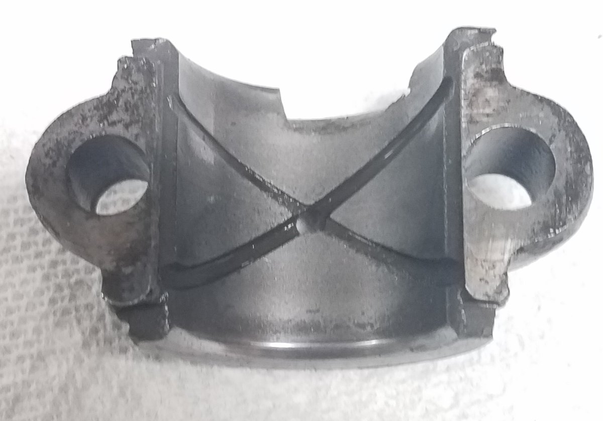

Checked the rod bearings and shims because I noticed an increase in engine noise during coasting. Good thing I did. All rod bearings loose back/forth play with all shims removed and excessive Left/Right play (crank out of round?) Rod cap for number 2 was missing a chunk of Babbit. That's a show stopper.
Now the dominoes begin falling.... Crank is out of round, re-babbit bearings, check/lap valves/lifters, check/replace rings, check cam and gears, 4th main leaking/replace, check trans; clutch plates, magnets/keepers, etc, etc, etc..... Out of my league here; I'll stick to the electrical system. Time to seek professional help. Interested in recommendations for a good engine re-builder in the NJ area. Thanks!
