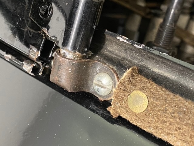

23 runabout hood rod clasp screw
Does this help, mine has a round head screw but it was redone.

You have provided me with what I was looking for in words and pictures. Many many thanks to you! Since you have no clearance issues with it, I believe that I will do the same. My clasp did not have countersinks, but I was afraid that round head screws would not fit and was considering oval head screws. Lack of countersink pretty much rules out flat head or oval in that location as being correct, though. I am very appreciative of your taking the time to make your posts.
Let's wrap this thread up.

- Posts: 7278
Re: 23 runabout hood rod clasp screw
Joe's photo raises questions for me. On wooden firewalls with the rain gutter fitted, the hood clip is riveted in place. This means the welting terminates either side of the clip, being held in place by the closest rivet. In Joe's photo the welting appears to continue on under the clip. This has the effect of raising the screw above the welting, by the thickness of the clip mounting and the height of the round head screw. I doubt this was intended. More likely the welting was terminated either side.
Others may have evidence to debunk this observation.

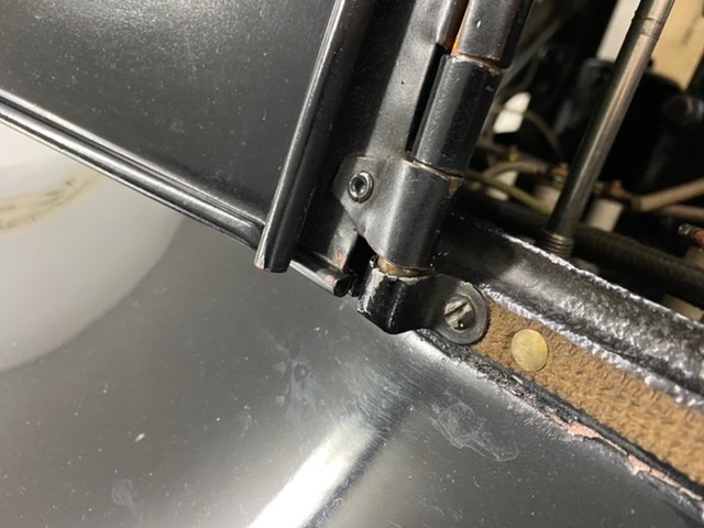

Allan might be right about the welting, my other car looks like this but both hoods seem to fit ok, everything sags with age.
