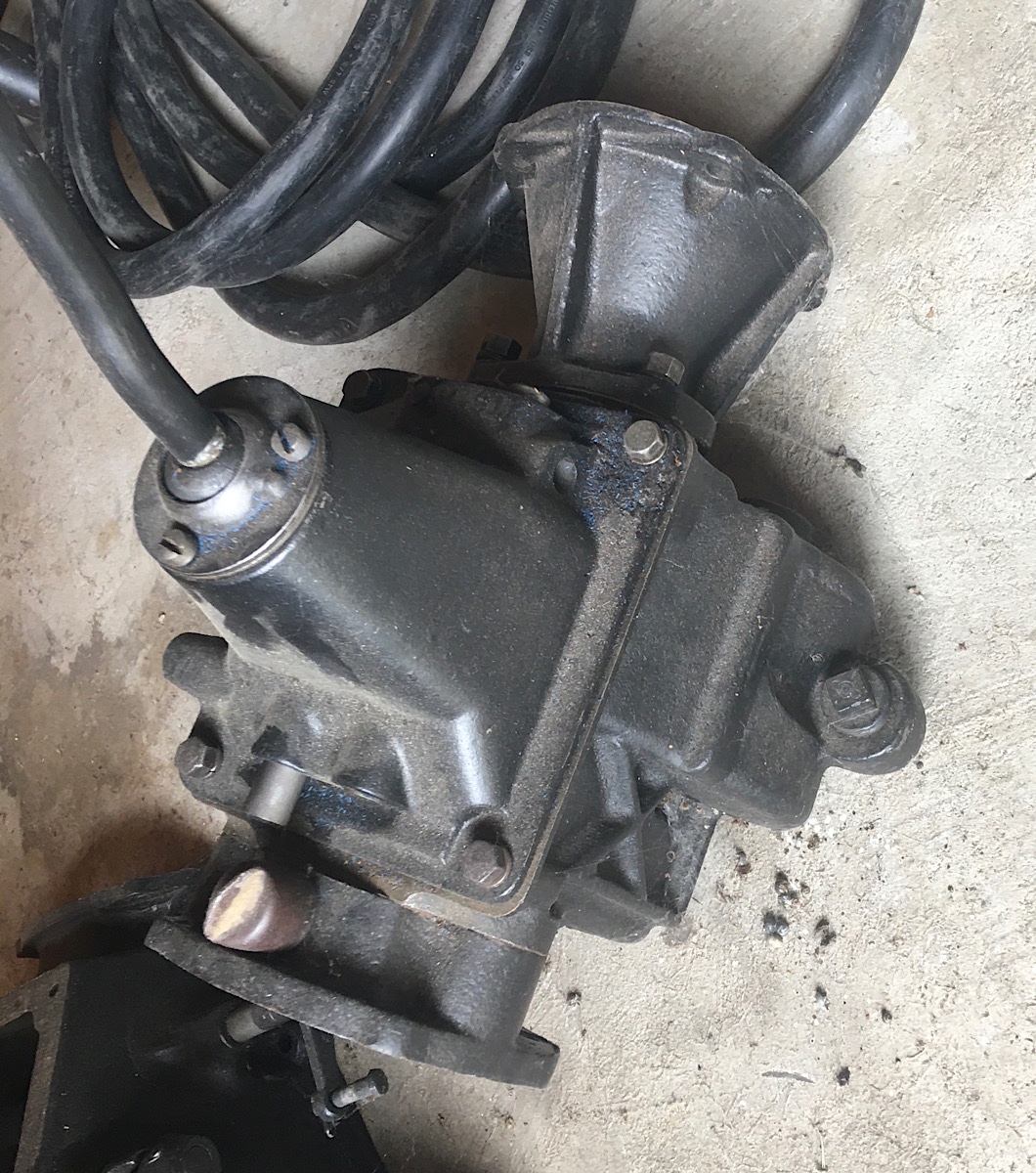

I ran a Muncie in my number 28 car for years and had a problem in keeping the gear box full of gear oil. I noticed the the the gear box seamed to pressurize and put oil out of the front and back cluster shaft. I had a buddy of mine make a couple of covers that are held on by drill and tapping the case to make end covers that are sealed. I also vented the top cover with a screw in type vent that will let the pressure excape. I have not put the trans. back into the car as of yet. I can take a picture of this trans if it would be of any help. Tom

[image][/image]Here is a picture of my trans with the seal and vent installed. I hope that my post will include the picture as I have trouble posting pictures.

One more thought on the sealing of the muncie. I think that my friend also machined the case (cluster shaft) for a seal before machining the end cap and machining the surface for the cap that helped seal the shaft.
