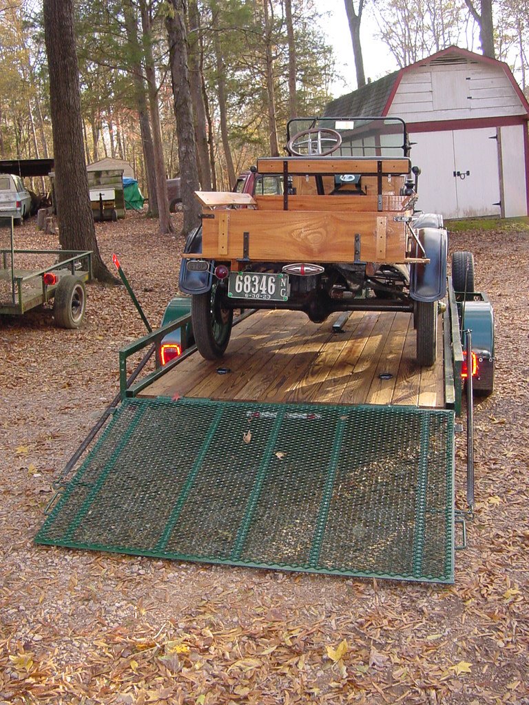

Whatever the length of the trailer,put the axle 1 inch back from center of trailer for every foot of length.
14 foot, 14 inches back from center.
This trailer pulls like a dream,hauls my T well.
I built it myself and could post some closeups if needed.
The spring assist for the gate lift,works just about 2 well,I have to hold the ramp back a bit to keep it from slamming.
tdump

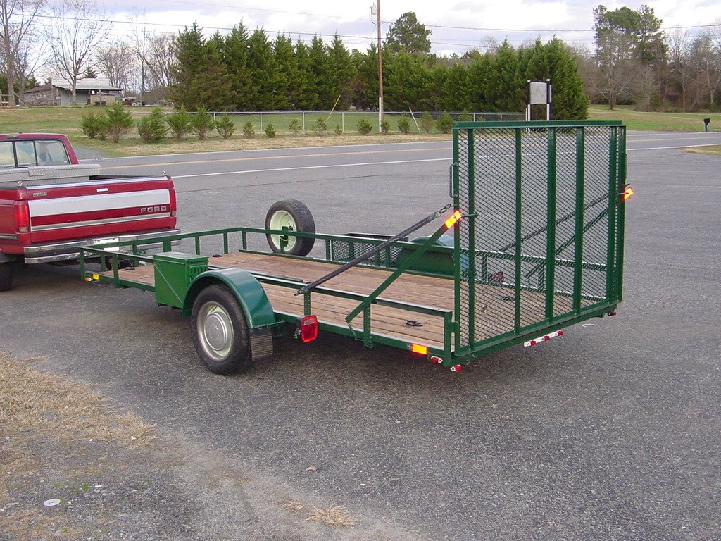

Post by tdump » Sat Jul 11, 2020 11:50 pm
couple more
The brackets that hold the ramp shut,I designed them so that a light spring holds them UP to act as guides when loading the T and also it keeps me from bending over to pick them up to latch the tailgate.
