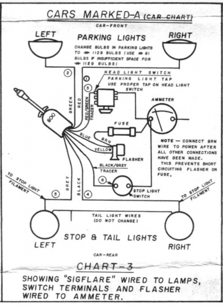

I know there are some electrical whiz kids on this forum - I've read some posts/threads exhibiting impressive electrical knowledge and would sure appreciate some sage electrical troubleshooting advice regarding a problem I'm having getting my turn signals to flash/work correctly. This could apply to any 6 volt car, so I'll try to be brief...
Installed a Signal Stat 800 turn signal switch in my '40 Ford and wired it to work additional add-on bulbs as the signal lamps in front (not the tiny park lamps), and then spliced into the stock tail lights as directed by the wiring diagram. Still 6 volt system using 6v bulbs and a Wagner #535 6v 3 prong flasher. The front bulbs are 6v #209. Brake lights work as they should. I have wired it according to the factory diagram (see below) and have it connected to a "hot all the time" power source. The system works, sort of, but the interval between the pulses is VERY short and the flash rate is VERY rapid - almost quadruple the speed of normal flashers. Consequently, the lamps are not very bright since they are flashing so fast. It's very difficult to see them working in the daytime. Am I missing something somewhere? Is there something in the circuit to check that might be causing high resistance or...? There are no dumb questions at this point. I'm completely stumped!

Some flashers flash rapidly when they are not loaded enough, this is so you can tell that a bulb is burned out. The 209 bulb you are using has a lower CP rating than the 1129 bulb specified in the drawing.
It might just be that the flasher is working like it is supposed to, but not how you want it to work.
Try adding another bulb to the circuit, just to see if it will flash the correct speed with 3 bulbs connected, instead of 2, That will tell you if I'm right...or not.

I agree with Squirrel. The hot-wire flashers have to have a certain current to work.
(By the way, I and others have discovered the hard way that modern solid-state flasher units that are not load dependent, and work with LEDs do NOT, repeat NOT, like the Model T environment.
All is fine.....until you start the engine!)
Probably the trembler coils' RF emissions, but could be dirty DC off the generator.

Are you trying to use your turn signal system on BATTERY or MAGNETO?
Most turn signal flashers are designed for DC only and while running on magneto, you have "AC" current, more or less. So, does your system work better when using just the battery?
As was stated above, flasher units work on heating the breaker element. An amp meter at the flasher will tell you what amperage you are drawing when using different functions of your turn signal system. Keep in mind, 6 volt systems do not have the same illumination output as more modern 12 volt systems. Measure the amperage and compare to the specs. of the flasher unit you are using. This should tell you if you're drawing too much or too little amperage to operate the flasher unit properly.
Lastly, does you controller have a 4-way flashing mode? If it is from the 1940 era, it probably does not. If it does, do the lights act the same on 4-way as they do in regular operation? This could tell you if you have an over or under current problem. FAST flashing in older systems is often a sign of OVER current draw. You may have to find another flasher with a higher current rating.

I had the same problem.
I purchased an electronic 6 volt flasher for a motorcycle and now the turn signals work as they should.

I had issues with the modern flasher doing the too fast flash using standard 6 volt turn signal bulbs (1158's I think). Swapped it out for old stock flasher solved my problems. You can find them on eBay.

That flasher works by current heating a metal strip that flips open to interrupt the current and turn the lights off momentarily.
A 4 way flasher needing extra current would probably work normally.
They make an electronic 12 volt flasher that will et you add extra lights, like towing a trailer will add lights that will still flash at the same rate.
I'm not sure if 6 volt electronic flashers are available.

As Squirrel said, you are probably not drawing enough amperage with the small front bulbs. A 535 is a thermal flasher meaning that it has a bi-metal spring that curls as it heats and pulls away from the contact. The interval between flashes is determined by the time it takes the spring to cool and straighten out. Not enough load means a short cooling period and a quick flash. That is why there is a fast flash when a bulb is out. A quick look on the web shows that various 535 flashers are rated up to 5 amps, or 32 candle power, or up to 4 bulbs, or 50 watts. You said you spliced into the tail lights, probably meant stop lights, as you said it was according to the diagram, but double check since the stop light filament draws higher current. Also make sure that the stop light switch now goes through the turn signal switch and not directly to the lights as it originally did.
Also, if you are still positive ground, make sure that you are switching negative wires, and not running positive current through the switch. I also seem to recall a discussion many years ago about using these turn signal switches on positive ground cars (Model A.) If I remember correctly, there was a problem with the pilot light (the one on the switch that indicates the flashing.) Since the modern switches are made for negative ground but now attached to a positive grounded steering column, the pilot bulb was causing a problem when switched on. When a single pilot is used for both directions, it gets its ground through the filament of the front bulb that is not flashing. I think the solution was to leave the pilot bulb out.

I just wired up a stock Model A - 6 volt, positive ground with a Signal Stat 900 w/pilot light. I installed all LED lamps with the both rears having a inline resistors - all worked good AFTER I removed the switch & ground the thick paint off the column, including the pilot lamp. I used the flasher that came in the kit.

I bought one of the 7 wire kits from the vendors a few years ago and had the same issue with flashing way too fast. It was the proper 6 volt flasher with 6 Volt bulbs. The flasher was defective out of the box. Replaced it and all is well.

Those lights stay on until the current heats a strip of metal in that little can.
The metal is two different types fused together, so it bends when heated, due to a different coefficient of expansion for the two metal types.
The switch points go through that strip, so when it gets hot and bends, the circuit is open and the lights go out.
The greater the current draw the faster this happens.
There is a similar 4-way flasher can that would leave the lights on longer, but I don't recall the number.
