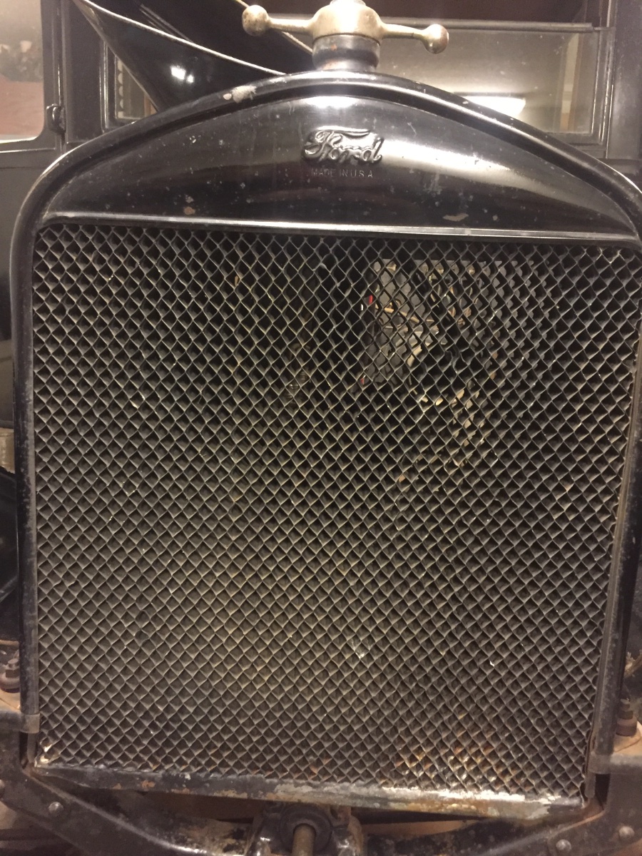

Honeycomb is aftermarket, not Ford.

Originals had round tubes. A lot of aftermarket radiators have flat tubes and cool better, although round tube radiators are available for those who prefer them.

Horizontal slat.

If that radiator is relatively clean inside and does not leak, do not even think about changing it out to the original Ford type. Honeycomb radiators are excellent performers and cool very efficiently. Yours looks to be in great shape.
Re: Radiators
There certainly were a lot of different cellular radiators offered as replacements. I think a lot could be said about the merits of each.

Just a little additional info that is often unknown or overlooked: In 1926 & 1927 there were additional variations in radiators. Some Ford radiators were flat tube, and some had no reinforcing bar.
