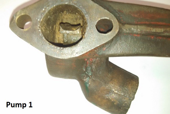

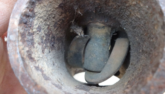

- Posts: 6544
Re: Evans Coolant
That's a good question. But the Model T cooling system design is entirely different than that of used in modern cars. I have also wondered if anyone measured the increase in water flow as a result of a water pump in conjunction with the thermosiphon method on a Model T. I have had several different Model T water pumps, some with paddle impellers others with propellers. The designs don't look like they would do much to speed up the flow of the coolant and the only drag on the engine might be do to improper shaft lubrication. Having said that, the thermosiphon method requires the coolant to get hot in order for the coolant to flow. So on starting a cold engine the pump may have some effect but once the thermosiphon action starts then what? I have included a few pictures of the impellers - you be the judge.
- Attachments
- Pump 3 (7).jpg (26.91 KiB) Viewed 9769 times
- Pump 4 (5).jpg (27.03 KiB) Viewed 9769 times
