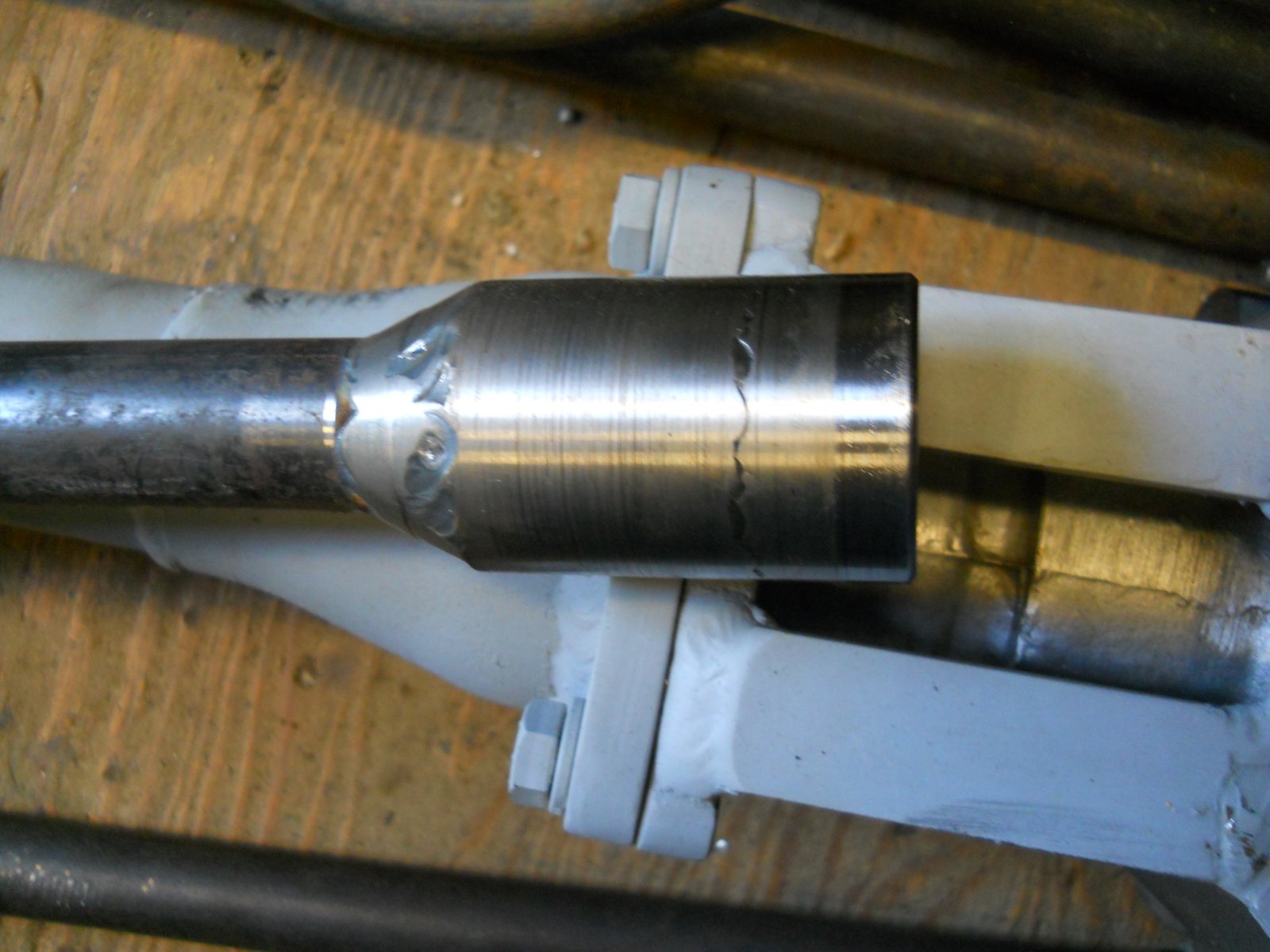

I am rebuilding a rear end that will have a Volvo overdrive installed. Great except, the person that started the project is not in the picture. Tim bought this setup that was going to be use with extended frame, but his plans are to use with 26/27 coupe body and keep stock length. As it is now it's too long. Does any one know who may have made this? I email Kevin P and he does not know. If I can't find out who then I am going to fit the housings together and hope to take some off the front and hope I can get everything to line up. This is going behind a pretty hot T engine with disk brakes and safety hubs. The bottom photo gives and idea how much needs to come off to make work as we need it.

Mark, I can almost guarantee you that welded drive shaft will fail, if not sooner, then later. Not a good idea. Why not use a period three speed auxiliary transmission or a Layne Warford? I think you are going to open a big can of worms with that setup.
JMHO Dave

I know this was mentioned above, but that is a terrible weld. If you use this it needs to be redone.

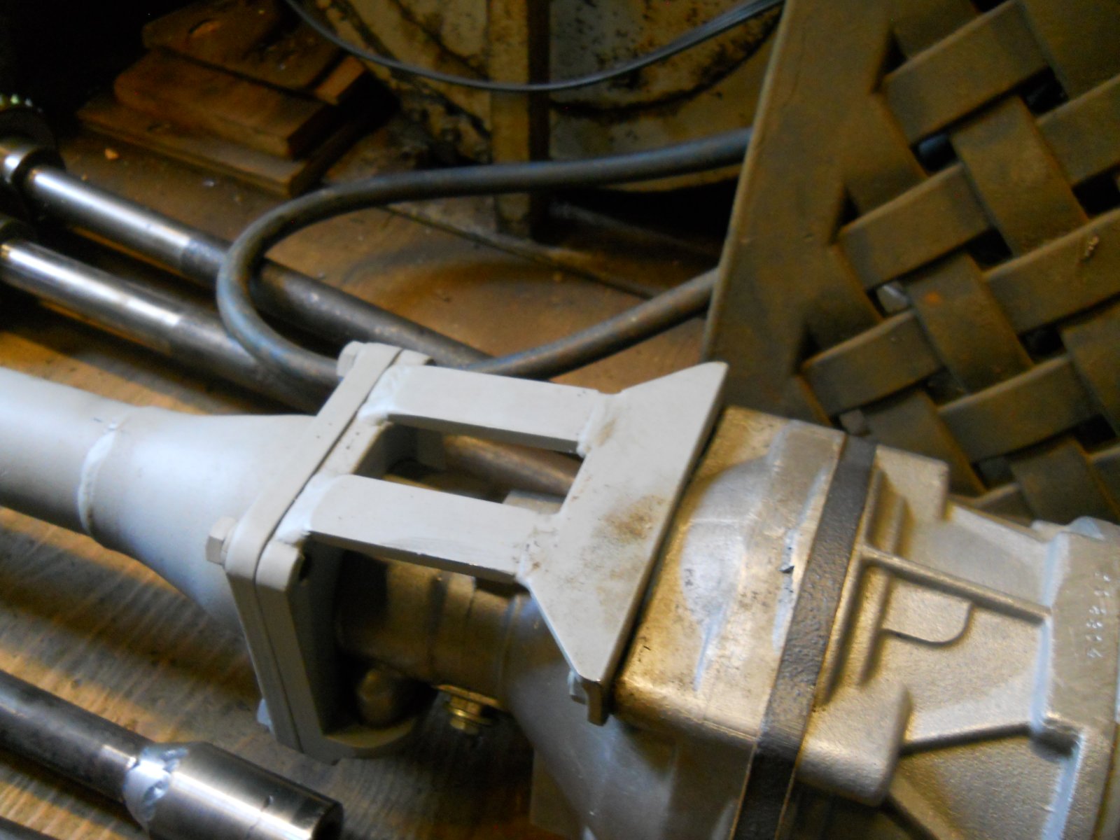

My sense of aesthetics is offended by the cobbled together look of the welded up bracketry required to mount that thing. It looks pig ugly to me.
I would much rather a KC Warford, not only because it looks like it 'belongs', but it offers far more in practical usage. I have no idea of the cost comparison though.

Mark; I'll drop this after this last comment..... as a certified welder there is no way in hell I'd accept that weld; it doesn't even have adequate (meaning full) reinforcement, which is one of the fundamental basics of welding. No quality professional welder would ever accept or provide a weld like that, but many shade tree welders would. It's your car and driveline. Hopefully you have adequate external brakes; I've experienced a broken drive line (split pinion, same result). It's not fun.

What I'm most concerned about, besides the bad idea of welding on a driveshaft in the first place, is a total lack of a radius on the weld on the shaft. The weld craters are even worse, the whole thing screams STRESS CRACK just waiting to happen. Myself, I wouldn't use that in a stock T, let alone a hot one. JMHO, YMMV. Dave
