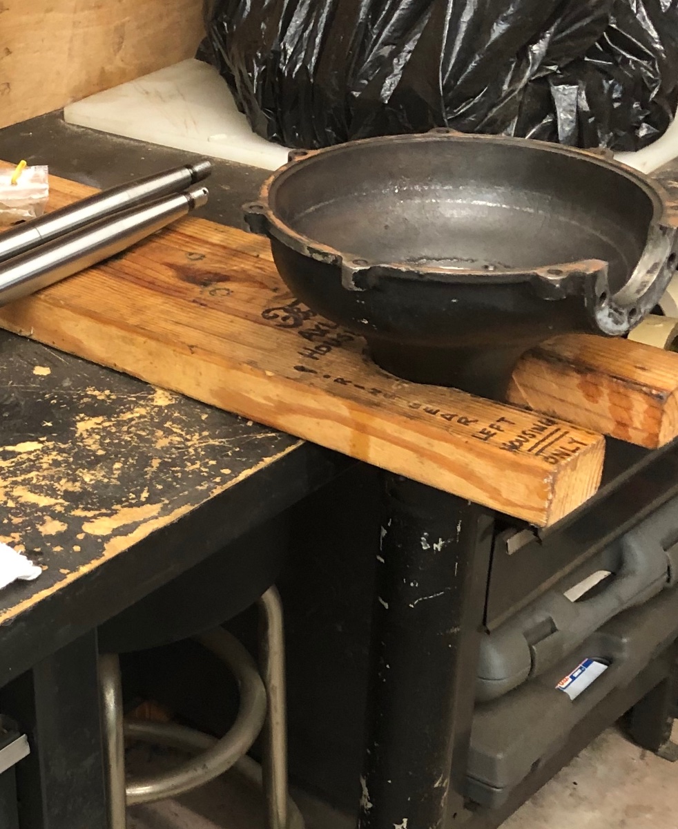

The hole in mine is 6 1/4 inches in diameter. I made mine out of a scrap 2x10 I had laying around.
- Posts: 4045
Re: Bench Top Rear Axle Holder
Bevel that hole some, fits snug that way. Put a reminder note on mine

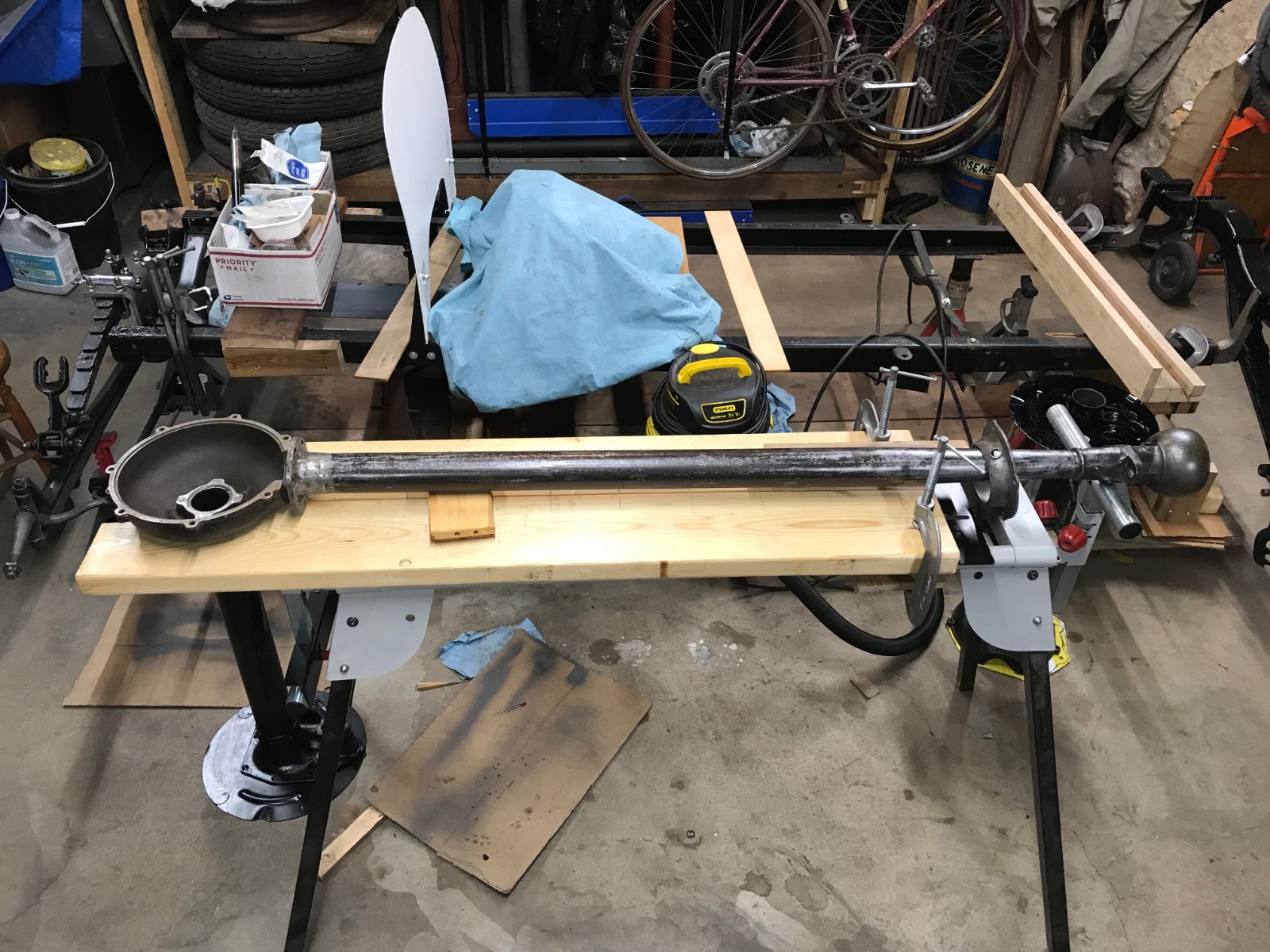

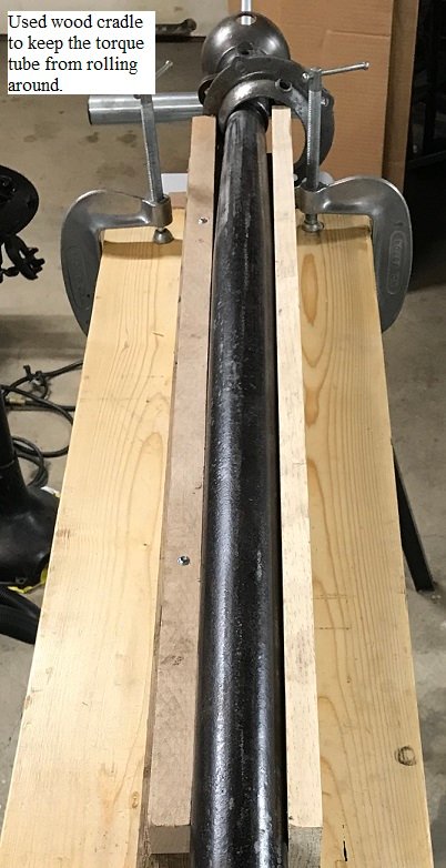

I set mine up on my power miter box stand. That way I could move take it down and store it when done.
Made a cradle to keep the torque tube from moving around
